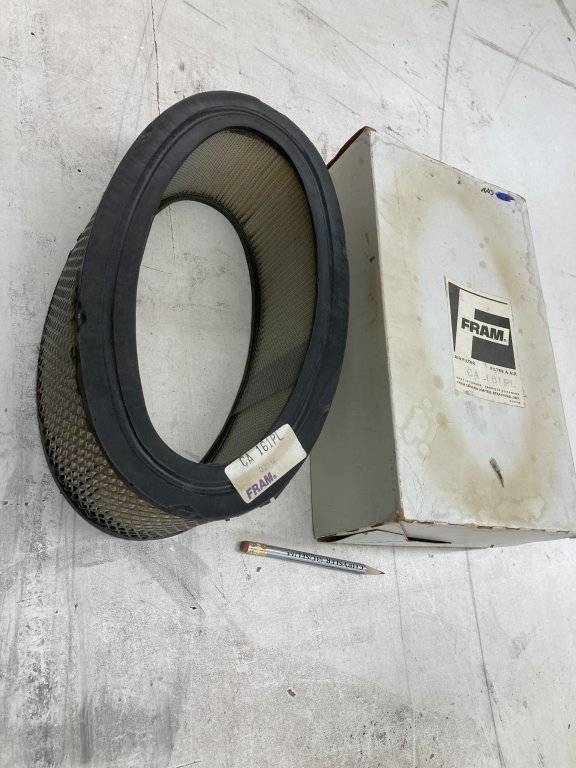

I would check with the Boys at the Chrysler 300 club ....the ca161pl fits the "Canted" silenced air cleaner found on the single four barrel New Yorkers etc. 57 to 58 . The thinner ones are CA163pl ... I picked up a set of those for my '58 Fury from a 300 club member in Chicago.

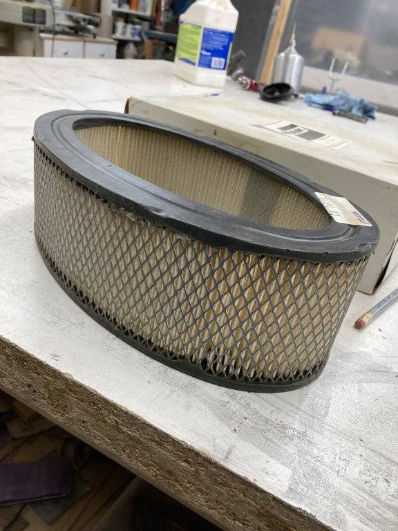

I found a filter from a different car that fits quite nicely but you need to form it a bit.
But it fits quite nicely and seems to hold it shape.
I've never used them, though, so if they choke the airflow I cannot say.
I'll need to do some digging to find what height it is, and part#.
Thanks for the feedback. I actually just scored 4 or the correct filters.
Thanks for your research.
