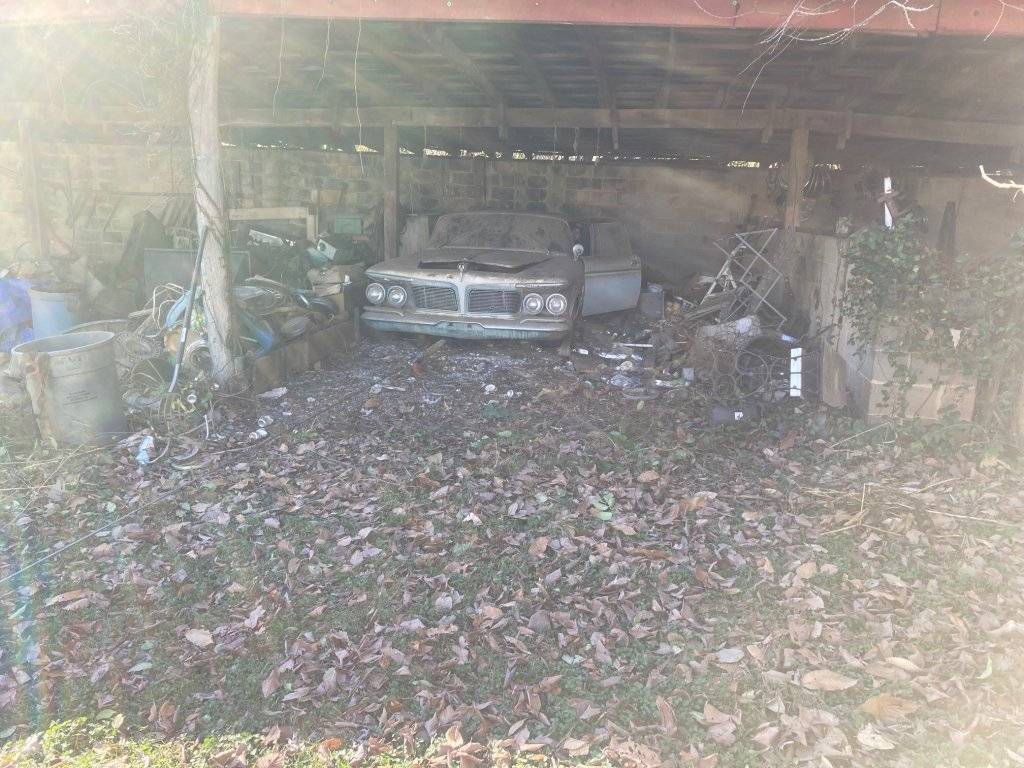

My son's father in law passed a few weeks ago. He was the owner of a small local used car lot for over 30 years. While in town dealing with the associated issues, his mother in law took him out to the storage building behind the house to look at the old "Chrysler" she wanted him to have!
He bought the car at auction in 1979 and sold it to a customer who couldn't make the payments so he repo'd the car and parked it in the building in 1980.
I guess we could call this a true barn find. My son says it has so much grime on it he can't tell what color it is. He thinks white or silver?

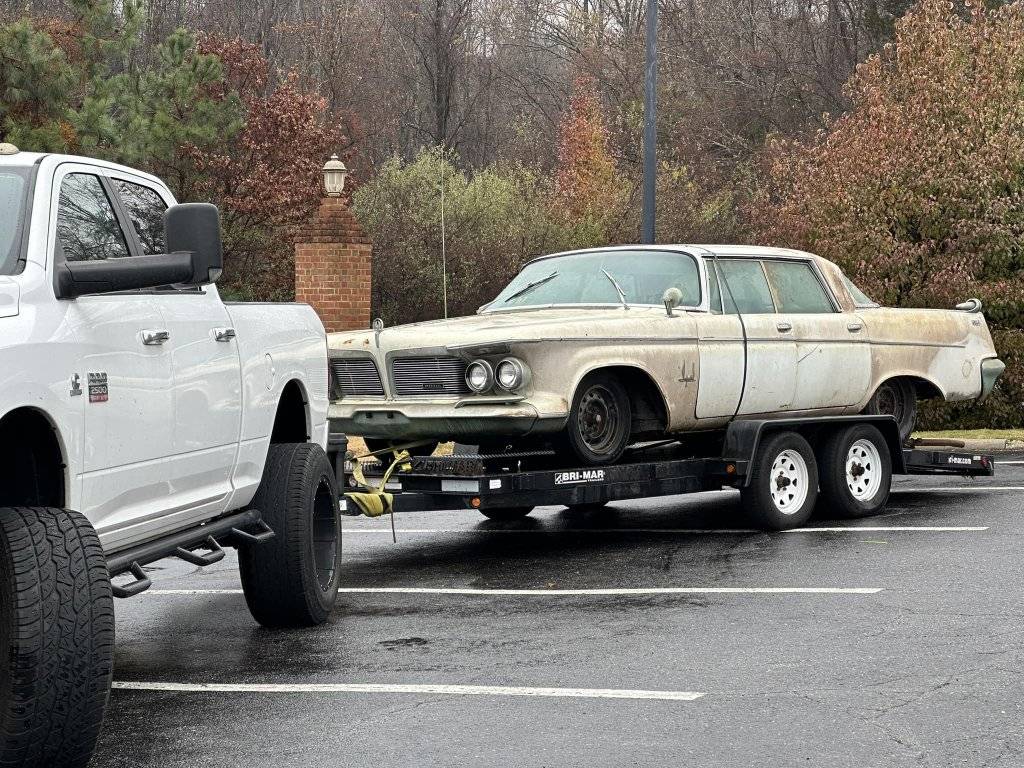

Well my son and his family came up from SC last week for the holiday and he came with the car trailer in tow. We spent a long day on Saturday dealing with a myriad of car trash piled in the way, four completely rotted tires, and some groundhog dens that undercut the area where it was stored but we managed to get it loaded up and the trip to SC was fairly smooth. Special thanks to Ron's used tires in Winchester, VA!
She's very dirty but overall in pretty good shape! The headliner is shot, none of the door handles work (and BTW his father now owes him a driver's inside door handle if anyone knows where to find one), the air cleaner is missing. Happy to report NO major body rust.
