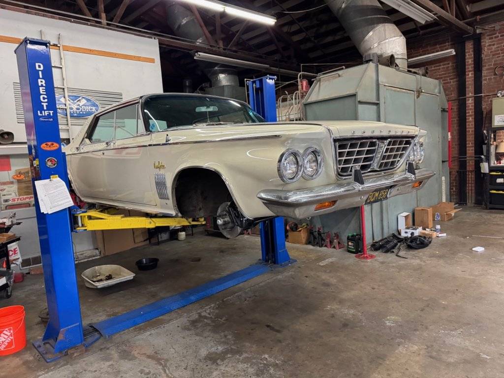

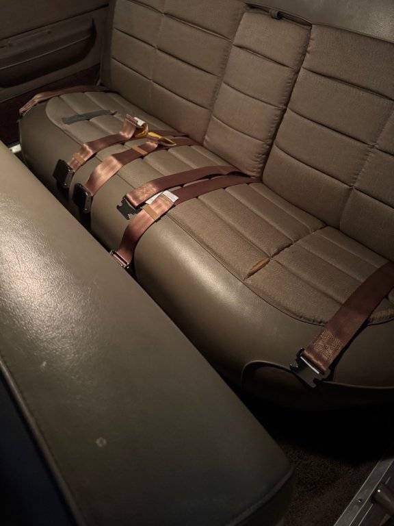

Since the car would be transporting the family, wanted to take care of some safety items which would include improved braking and adding seat belts to the rear seat.

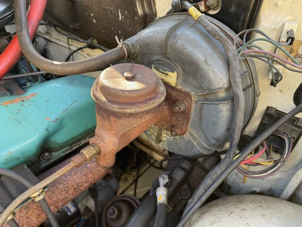

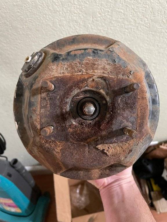

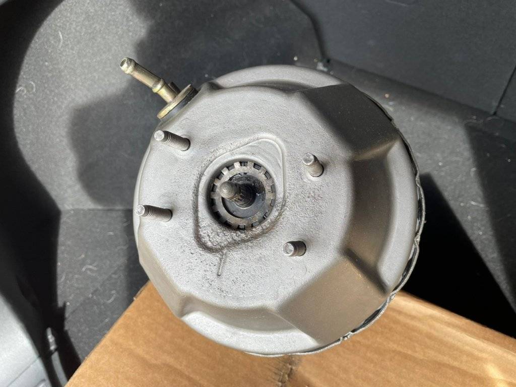

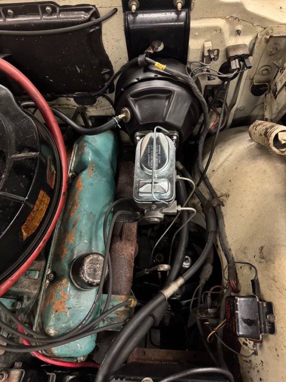

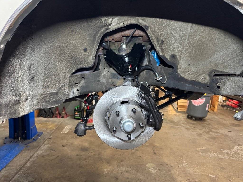

The brake booster was shot, so in reality I had manual brakes. Goal was to upgrade to discs up front, so wanted to move from the single diaphragm booster it had to a dual diaphragm booster and found out the booster from a 64 Imperial was dual diaphragm and was a direct bolt in.
Found one at Turner's wrecking yard in Fresno, California and had it shipped up to me and then rebuilt at Power Brake Exchange in San Jose, California.

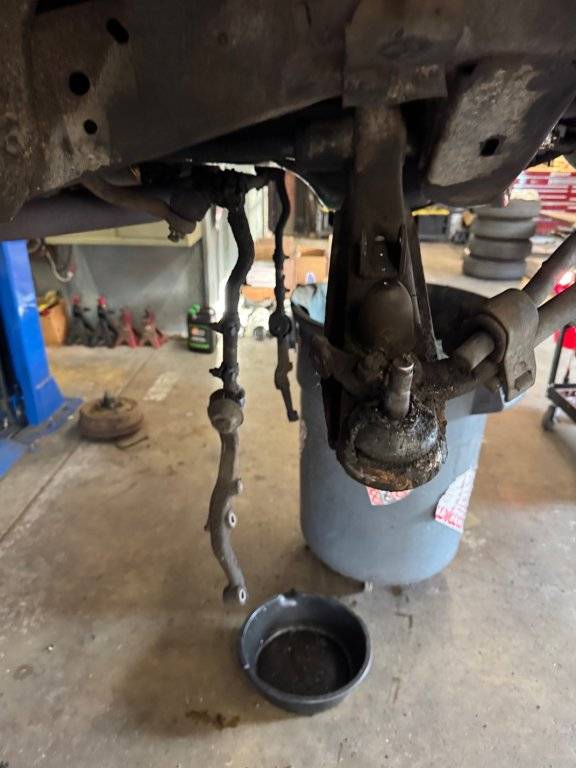

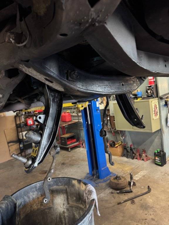

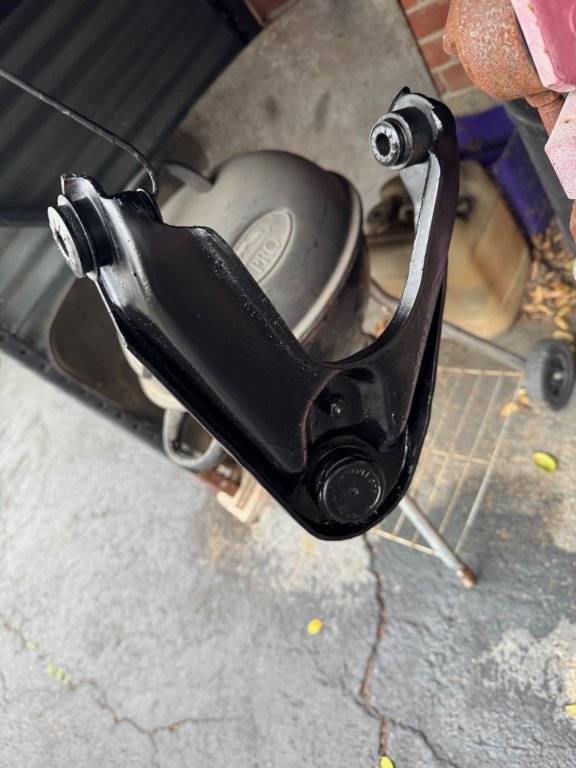

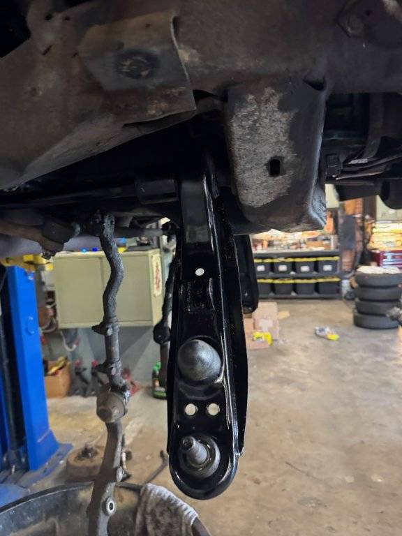

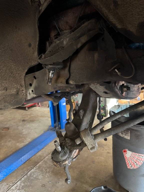

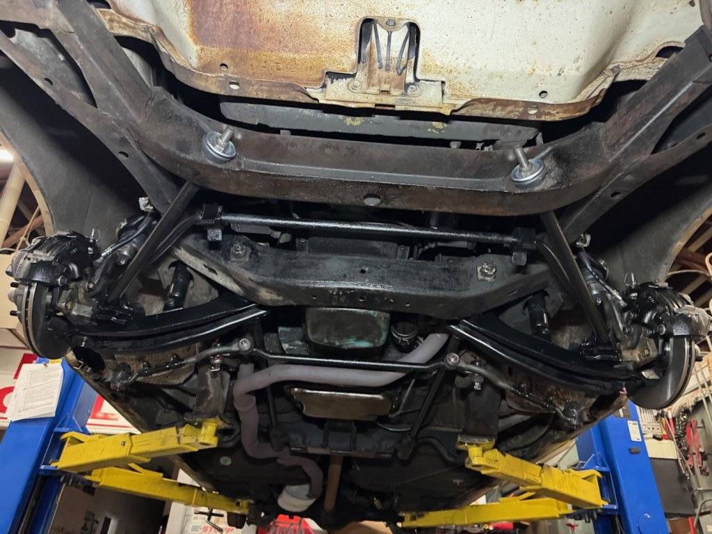

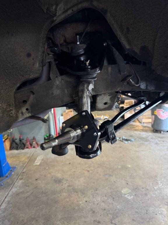

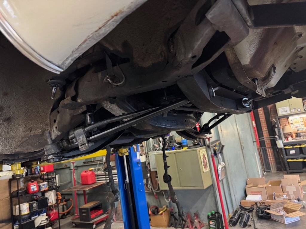

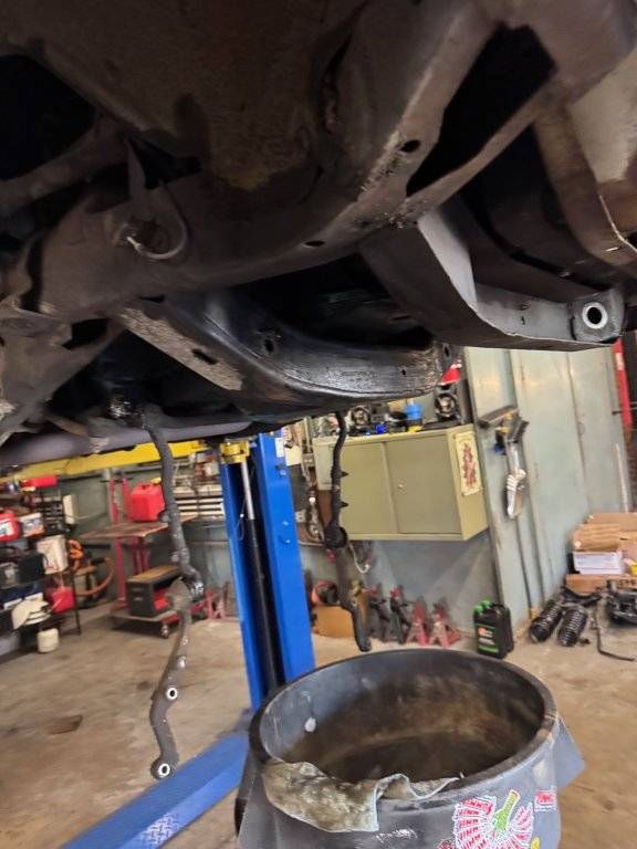

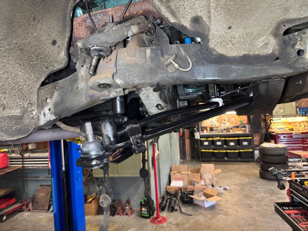

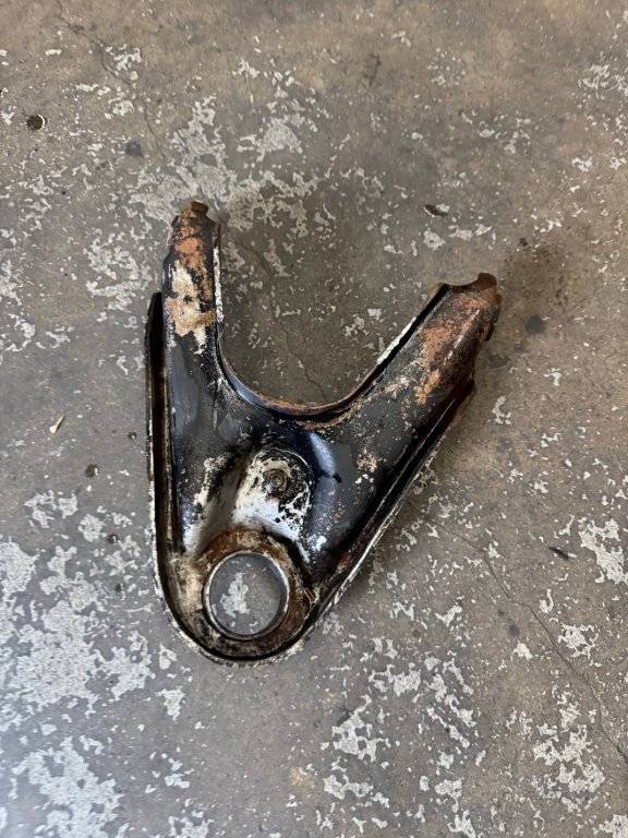

I had the front suspension completely rebuilt with parts sourced from Craig @mobileparts
I know that SSBC doesn't have a lot of fans here, but I went with their front disc brake upgrade kit as it was the best that I could find for this application and wanted to move away from the single reservoir master cylinder.

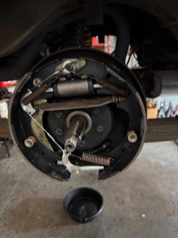

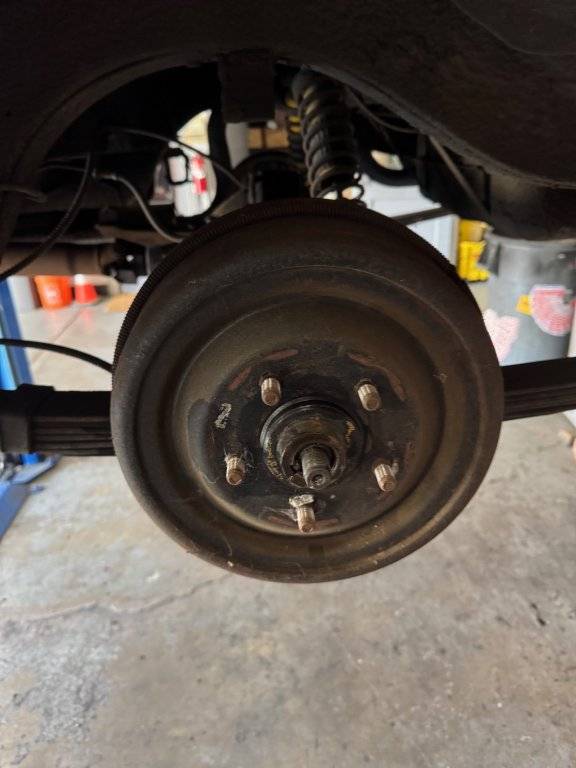

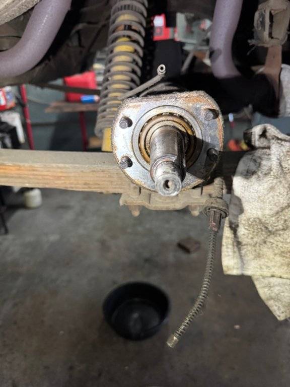

Also had the rear drums fully rebuilt along with getting the drums detatched from the hubs.

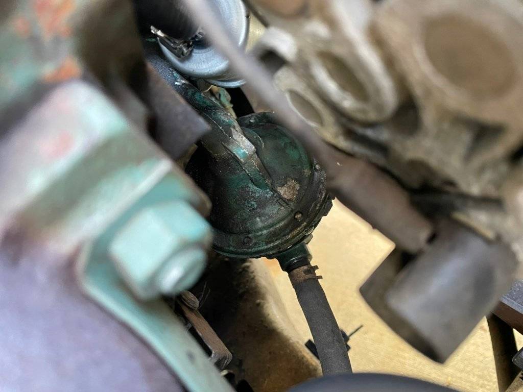

Ran into an issues where the fuel pump was squirting out fuel at the seam on the arm, and I'm assuming was leaking internally as well, so replaced the pump and another oil and filter change.

Did you pack those rear wheel bearings in grease? They don't run in the gear oil.

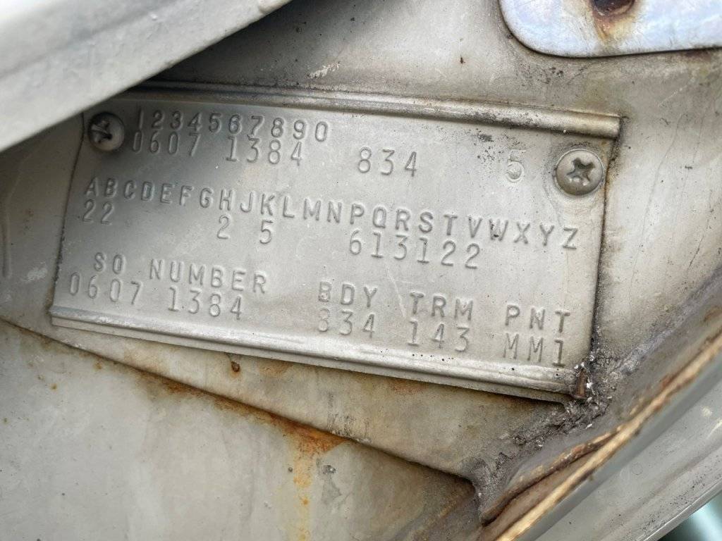

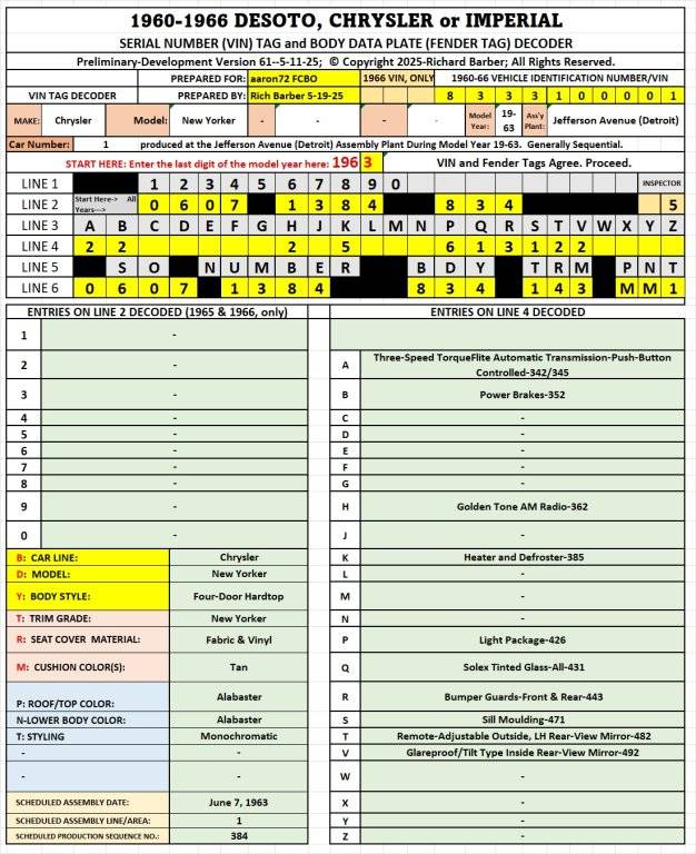

Hi, Aaron. Beautiful car. Thanks for posting the great pix, including the fender tag. I took the liberty of preparing a decode report for the car. I hope it matches reality. N/C, ever. My decoder needed the exercise. Note that drivetrain, suspension and engine options are not shown on 1963 tags. You might find a Production Broadcast Sheet hidden underneath the rear seat springs (upper and lower). The sample below may not be the same format as for a Chrysler, but they tell almost everything about the car and are worth looking for.
