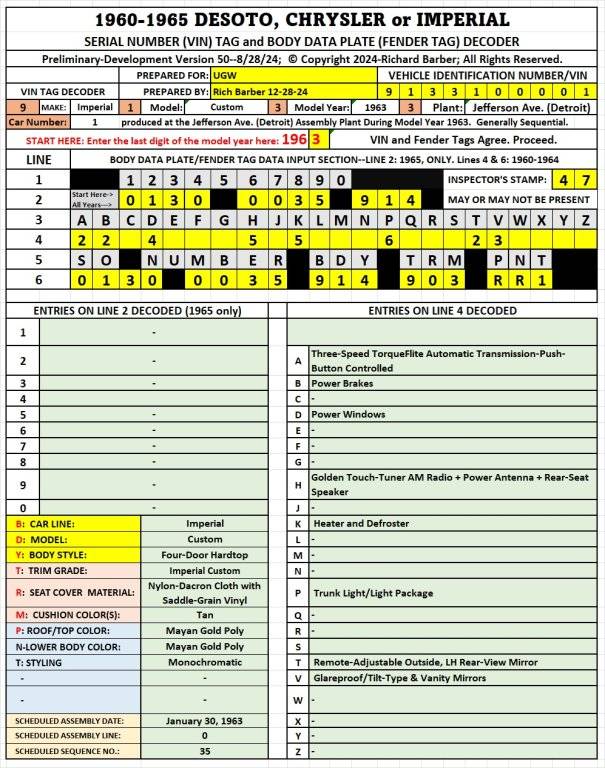

I have prepared the attached decode report for the VIN & Fender Tags of your car, but I had to guess at much of the data. I can easily rerun it if you would advice the actual VIN & bottom line of the Fender tag. Photos of both would be best, but I can work from a transcription with spaces. I have concluded that P6 specifically stands for the code for the trunk light (426) and realistically it triggers installation of the entire light package--trunk, park brake warning, glove box, back door light switches in a 4-door and the map light. I have a reference that says V3 includes a tilt-type inside rear view mirror plus a vanity mirror. I've never seen a vanity mirror and assume it is just a clip-on mirror but could be built into the passenger side sun visor. The RHS rear view mirror was often added by a dealer but had a 491 order code from the factory. Any additional observations on the mirrors would be great. Merry Christmas for another hour here.

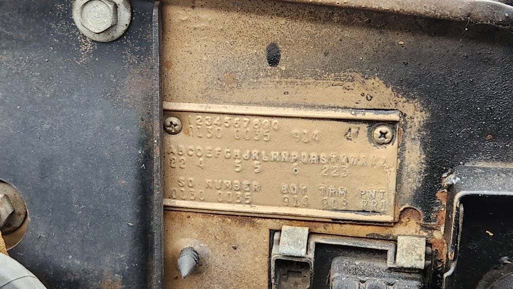

Here's my trim tag. It's probably silly, but I'd rather not post my vin. The tag says it should be painted Mayan Gold, which it is, and some kind of cream colored interior, which also matches.

Thanks for posting the tag. I can guess the important first four digits of the VIN. TRM was a little hard to read but code 903 in Tan makes sense. 909 in Gold was also a possibility. Happy New Year.

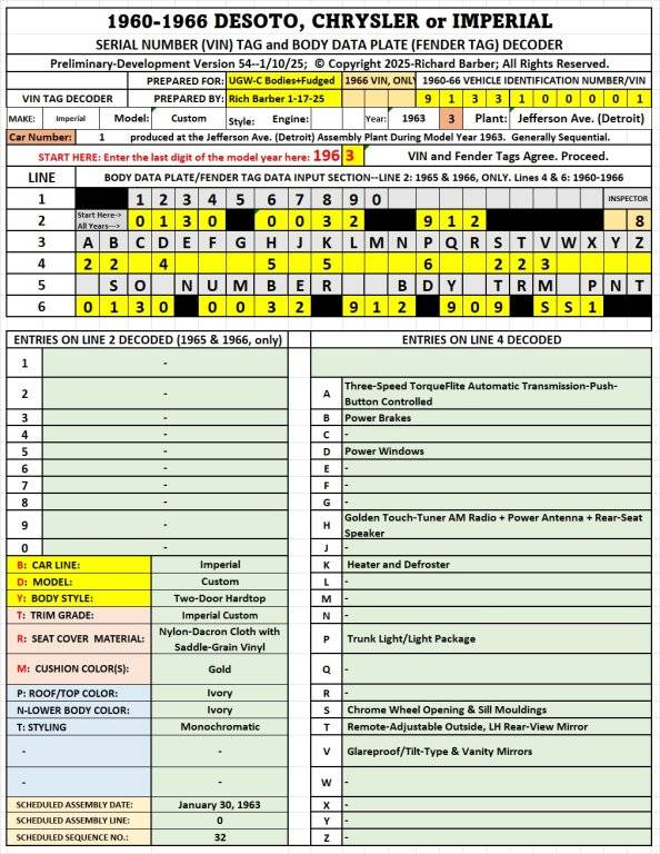

I am developing and testing a 1960-1966 Chrysler Imperial combo VIN & fender tag decoder and I need to test it from time to time. So, I plugged in the data you posted here and fudged in some other to enable preparing a complete report. I can easily re-run it if you wish--with actual VIN and bottom line data. Thanks for posting and for any corrections. My info has slightly different results for inside mirrors, side trim and the light package. P6 actually stands for trunk light but is an indicator for the complete light package including glove box, parking brake warning light, map light and whatever other interior lights come on an Imp. Review & evaluation welcomed. Happy New Year
