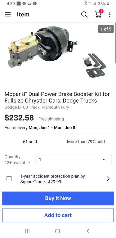

    I'm looking to upgrade my booster and single master cylinder while I'm changing out my steering gear. This claims to fit my 4 wheel Drum set-up.
    Does anyone have any advice on the matter? Is this just a straight bolt on with nothing else needed? As always, thanks guys! Screenshot_20200522-163917_eBay.jpg

    It will not naturally fit. I've tried a similar setup in the past, so trust me on this. I bought one similar to the one you're looking at and the arm on the back of the one you're thinking about is different than ours. Mine is a pushrod into the brakelight switch. The one you posted above is a bolt-on. You will also need to do some fabrication on the firewall and booster backing plate as the holes do not naturally mate.
    Honestly my advice would be to either have the brake booster redone by Booster Dewy (if it's in bad shape). If it works, leave it and do what I did, upgrade the front brakes to discs and swap out the master cylinder for a dual master cylinder. Much easier.
    Be aware, others will point out your current brake booster is for power drums, NOT disc brakes and they are correct. Disc brakes use a different booster. The problem is that those boosters are hard to come by in my experience. Our 64's are a rare breed since they are technically not C bodies and while the appropriate disc booster from an actual C body is desired, it may not fit our model naturally.
    My setup has worked for me. If you purchase what you're looking at above, it will be a colossal pain in the ass to install and is not a natural swap. Fabrication will be required.

    You would also want to check the spec sheet on the after market booster as a lot of those kits are designed to upgrade from manual brakes. They do no play well with a car that was set up with power brakes as the pedal pivot points are different and things do not mate up. I would rebuild the current booster and do the dual pot master cylinder conversion and let it go at that as noted above. The after market conversion booster is an 8" booster and most of the C-Bodies used a 9" booster so you are not going to gain a lot over what you have by doing the conversion.

    That is NOT NOT a 4 wheel drum brake master cylinder, for starters....
    Notice the chambers are NOT the same --- that is a Front Disc / Rear Drum master Cylinder --- and the power brake booster is some garbage Universal something.....
    Clearly, NOT what you want........

    The Chrysler name is misspelled in the ad. That alone would scare me off. There is no "t" in Chrysler. :confused:

    The pictured booster, plus the "dual" notation, would be a dual-diaphragm booster, which would be for power disc brakes.
    Changing the lines and m/cyl to a '67 C-body item would be the easiest way out. The "balance block" probably refers to the block that triggers the "BRAKE" light when one axle-set of brakes might lose pressure? Not sure how to wire that in on your car, IF that's all it does.
