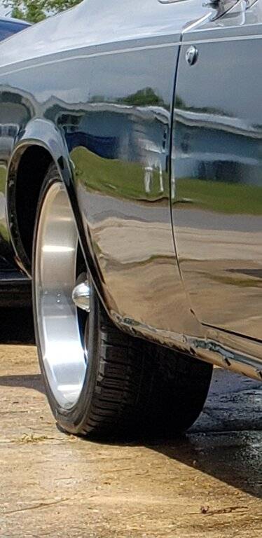

So, Im thinking this is going to be the biggest problem to tackle on my 300k. I purchased this car with a great 2-tone paint job and for the most part the body is in great shape. HOWEVER, a lot of rust bubbles are forming under the paint on the rocker panels. I'm assuming the previous owner did not do the proper body work under this paint job.
Now, whats my options as far as fixing this issue? I tried looking for direct replacement rockers online but could not find any for this car. Unfortunately a donor car to cut from is probably out of the question(A. way to hard to find and B. Id have no where to store a whole parts car)
Universal panels? Other models that would fit the 2dr 300k(120" wheel base)? Patch work(Im not very knowledgeable on rust repair).
As always thanks guys! Will post pictures later

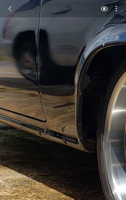

Here's the passenger side, you can see the bubbles
