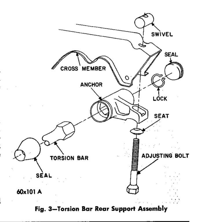

Everywhere I've looked all mopars torsion bar adjustment bolts are located at the front on the car on the Lower control arm. However on my 300k the adjustment bolt is located to the rear of the torsion bar about below the front seats much like a Silverados suspension. Has anyone seen this before on an old mopar??
Btw I'm looking for some larger diameter bars and would like to know if any 41" mopar bars would work. Any help would be great!

Yep, that's the way the older torsion bar adjustment is in the big cars. I think they changed it in 1965 to the same style that the B-bodies had, but I could be wrong.

Hi! I see this old thread, i have a Chrysler 300 non letter series 1964 and the torsion adjustment is on the rear cross member(see picture). I wondering if you have been able to find parts for this? Im thinking the torsion bar itself and maybe you sometime going to need the adjusting bolt or the swiwel if the threads strips or something. Anyway parts seems to be hard to find, greatful for some tip where to find!
Unless a torsion bar breaks, for some odd reason, they shouldn't ever need replacing. PST has a bunch not sure about your model though.
I have found the adjusting bolts, seats and swivels on ebay. Torsion bars will probably have to come off parts car.
