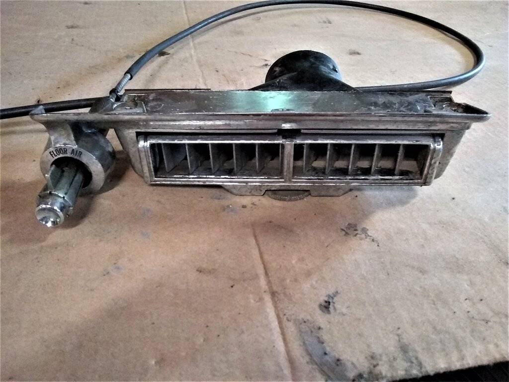

Hey I'm going to add ac to my 64 imperial. It currently only has the heat options. I want to make it period correct and I'm looking for what is the center under dash vents. I bought the passenger side vent and about to buy the drivers. I noticed it has a switch with a wire that says floor air. Does anyone have any photos or know what was connected to the "floor air" switch?
The "Floor Air" switch is just a duct diverter and is a very minor component in the overall factory a/c installation. This is a major project and, in my judgment, completely impossible unless you have an a/c equipped parts car. And then it would to require a major swap job including disassembly of the dash and the components on the engine side of the firewall. If you really need a/c, adding an aftermarket underdash unit with a Sanden compressor would be the most sensible thing to do.

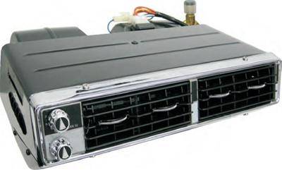

However, if you're looking for a period look, many cars were given AC retrofits back in the day with underdash hanging AC systems that were added after the fact, leaving the original non-AC system in place and functional. Mark IV was a popular under dash AC add on that is still being manufactured today, available from many vendors, and can be used with modern brand new compressors and condensors etc.

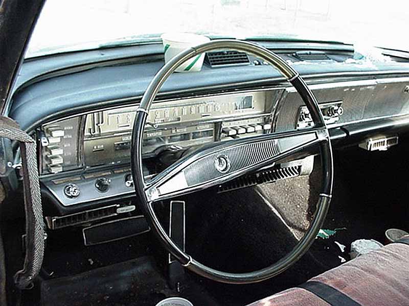

If you really want to stay Mopar, well, Mopar had an enormous one made by their AirTemp division which was very effective and looked like this:
They're out there - I just gave the one in the pictures away to FCBO member @cbarge !!

Yes definitely going to do the underdash system for now! The odds of finding a car with the setup will take time! That might be a future project for me, but for now definitely like a Mark system! Thank you for your advice!

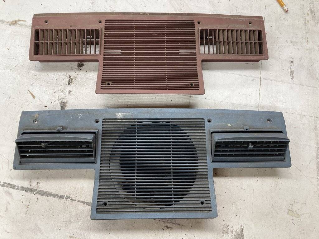

@Ross Wooldridge I beg to differ on the dash and dash pad being different. The red grille is non ac and the blue is ac.
Interesting, @detmatt - thanks for setting me straight. I must admit I am nowhere near as familiar with the 64 to 66 Imperials as I am with 65 66 C bodies. I was doing some surmising based on my knowledge of C bodies.
This give hope for @64Imperial 's quest for a factory look - perhaps the dash frames and pads aren't so different, and all he needs is some creative ductwork from a modern AC & heat box tucked under the dash.
