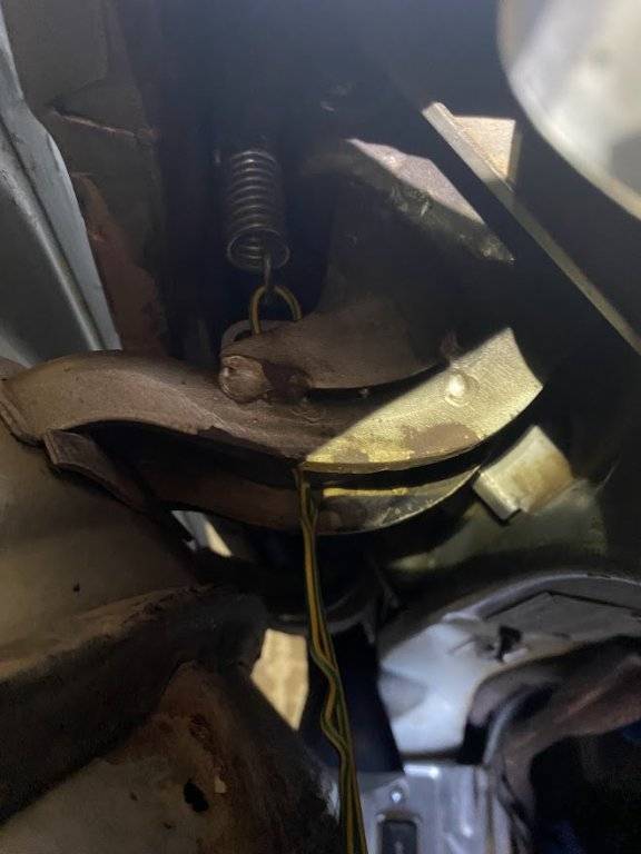

Next question. I tried for an hour to get the spring on. Is there a way of doing it without taking the henge off? Trying to keep from disassembling as much as possible since the car has never been apart and the doors don't sag and are just as solid as the day she left the assembly line.
You could try stretching the spring and installing washers in the coils. I made a Hook from a good metal coat hanger and used Visegrips as a handle. There is a "sweet spot" on the hinge when the door is partially opened. It is a Big pain and you need patience. Walk away for some time or overnight and try again. Once you hook the spring and grease everything It will all be worth it. The IML has Very good directions
Thanks for the info. Wouldn't of thought about putting washers to stretch it out.
I’ve had a couple original rebuilt kits in my shop since the ‘70s when I bought them from the local Imperial dealer (they even had the rear heater blowers for my Ghia-Imperial!) but maybe the modern reproduction kits will last longer. Even on 4-door models the doors are heavy!

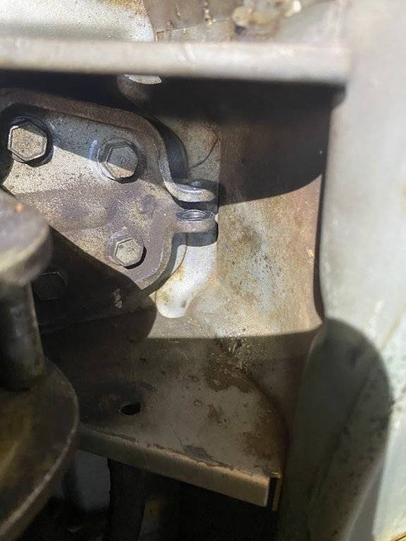

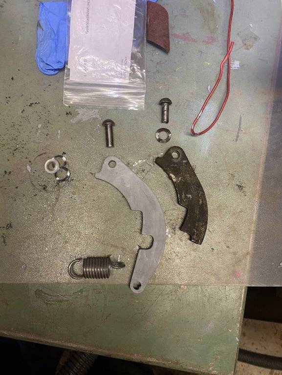

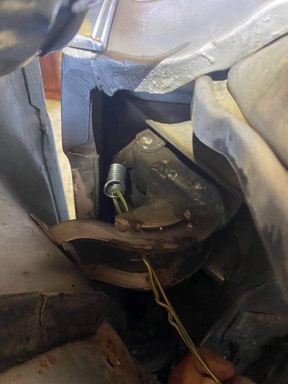

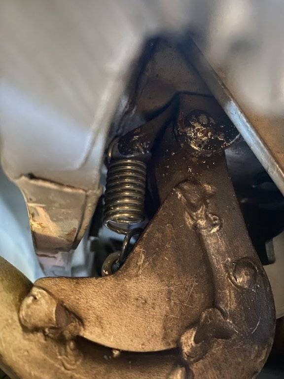

I installed the kit from Dannorama today. Still available a month ago and fit perfectly. I agree it was a pain to install the spring - my left hand still hurts. I used a piece of wire to pull the spring towards the attachment hole. Also I had to do as advised on the Imperial club website; cut a little bit off the "hooks" at the ends of the spring to make the opening a little bigger.
