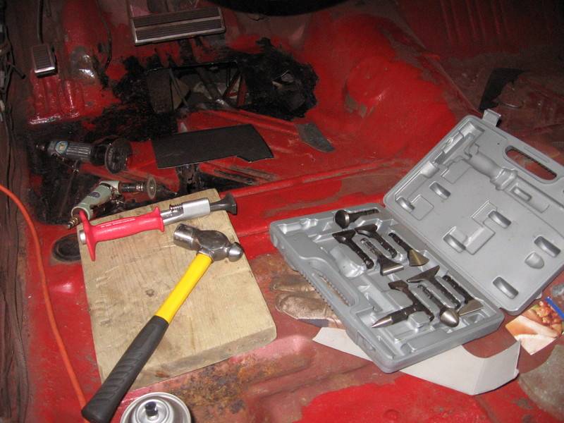

I made my patches from scratch.

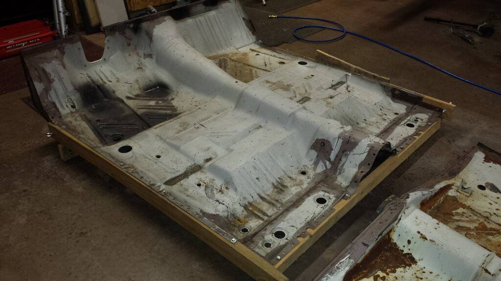

I drove from Niagara Ontario to Cleveland, OH to pick my floor pan & rear trunk rails up about 6 years ago.
These were from a 65 Fury that had been dismantled to serve as a spare parts for a show car build.
This was the worst of the 3 he pulled apart spot weld by spot weld.
By worst, it had 2 spots that needed repairing and he fixed them before selling the pans to me.
What surprised me was that I dropped this pan into the car and every spot weld was a perfect match for my Polara.
Same with the trunk pan I found in North Carolina that same winter.
