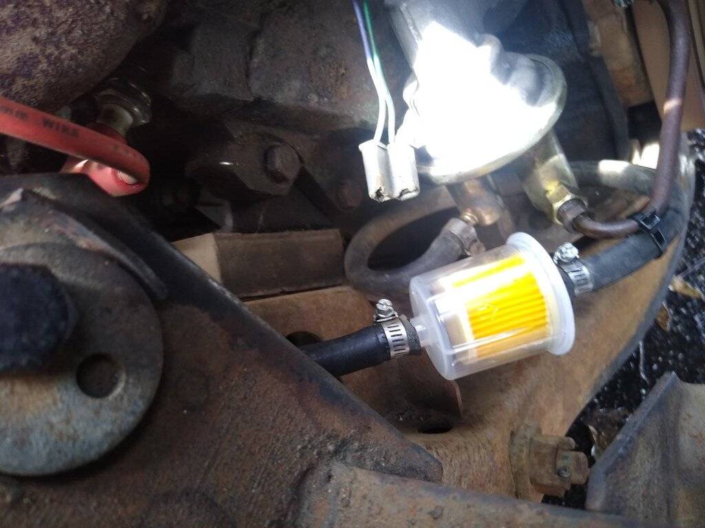

1965 new yorker 413. I swapped last year's metal ff for a clear on. I barely can see fuel coming in, and filter is 1/4 full.
New sending unit last year, and when disconnected, fuel flows well by gravity. Fuel pressure a hair under 7
Is this normal? Seems to run good, first clear I've used. Thanks
That's how mine has been. I've never seen mine over half.
Running, mines less than a 1/4 new fuel pump last year
