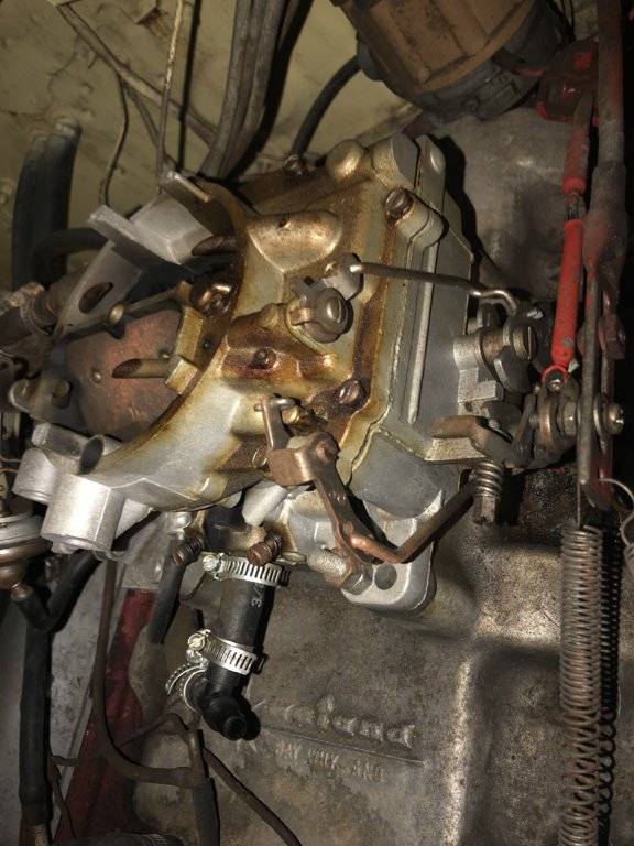

    You have an after market carb and manifold, so a part number is not going to help. Most any air cleaner for an AFB carb will fit, or you can measure the seating ring on the top of the carb and just go with a universal unit from Autozone. The stock carb for the 318 Poly engine is a Carter BBD 2BBL unit on a cast manifold.

    The 318 Poly is a great motor, and will be very pleasant to drive. You have special bits like chromed valve covers and the much covetted Weiand 4 barrel intake manifold. Nice score! Measure the diametre of the carb and the distance between the carb and the hood when closed and you should be able to find an air cleaner that fits. Double check that the transmission to carb kickdown linkage is properly adjusted, as if NOT can quickly result in transmission trouble. This is NOT an option.
    I see a vacuum port in front of the carb that should be plugged or eliminated.

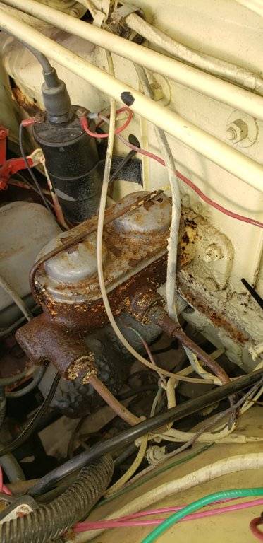

    713CAE58-2765-4110-8978-73550F616D30.jpeg Ross thank you!!! Is this master compatiable??? Or is there a brand I should order from
    Thank you for all of the advice! You should have seen me scattering around looking to write things down! You’re the best!

    That looks OK - Rock Auto will have the right one. Look for 1967 Fury Drum Brake Master Cylinder

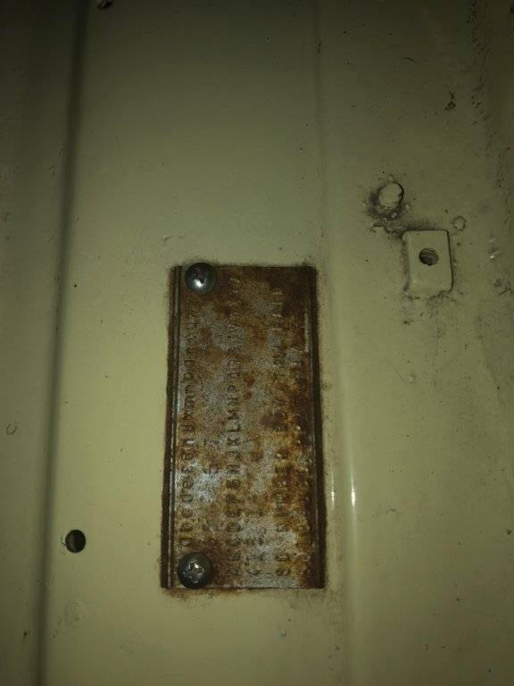

    B4E8A23F-0756-4EC3-9850-268407F6D5EA.jpeg Will this help?

    VIN should be on the door post. That's the data plate which shows options etc.
    Show us pictures of the whole car, we can tell better that way!

    Before you buy another master cylinder, check to see if you still have drum brakes in front. Since the master has been upgraded it's possible someone also changed over to disk brakes and that would want a different master cylinder.

    As for the "changes" to the engine. A Weiand 4bbl intake replaced the stock 2bbl manifold. Looks like an earlier Carter AFB. The carb part number should be XXXX, sometimes followed by an "S", sometimes not. Get into a carb kit listing to check for the general application for the carb. IF the carb's application is prior to the 1968 model year, then the air cleaner mounting circle will be smaller than those from 1968 and newer. The newer ones are the same as the popular Holley 4bbls, then and now, which means almost any open element air cleaner will fit and work.
    If the carb is prior to 1968, then the air cleaner mounting circle will be smaller than the later "Holley" size. There are additional adapters for this situation, but you can also find OEM air cleaners with the smaller circle in their base plates. Most will have snorkels but there were some others which were snorkel-less. Many of those took a Fram CA127 filter.

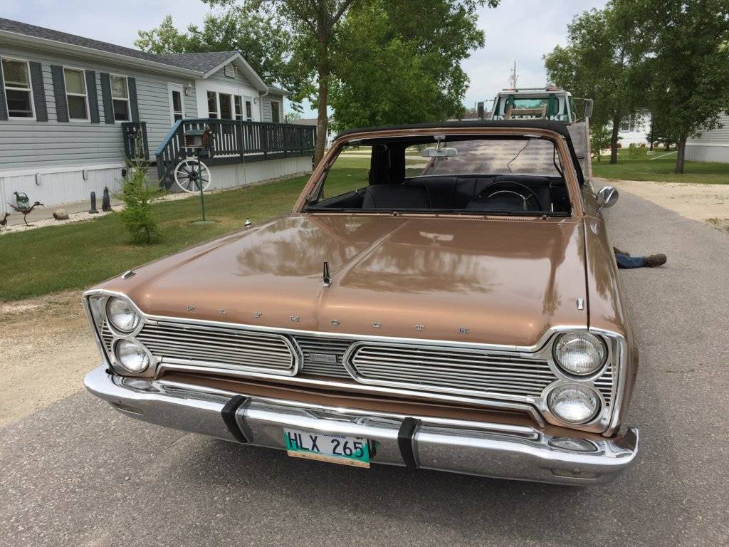

    79AC0DA3-E2D7-4EB2-954A-0699887AD02B.jpeg The easiest and quickest way to tell is that the 65 model and 66 model sported different grills. Here is what a 66 looks like.

    Who is the DOA behind the car?

    Good catch. That is the tow truck driver loading the car. It was in the way to the shop for the missing windshield.

    Tow truck driver must have slept thru the training video on safe hook up operations. NEVER leave your legs out in the street! Some drunk or half blind idiot will run over them and ruin an otherwise perfect day.
