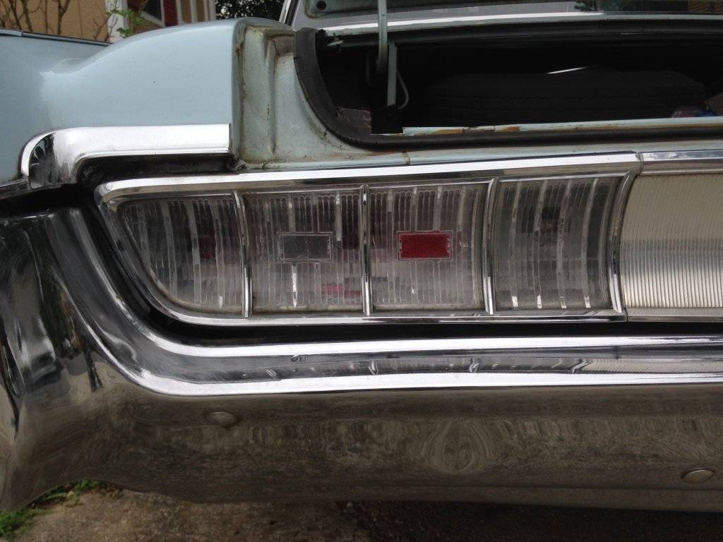

Has anyone replaced or just removed the tail light lenses of a 1965 Chrysler New Yorker? My car has the clear lenses and one of the red plastic lense rectangles fell down inside the lense compartment, and I would like to remove the lense and glue back the red rectangle to its correct position. Any help appreciated!

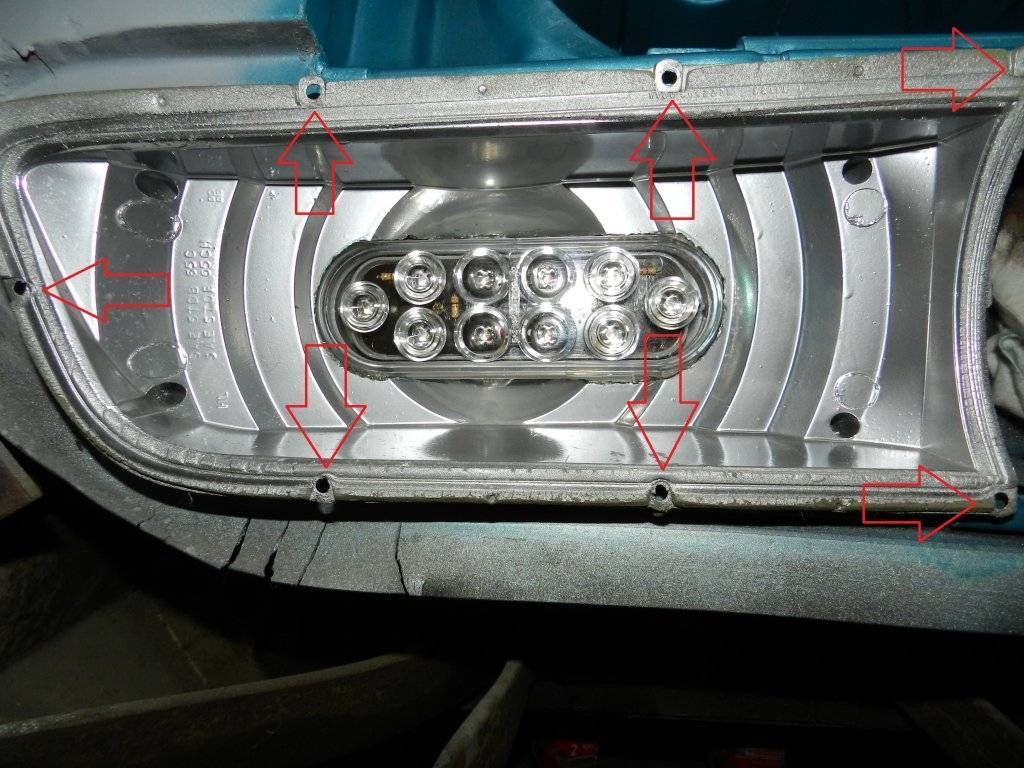

Pull the tail light bucket out of the car (5 or 6 nuts inside the trunk), then remove the chrome trim from the housing (8 or so small philips screws). The lense will then just pop out. You can see the holes for the screws in this photo. The backup light housing is not shown.

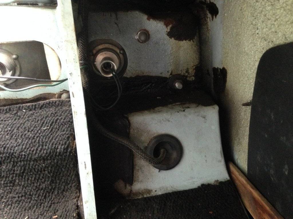

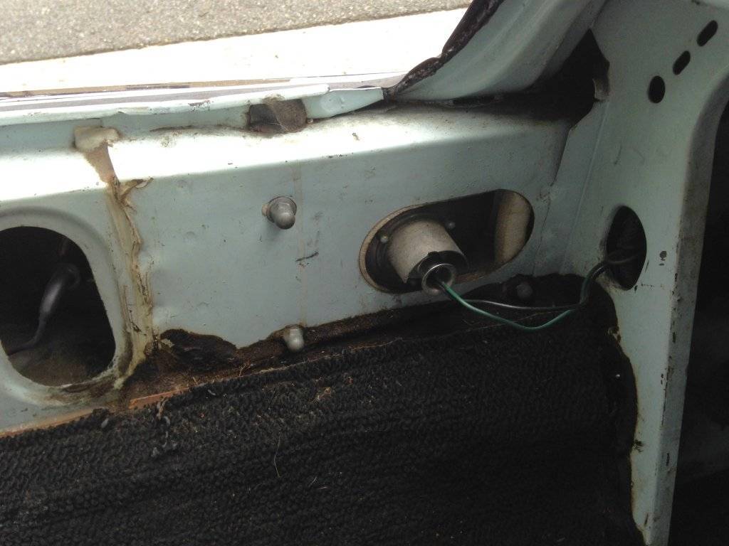

I went into the trunk of my New Yorker. It doesn't look like the tail light bucket is supposed to come out. Here are some pictures to show you. Any thoughts?
Those domed nuts you see are the ones holding it in. There should be about 6 of them. Then it just slides out.

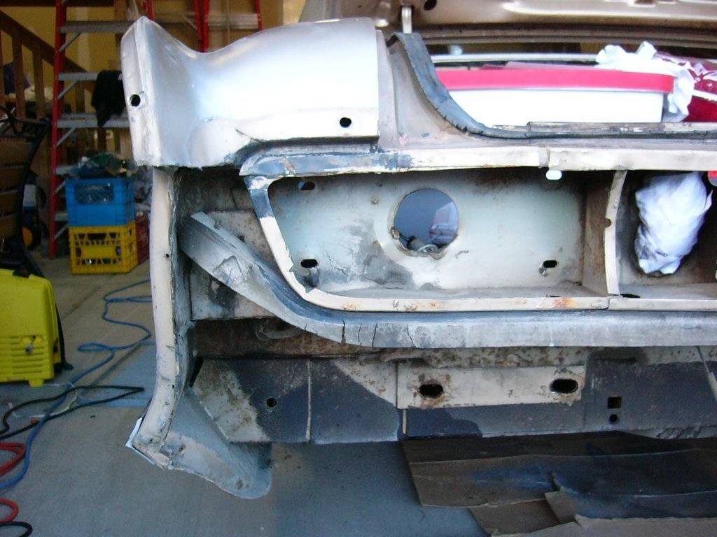

This is what it looks like behind the bucket. The oval holes you see are the mounting holes for the tail light. The domed nuts are in the trunk at these locations.
I see the domed nuts inside; they are in my photo. The thing is, once I unscrew the domed nuts, I will have to break the caulking around the unit. There is caulk, both grayish and black all around the housing - on sides and top and bottom. The thing is not going to slide out without loosening, tugging, breaking the caulk. I would not expect and easy removal after 51 years. I guess I can do some pulling, etc. to get the thing off. I'll give it a try tomorrow. Thanks.

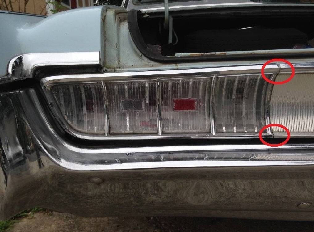

The only way to remove the trim is to have the whole assembly on the bench in front of you. Another thing to note is the chrome trim has two stubs that extend under the stainless where I have noted on your picture. The bucket will not just slide forward with these still in the way. It has been 4 years since I put all this together, and am not positive anymore, but am fairly certain that the two stainless trims are just held in with spring clips and just need to be pried up gently.
The trim is only removable from the back. It is held on with screws at all the noted locations, plus the ones on the backup light bucket. Ignore the LED light in there :rolleyes:

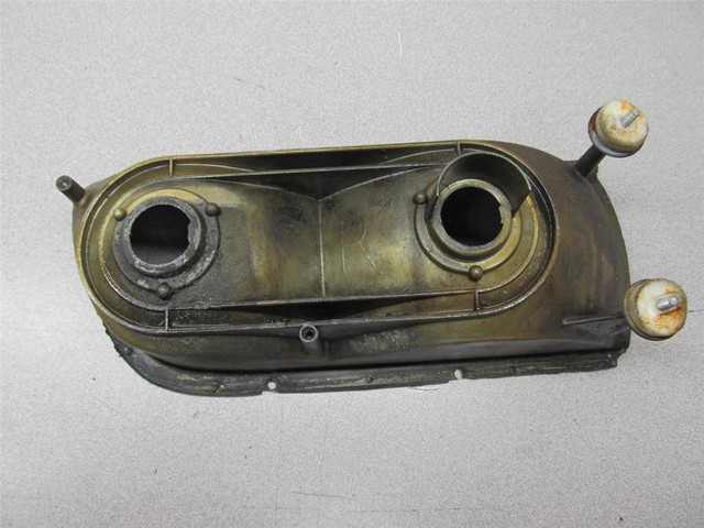

The back side of the bucket. This one is missing the centre mounting studs.
Those pictures explain things. Thanks a lot. I'll follow up with photos of my bucket and lenses. Will work on this one night this week. Those are some nice parts you have there.

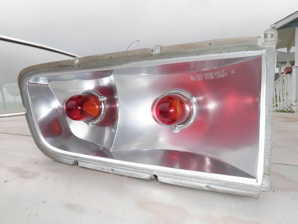

Oh wow. Aside from the rarity of the clear lenses (AFAIK they were only in early 65 and cancelled due to cracking issues) the housing is different too, which I didn't expect because the lens fresnels appear similar between clear and red lenses.
That was a design-intensive issue, to redesign the lenses AND the housings. It's a big deal today even with the use of computers to design the light output pattern, can't imagine what it was like being under the gun for it in 65, with a warranty issue breathing down your neck!
