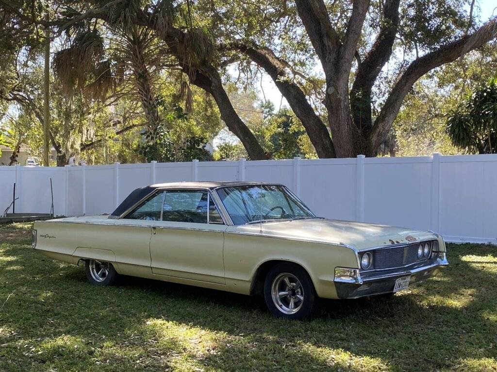

Happy New Year 2022!
Here is couple of pictures…
Starting point for project.
“Well planned is half way done” , old saying from my old country.
Interior is in need complete redo.
-Still looking driver side interior door panel, any color and Chrysler lettering emblems for front and rear.
Greetings,
Rockford.

G'Day,
Congrats, That is Exactly the Type of Project to take on.
It's Not Hard to Picture the End Result.
It will be an Extremely Nice Car When Finished.
All the Best & Keep up the Piccies.
Tony.M
