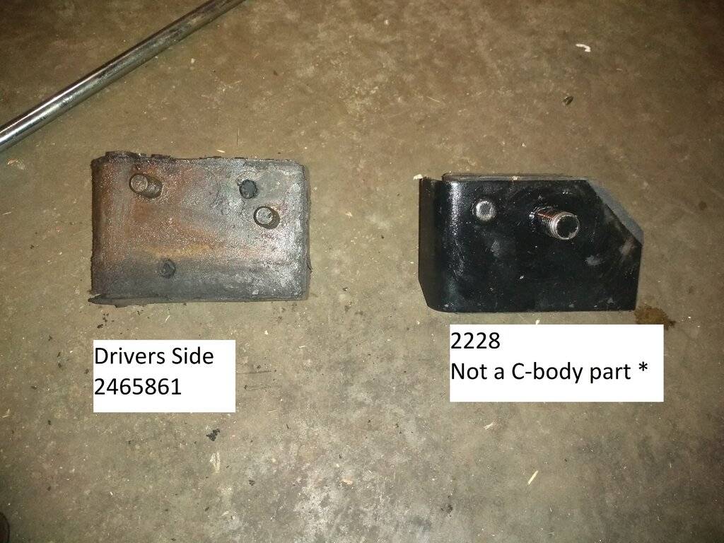

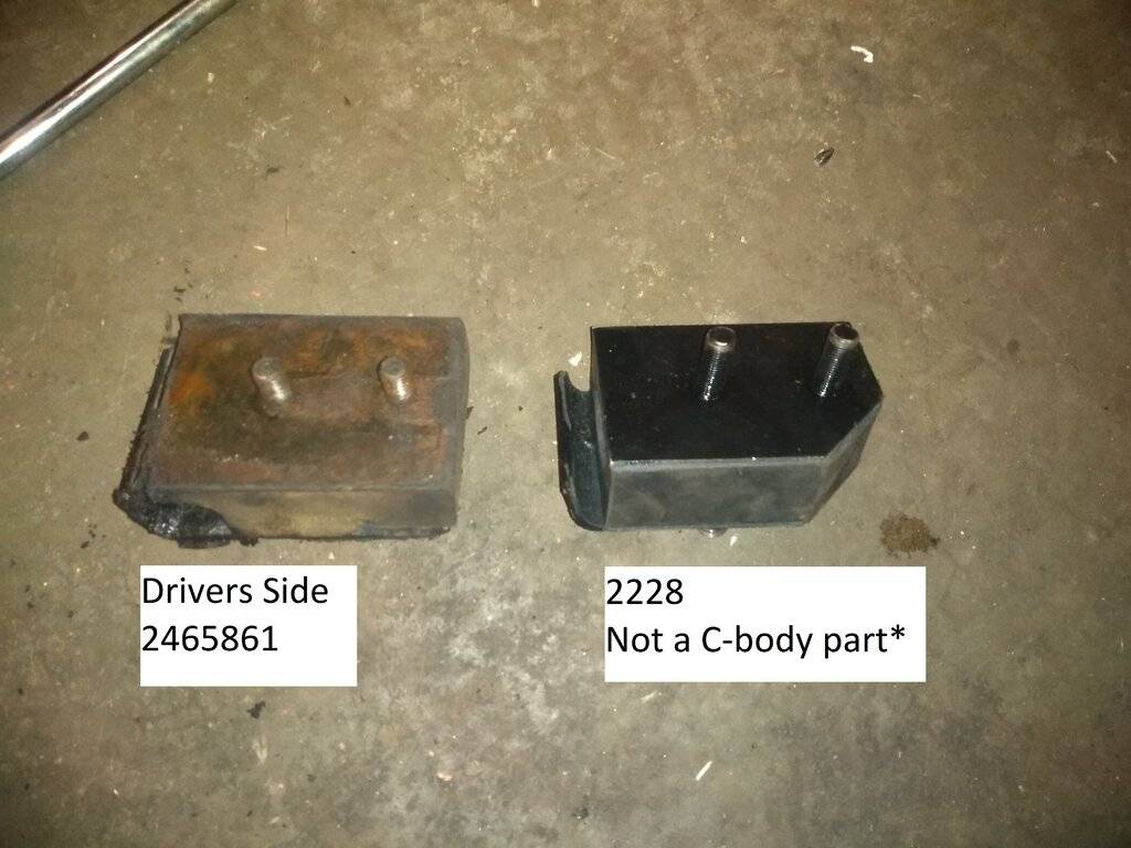

The drivers side mount
1965 Mopar # 2465 861
Aftermarket # 2270? (I saw this number one place, but looking for 2270 mostly gets you a different looking Ford part)
This was used on C-bodies only in '65
This was also used on 67-69 A bodies with big block V8s
This part does not seem to be available new currently
1965 Mopar # 2402 183
Aftermarket # 2228
This is the drivers side mount for a B Body
This is what rockauto, autozone etc will try to sell you but it is not a C-body part (also they have it listed as passenger side instead of drivers:BangHead:)
It seems that in the past several companies have sold new brackets that allow this part to be used on a '65 C-body, but I am not sure if they are currently available
440source shows references a part number (119-1006) for the bracket, but I don't see it available on their site.
I suspect that you could simply drill an additional hole into the existing bracket, but have not really investigated that option.
