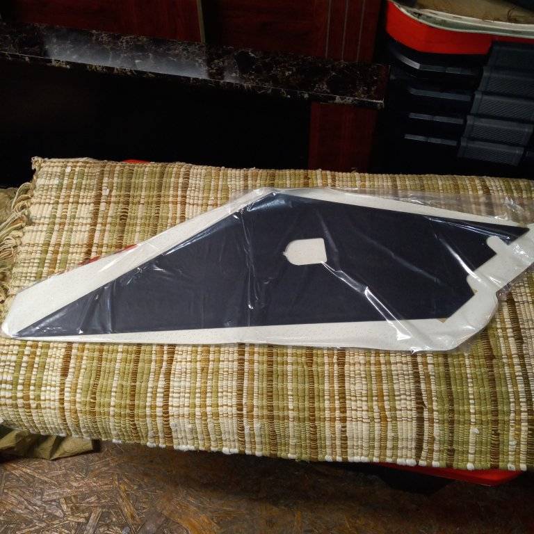

REM AUTOMOTIVE is now making correct headliners for 1965 Monacos. After talking to several vendors and ordering a headliner listed for 65-66 Monaco and Polara. The headliner came as 1 piece of material. Where the sail panels in a 65 Monaco are hardboard wrapped in material. After calling and explaining the problem I shipped my headliner along with the panels to them to be used as a pattern. I was also informed that the bow spacing is different from 65 to 66. The only thing that may be an issue is the new boards are not as thick as the originals and do not have provisions for the 2 mounting clips to hold the top edge. They are definitely more rigid so this may not be an issue. REM is a manufacturer and I don't know that you can get these directly from them. Also, I just received mine Saturday, so I don't know if they are available yet or the price.

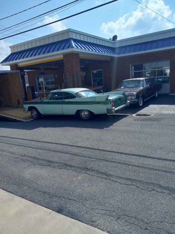

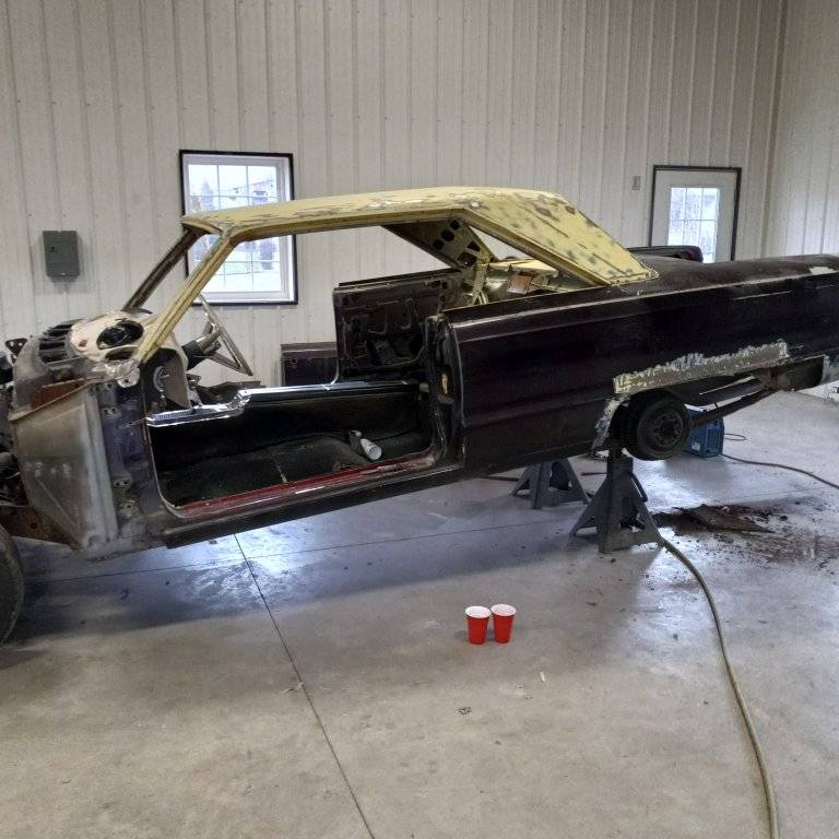

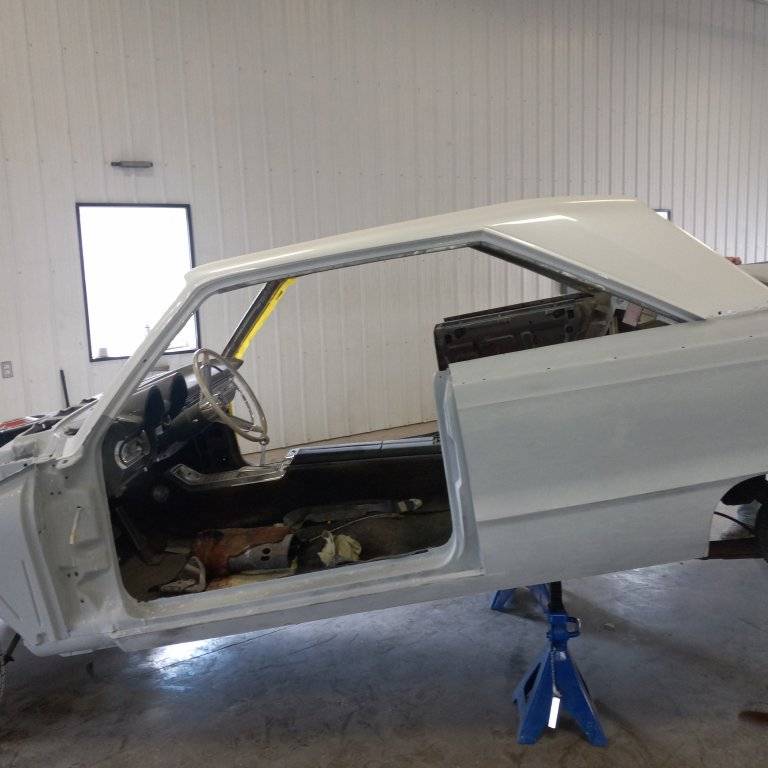

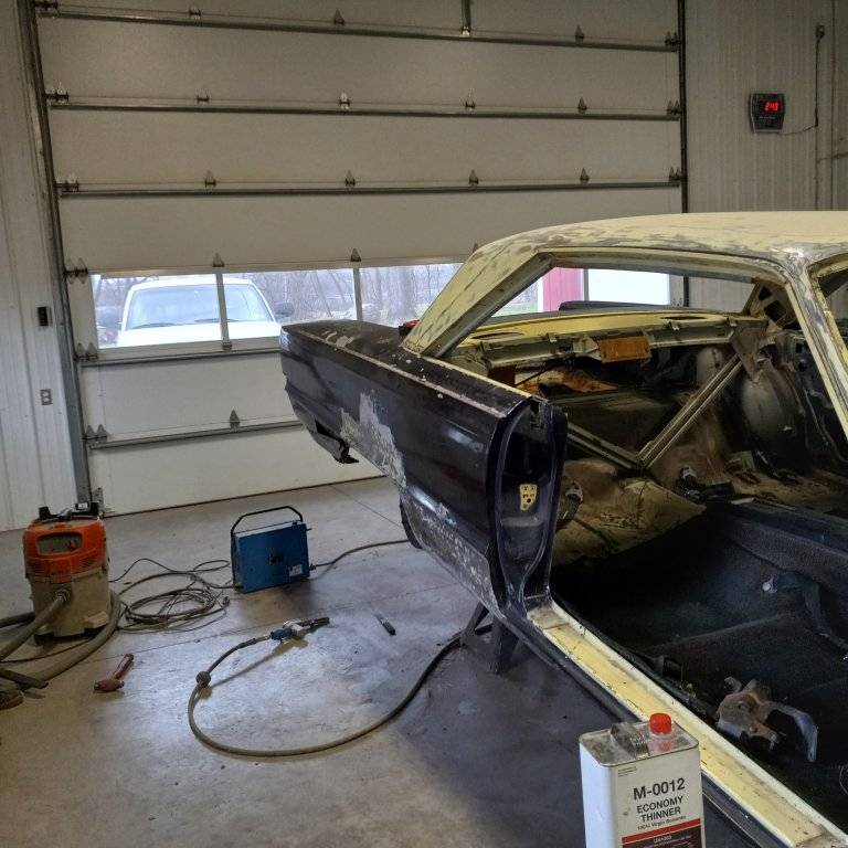

I have had the car for 10 years. I've rebuilt the suspension, motor, transmission and redid the interior. Car is currently at the body shop. The roof is painted along with the core support and inner fenders. It should be done in a couple of weeks.
