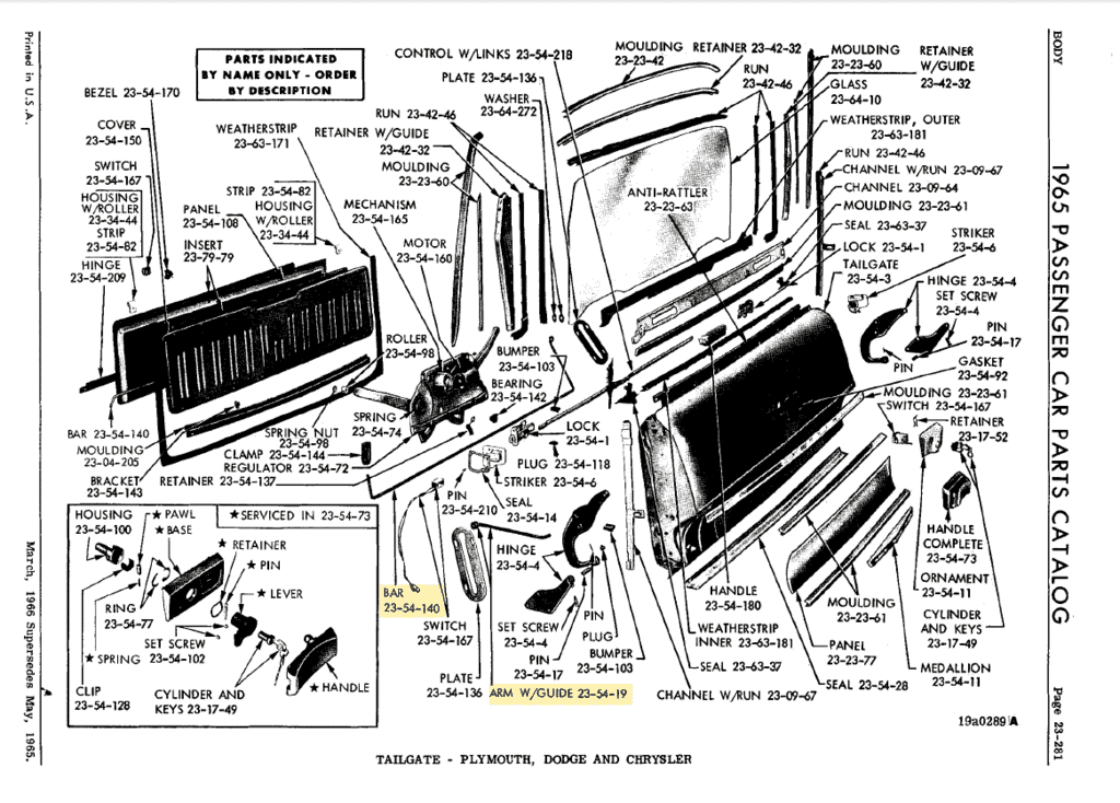

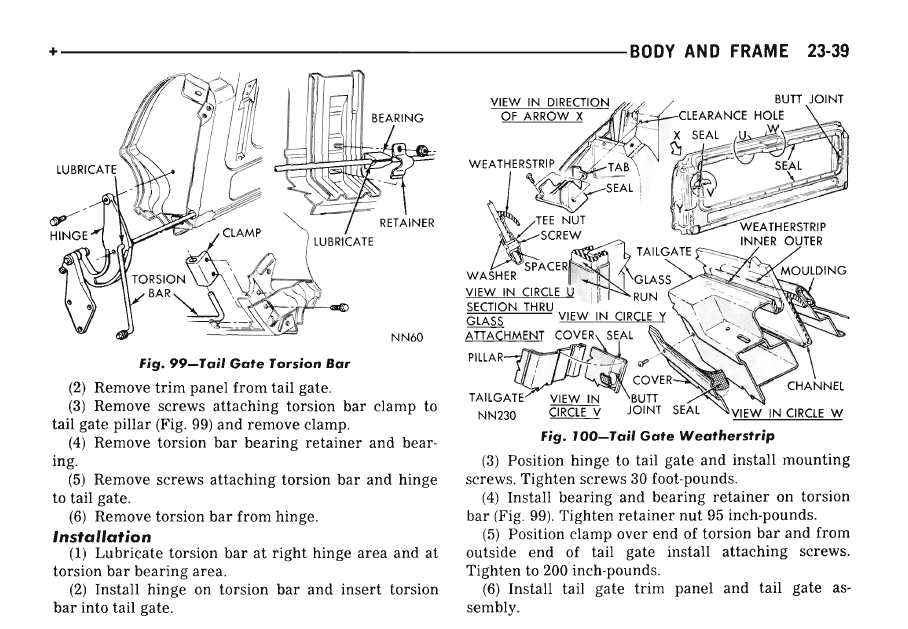

Thanks for the links to the service manual and parts book. The service manual shows that the bars that ride up and down in the tracks are the torsion bars for counterbalance as well as limiting the travel of the gate. We'll have to open up the gate to see if they are broken or disconnected inside.
BTW, the Chrysler manual doesn't show this info on the torsion bars, that's why he didn't find it in his.

According to the parts book, there is only one torsion bar. It goes up to the slide track on the passenger side. The other side is just a support arm. Part number 2520250 on the torsion bar.

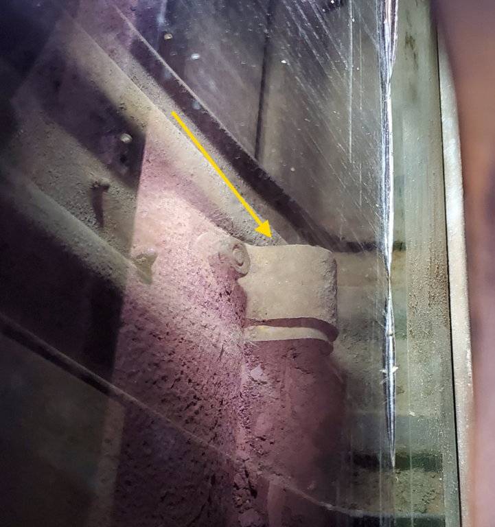

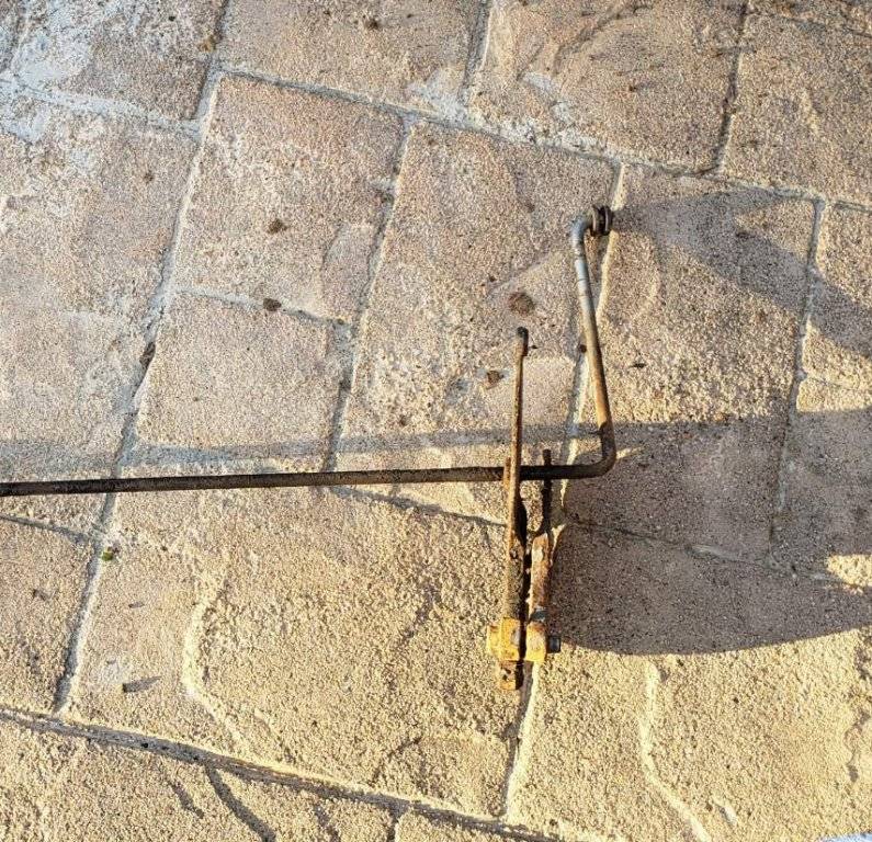

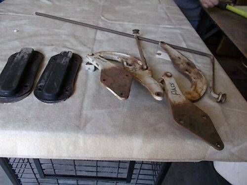

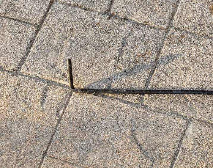

Ok, here's the update on the 1965 Town & Country tailgate counterbalance. I went over and looked at the car. The torsion bar is broken off and the broken part has been removed from the gate. Only 1965 and 1966 fit as they changed to a beefier bar setup in 1967 and 1968. In these pictures you can see where the bar is snapped off as well as the clamp for the middle of the bar and the anchor on the driver's side of the gate for that end of it. This is the same bar that slides up and down on the side of the car and holds up the gate. Only the passenger side one is a torsion bar, the other side is just a gate support. Repair information shows that you have to pull the tailgate off to change it but I think we can do it with the gate in the car. As long as we can find an unbroken torsion bar somewhere.
Found '65 880 wagon parts on Ebay but their torsion bar is also broken off. Maybe it's a common problem and why they redesigned it in 1967.
