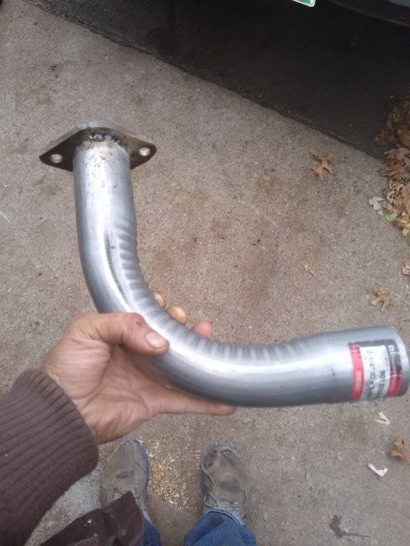

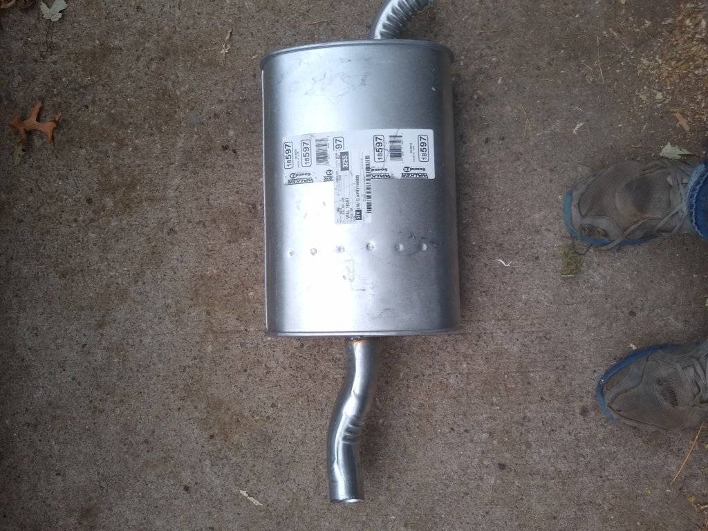

Fabrication is underway. I didn't want wait for a flange, so I bought this muffler ( a sound fx) and cut the flange off, and welded it to this 90 degree elbow. Seems to fit well, gotta finish welding and clean it up.
I plan on doing the same for the driver's side. These mufflers are $54 a piece. I'll update

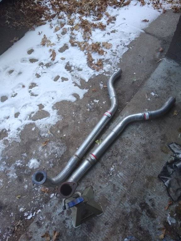

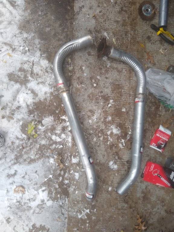

Ran a short extension, then 45 degree elbows. Looks like I may need 2 more 45 elbows to make the S to run under the right spot on the torsion bar support, then straight shot till tail pipes
All it took was 2 more 45 eegree elbows. I had to cut off about a inch and a half, but it lined up nice. I see only one hanger in the back, were these single exhaust originally?
