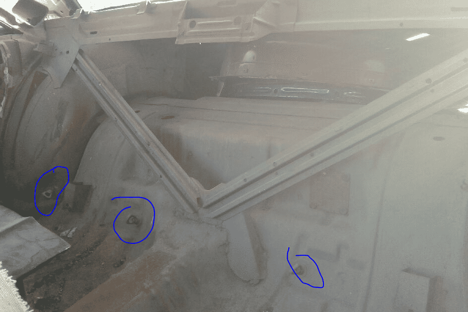

Did you ever have any luck finding a good mounting spot. I just brought a 65 Fury 3 home and am looking to add a seat belt or two to the back seat, but I don't see anything obvious.
Look for the circled things. I suspect they are removable eyebolts, and then you can bolt-in aftermarket belts.
The main thing is to have a large/thick reinforcement on the other side, to keep the belt from pulling thru in case of an accident.
If your car has no such stuff, you can add it. Make sure to use Grade 5 or 8 bolts, 1/2" dia size, and put a large/thick washer on the other side. Don't use a common fender washer - get soemthign ~ 1/8-3/16" thick and ~2-3" dia (might be a little hard to find, but you could use flat bar stock and cut/drill a hole). You need a decent washer on the interior side also, but not as big (because the belt's tab isn't as big).

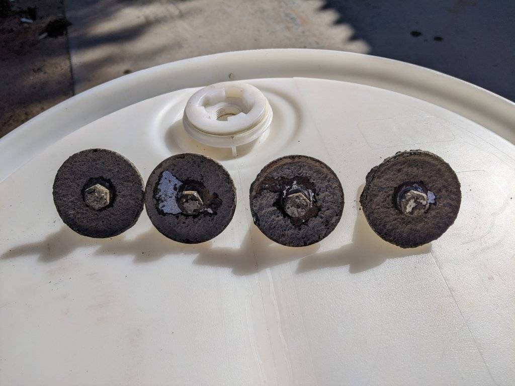

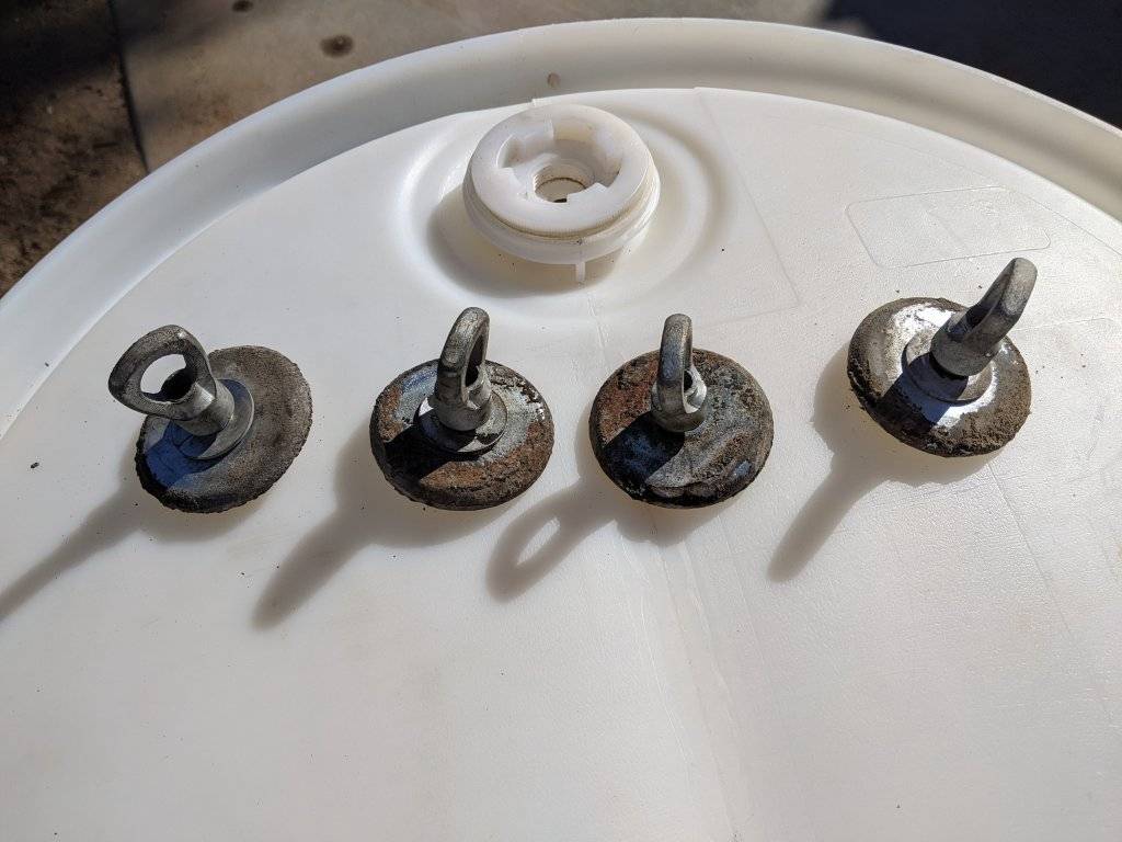

I have some of these.
