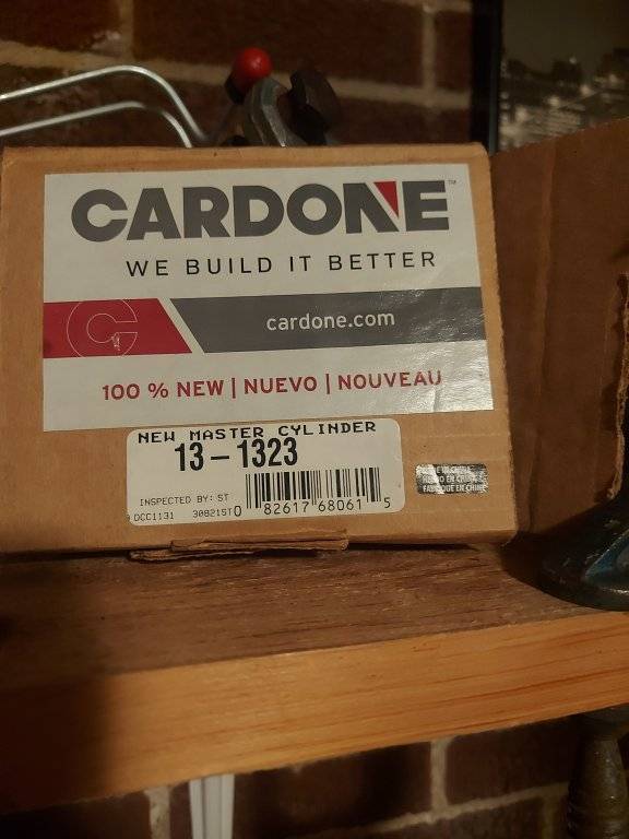

I have everything I need . Looking to keep the brakes Manual . I just can't seem to find a dual manual master cylinder. All seem to be power . Any ideas folks. I ordered the one in the box but I believe it's for power brakes. I know a 67 duel will bolt up. But where's the Manuel ones at? Anyone.? I know Manuel masters will work for power brakes but not power for Manual .

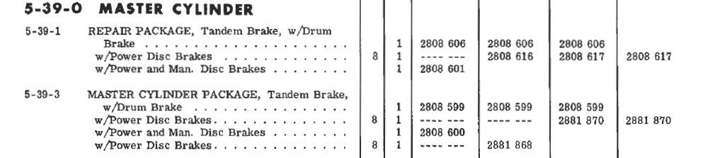

Manual and power will be the same master cylinder.

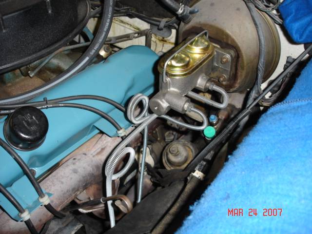

You'll have to pull the old push rod out and install it in the new MC. There's a rubber piece that goes on the push rod to keep it in place. They used to include that in new MC, but they probably don't now.
I've done a couple of these conversions.

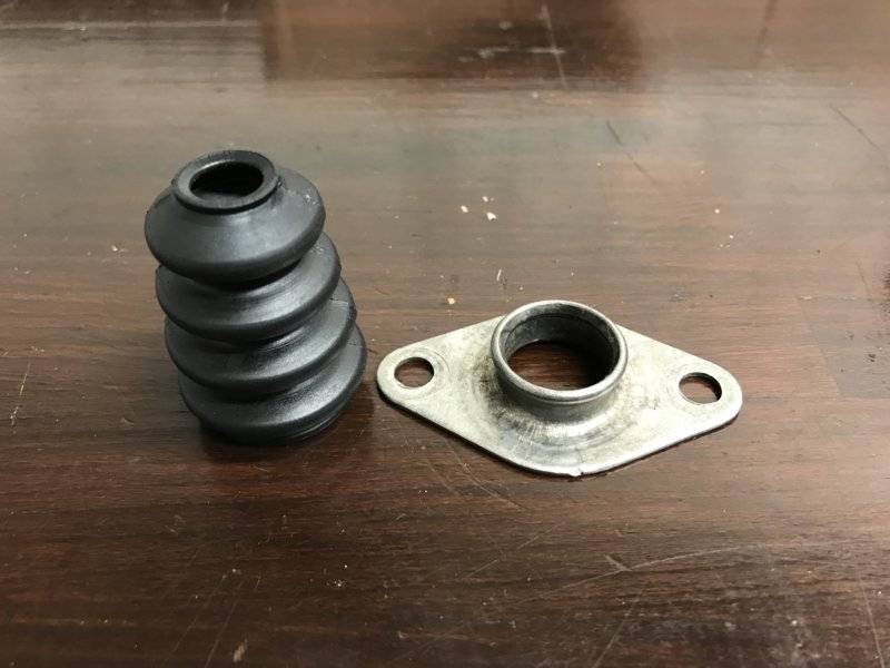

You also need to move this retainer from the old to the new MC.. New rubber seals are available.

You can not believe me if you want, but the cylinders are the same.
