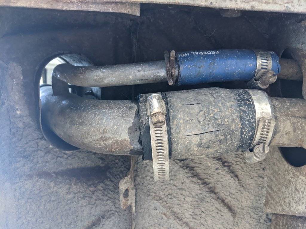

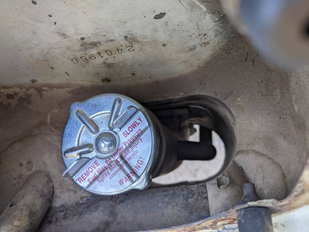

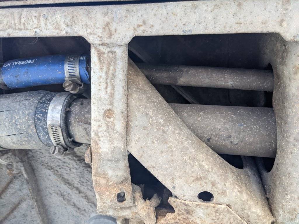

Picked up my 65 sport fury a couple months ago without any fuel tank parts such as upper fuel filler neck, tank straps. Recently I bought a new tank, lower filler neck w/ vent tube. I'm having a hell of a time trying to find upper filler neck (due to the one year side fill style). I'm wondering if any of you guys could send me pics of what the upper filler looks like along with the neck support pad so I can some how Frankenstein one together from parts available or maybe one of you has an extra one? Also if anyone has any diagrams or tips for putting it all together that would be great. Thank you

Not sure if this will help but here's pictures of my 65 Fury.
View attachment 513728View attachment 513729View attachment 513730
Just want to say thanks again I got it to all work out ended up using a 1947 to 1950s GMC truck filler neck (looked as close as I could see like your filler neck in the picture with the vent tube) and I've had the new tank and all of it put together in the car getting on a month now so nice to be able to drive this thing far. Your pictures really helped me get it set up right and find the right parts to make it work. Thanks again
