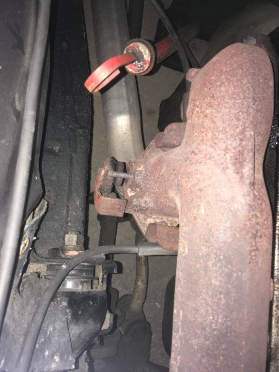

It’s open or closed?
THANKS - I'm having the same problem with the Diplomat, we've tried everything else, maybe THIS is the culprit.
First check to see if it moves freely. The weight should be down when the valve is open.
Dave
Its free but broken spring! Seam to be alway down! Wich way my carb will not be heated? Down or up?
‘68- 383 & 440 counter clockwise is open. 318 is clockwise.
If you blip the throttle when it is warm you should see it rotate ccw if it is free. Even if it is working, at idle it will be partially closed as it uses the exhaust gas flow to open it.
My counterweight is a little different than what the manual shows. I have no up or down as it is eccentric.
The picture in the service manual shows the Counter weight up when cold. As the thermostat spring heats up I believe it allows the Counterweight to over come the spring force and rotate down. I am not 100% sure for 65 but I think it is very similar. You should be able to down load a 65 service manual for free

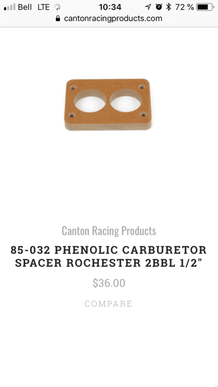

Thank, I think it’s not my heat riser, I want to try a phenolic spacer, this will fit? Do I have a rochester carb?
