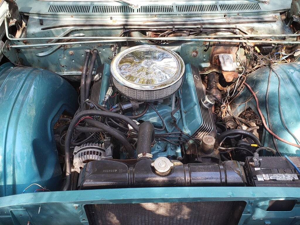

Sonim at my wits end. Not sure if I have a fuel, vacuum, or power issue. Car was running fine, perfect actually. Now suddenly it wants to constantly stall. It will idle in park and neutral, goes into gear and it wants to stall, sometimes it immediately dies. Sometimes when I press the brake (all drums) it dies. Sometimes when I push the gas at a red-light it dies. Once it running at a higher speed it runs perfect. I've adjusted the timing, the idle screw. If i run the timing advanced it somewhat helps, but I mean extremely advanced ..
HELP!!!

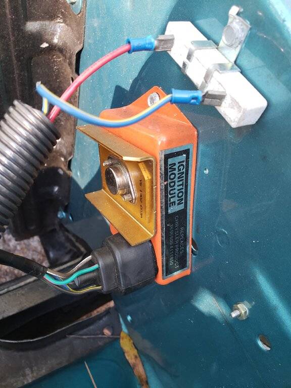

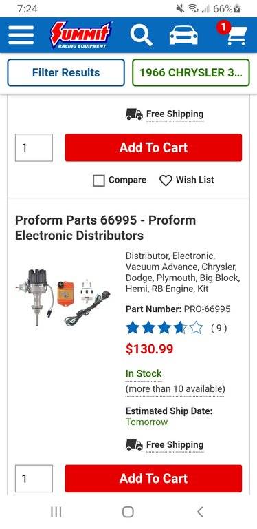

I put an electronic ignition in it similar to this one. It came with a ballast Resister amd im still running the original at the firewall, do I need to delete one or both?

Those have a bad track record of defective ECU's. You really have to see if you have spark when it dies to eliminate that if it is working well. Also a points ballast if OEM is .5-.6 ohm the one with that should be one ohm, yes I would change it. Still check for spark and fuel when it dies to get a starting point. This all happen after the rebuild?

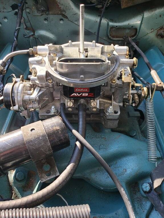

What carb is on the motor? How long might it have been inactive? Does it start fine, run fine, until the fast idle cam kicks off and the idle system is supposed to work? Have you changed carbs as a diagnostic orientation?

Edelbrock AVS2 650. When it dies sometimes it will fire right back up, sometimes it leaves me stranded. Alternator is about 5 months old, battery about the same. It sometimes has a small backfire through the carb at the end of a cycle when trying to start. I'll try to get video later today if I can get it to replicate the issues.
One ballast resistor.
I'd use the one that came with the new ignition, but it probably doesn't matter which one you delete.
By using two, your are limiting the amount of current to the ignition more than you need. Get it hot and the current flow through the ballast resistor goes down even farther (as it should). So... Current goes down and now the voltage has dropped to where.. Drum roll... The car starts stalling etc.

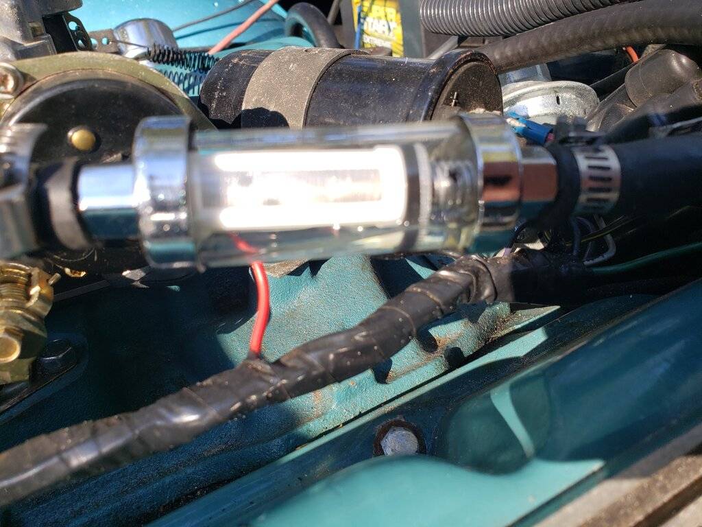

If that doesn't help, you need to go over basics before you start throwing parts at it... and throw away that f...ing glass fuel filter!!! The glass breaks and your car burns. Metal fuel filter is the way to go.
Put the one that came with the kit in it is rated for the ecu, Only one of them and that system do not jump it. The ECU is a mopar knockoff, "replaces" is the word there. Lots of failues with them also. If the fuel is good classic Pickup in the dist problem but also can be the ecu, need them tested to be sure both hot and cold.

I was going to say the same thing about the BR. As soon as I saw the first BR pic I thought, "Why was the BR rewired instead of using the factory wiring?" Then I saw the next pic and that there are actually TWO BR's wired-in somehow, which is definitely not correct.
The rats nest i inherited with the car, going to try and correct all that after I paint.
Thanks for all the advice everyone. I deleted the original Ballast resistor, changed the fuel filter and made some tweaks to the fuel /air mixture on the carb. Running like I've never heard it run before! Now it seems to have developed a rattle, im guessing from the exhaust..on to the next problem!
