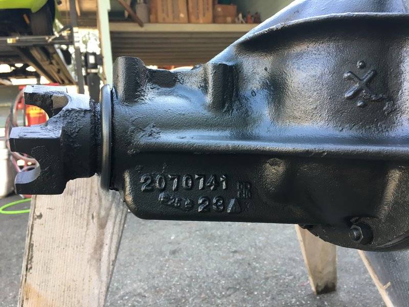

It will be on the forward part of the carrier on the drivers side of the car. Probably will have to scrape off a bunch of hardened on grease and dirt but it will be there in fairly large cast numbers.
To illustrate where to look:

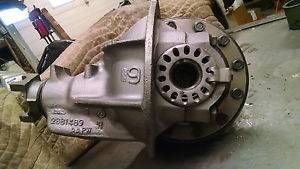

Replacement with a later model, like this 489, is not unusual, so you really need to verify.

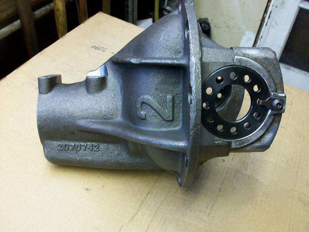

The 741, 489, and 9 1/4" all use the little seal, cheap one.
The 742 uses the big expensive seal.
The 489, and 9 1/4 both use crush sleeves and require a special procedure and tools.
