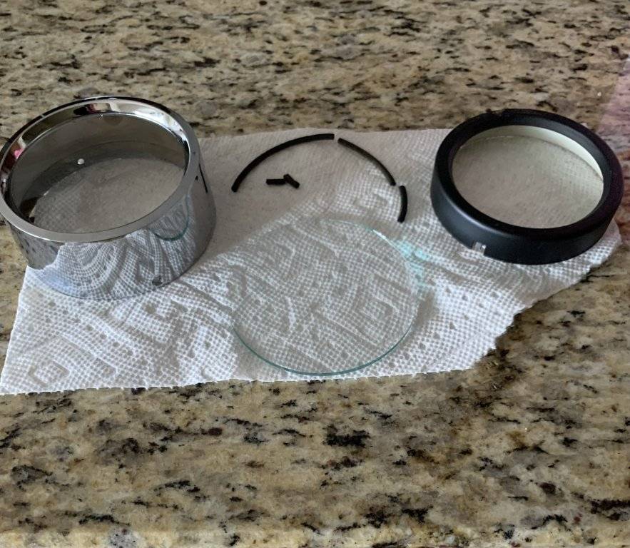

After removing the front chrome bezel from the console mounted vacuum gauge to clean the glass lens, I found out that there are two gaskets inside that quickly crumbled into pieces after removing the lens. There is a gasket/seal between the chrome bezel and the front face of the glass lens and another seal between the back face of the lens and an inner black bezel that is mounted in front of the gauge. Wondering if anyone has found a suitable replacement for these two gaskets/seals?

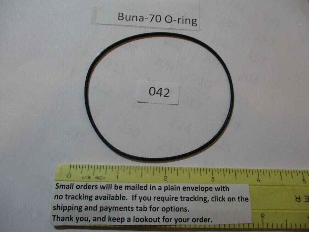

I found this rubber ring on EBay that may work as the front of glass lens to chrome bezel seal/gasket.
042 O-ring. 3-1/4" ID x 3-3/8" OD x 1/16" thick. Buna-70. Quan 1. | eBay
I will update how this works out after the rubber ring arrives

Also, my initial thought for the other seal was to order a 1/8" thick sheet of neoprene foam rubber and attempt to cut it out with an exacto knife
Here are the outer chrome bezel, the glass lens, black inner bezel and what's
left of the front gasket/seal.
Those would be too wide and too thick. The inner diameter needs to be 3.25” and no more than 1/8” thick
Why don't you post a pic of what's left so we're not shooting arrows in the dark! Or is that to complicated?
The old gasket, you moron! Here, go make your own! Good Luck

I only see one gasket in all your pictures, and I said to post a pic. You say you already did that! So, where's the pic of the second gasket, or what's left of it?? Who's the Moron now?

The inner gasket that goes between the back face of the glass lens and the front of the black inner bezel was made of some type of light foam rubber material that basically dissolved into dust when the lens was removed, so there was nothing left to take a picture of. I have ordered some foam material and will attempt to fabricate gasket/dust seal and will post some pictures later if I have any success. As I mentioned earlier, I know anyone who has had to change out the bulb in this vacuum gauge has most likely run into this problem and thought someone would have likely responded with a solution that they came up with.
