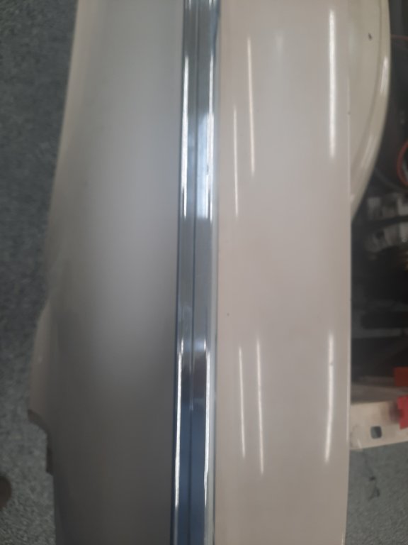

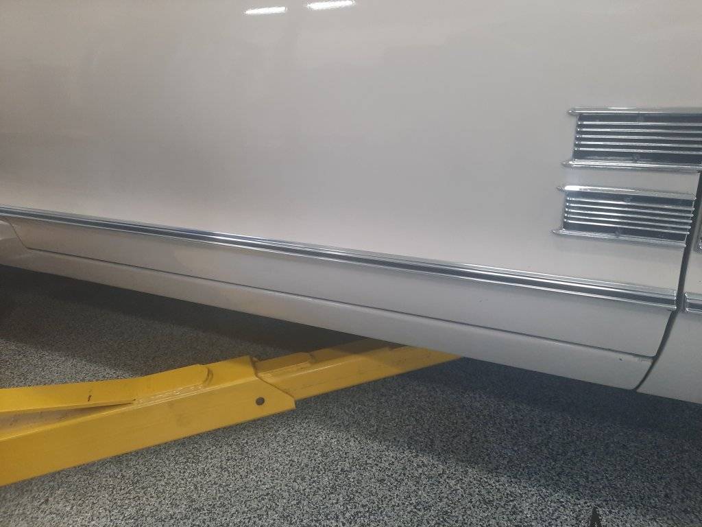

Top moulding that goes full length of car. Is there any way to get the moulding off of the clips without ruining the clips. I understand that I can loosen door and let it hang to allow trim to slide by. Is there a way to get them off without doing that. Are these clips available anywhere?

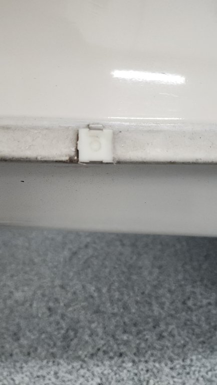

I believe the lower moulding has similar clips, only smaller. Any tricks to getting these off and are these clips available?

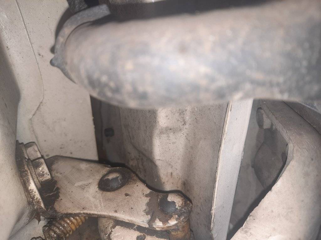

These pieces seem to have some kind of rubber nut that just spins. Even when the fender comes off it looks like at least 2 of the screws are not accessible from the back due to fender reinforcement panels. Anyone have experience removing these? If so what did you use to reinstall them?
Here is one of the rubber nuts.
Not the clearest picture. It's way back there.

I make the clips. There are 2 main styles at the top. The black ones are located in accessible areas in the trunk, they slide off the trim after the trim is removed. There are also black ones on the front fender but only accessible if you remove the inner wheel wells. The main rest are white ones attached to the car with push pins and are mounted to the car and the trim is snapped on to them. Some can be saved depending on how crispy they got over the years. There is one on the leading edge of the door which can be removed when the door is open. There is an acorn nut holding it in place. I make them too but they can almost always be saved when you know they are there.

I think I will wait until the fenders are off and then slide the trim off to try and save the clips. It looks like the door and rear quarter trim may slide off as well. Fender trim won't get past the door with fender on the car. Do you make the clips for the lower trim as well?

That is what I tell everyone, see how many you can save. I think I lost about 10 when I removed mine, but my car had been garaged it's entire life, so my clips were in really good shape.
I do make the lower clips too. I was very careful and don't think I lost a single clip from the lower trim. I removed the top trim first and figured out the best technique for removal on them.
