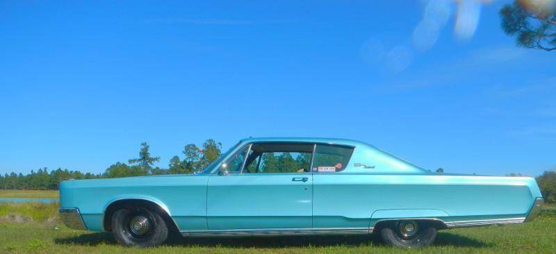

    It can still look spectacular with 14-inchers.

    But only if the Chrysler is actually wearing the rare Chrysler dogdish caps, which it looks like this one is.
    Otherwise, it just looks kinda wrong to me.
    But I saw a high-dollar 68 Hemi Roadrunner on ebay last week wearing Dodge caps with the red fratzog, which I considered unacceptable due to availability of the correct caps. Esp considering the pricetag on the car.

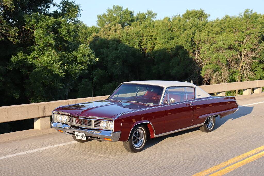

    14”
