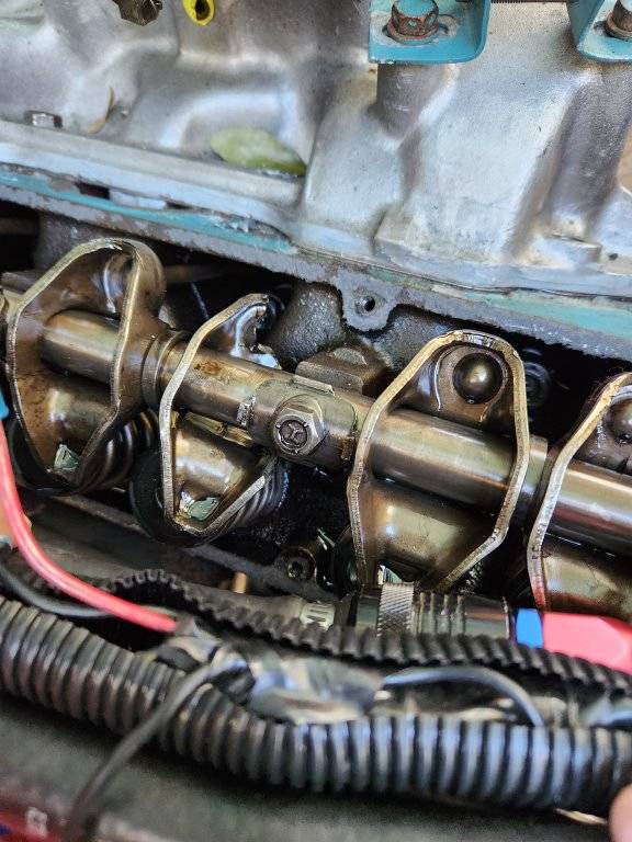

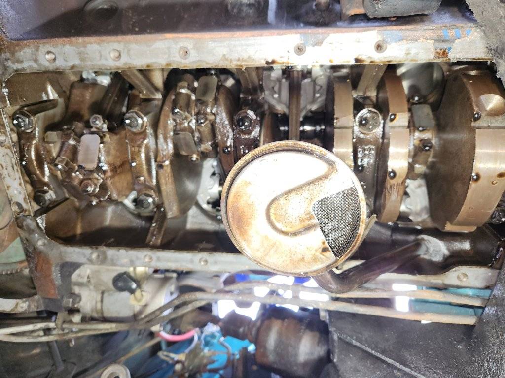

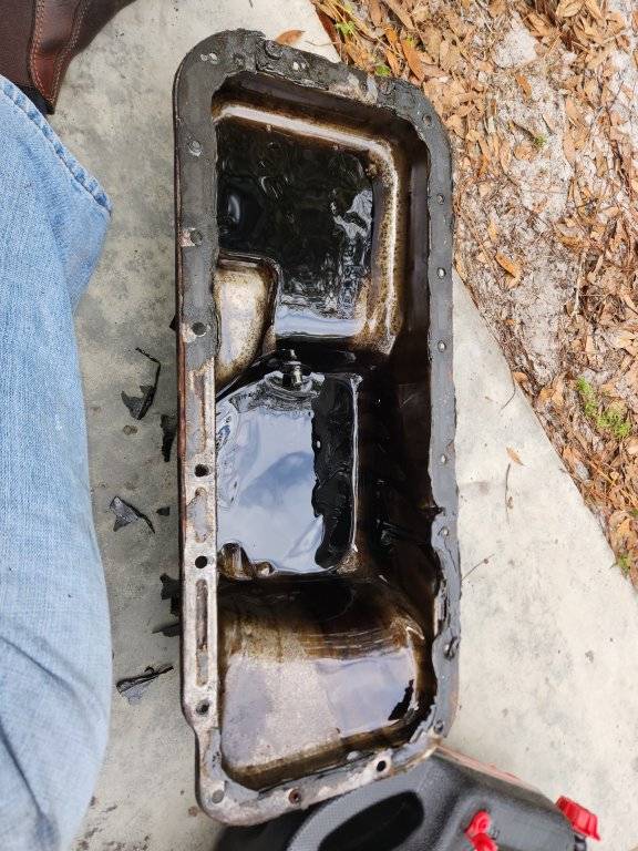

Rebuilt engine, maybe 2k miles on it. Would randomly lose oil pressure when i Would "goose" the pedal at low RPM under 15mph. Recently while taking a corner , maybe 20 MPH, oil pressure dropped and never recovered. I shut the car down right away and had it towed home. So far I've pulled the distributor and checked the oil pump gear, replaced the oil pump, dropped the pan, pulled the pickup tube, cleaned it thoroughly. Reinstalled everything and still no pressure. I have the original "dummy light " and a mechanical Guage under the dash. Both show no pressure. Anything im missing before i tear into the engine? I did find some trash in the pickup screen and thought it would fix the issue. Im going to pull the pump again. Pack with petroleum jelly and give it one last try.

Why is the oil is the oil pan so dark?
how many times have you changed the oil in the 2000 miles?
take out the relief valve and make sure it’s clean and moving free. Then prime with a drill. You don’t need to pack it with Vaseline.

Also check the lifter galley. A broken push rod will cause a lifter to pop out leaving you with zero or very low pressure. You can check this simply by pulling the valve covers and turning the engine over, if one rocker is not moving, that is the source of the problem.

Good point.
I've seen push rods pierce rocker arms and let a lifter pop out.
This is pretty easy to check

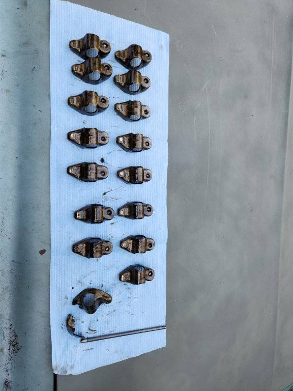

Rock Auto has some, made by Melling, but kinda pricey when you consider needing 16 total.
Does not say where made, but Melling has always been a good name in engine parts (Unless things have changed?)
When it comes to Left/Right - that refers to the offset of the pushrod pocket, not left/right side of engine. (but you'd buy a whole set, so not an issue)

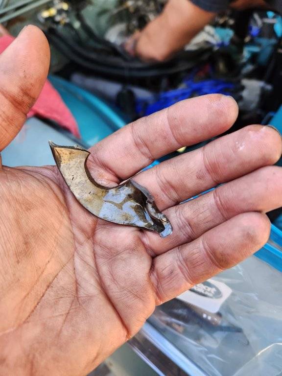

1970 CHRYSLER 300 7.2L 440cid V8 Rocker Arm | RockAuto
