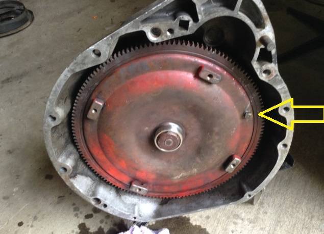

How do you drain the torque converter?
There's a drain plug. Remove the cover on the bellhousing and you'll have to "bump" the engine over until the drain plug appears.
That said, some of the newer and replacement convertors don't have a drain plug.

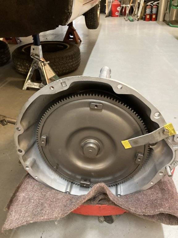

This is actually a 904 but it shows the drain plug really well. Just bump the engine over until the plug is at 6:00.
So the drain plug on my 727 is about 8 o'clock in this photo, if I'm understanding you. Just bump the engine until the drain plug is at 6 o'clock, then unbolt it and ATF comes out? Put the plug back in, and you add fluid through the dipstick tube once the new filter and trans pan are also installed? I've done many transmission services but never drained a converter. Just making sure it's as easy as it sounds.
Yep, it's that easy.
Might need to add the initial amount of "filter change" fluid, then add in the rest of the total to bring the level to where it needs to be after the engine has run a bit to re-fill the converter.
