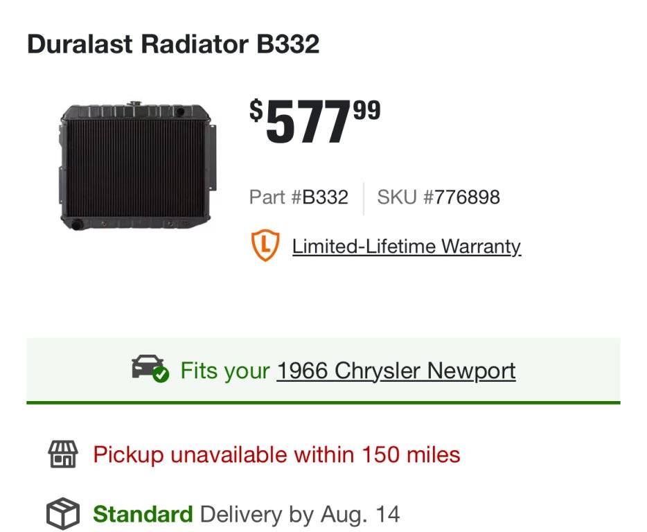

Cold Case radiator (MOP757A) brackets won’t allow it to mount on my radiator support and won’t fit my fan shroud going off the measurements they provided me. Cold Case does “not do custom application” as I asked if I could just have the brackets welded on without any cuts or holes drilled so I could modify it myself to work.

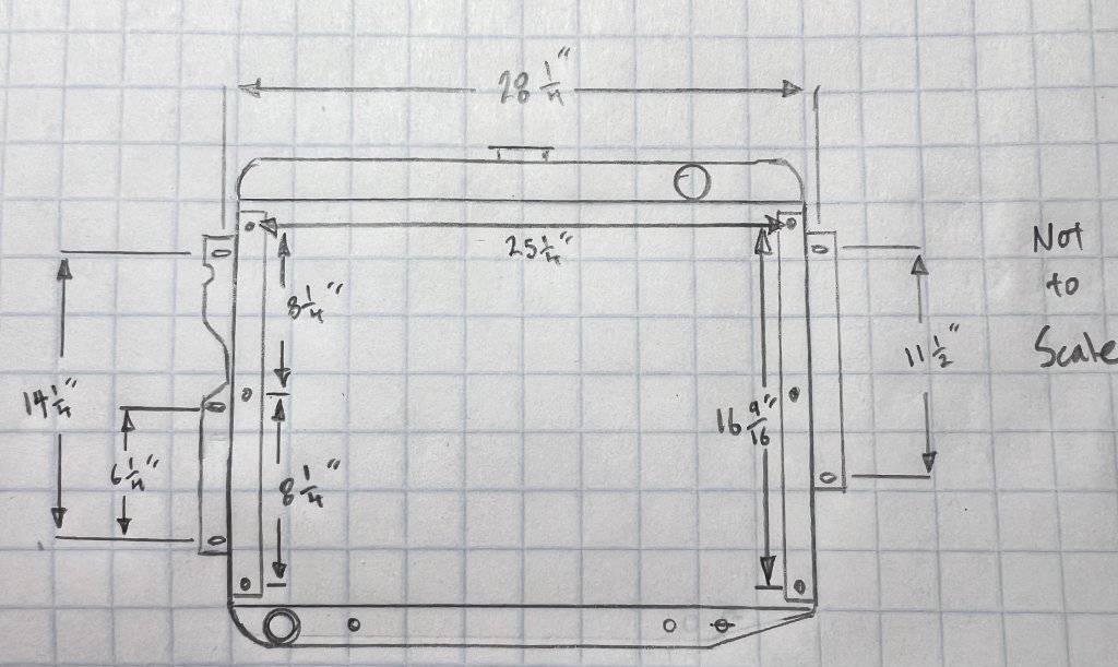

What cars do these actually fit? I found several threads on these radiators being made “exact” to MoPars. 66-70 as listed by them obviously isn’t correct for all cars… The fan shroud mounting is a 4 inch difference in width! Mine is 25-1/4” stud to stud and they gave me a measurement of 21-1/4” hole to hole. I might could possibly make it work but I don’t want to drop $500 on a maybe. The mounting holes are all totally different with exception of maybe the top ones. But the top holes are drilled too close together by 1/2 inch. I don’t know if there is enough meat on the precut and drilled brackets to modify it to work?
The 26” ECP radiators (someone else recommended on another thread) are too narrow to work. Their fan shroud brackets won’t fit my Chrysler part #2579011 plastic shroud either.

Below is the measurements of my radiator and fan shroud mounting brackets. The measurements are center to center on the holes and fan shroud studs.

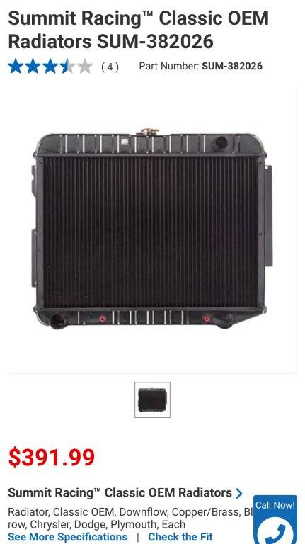

Summit is the cheapest OEM style available. Though not sure if it’s the same or if it will fit. But visually it looks the same.

Remember, Summit is only a re-seller and does not make the radiators they sell. In some cases, many people tend to give them more credit than they deserve in some areas. Their "hook" is generallg good pricing. Might be the same radiator from AZ in a different box? Considering how many companies still make radiators!

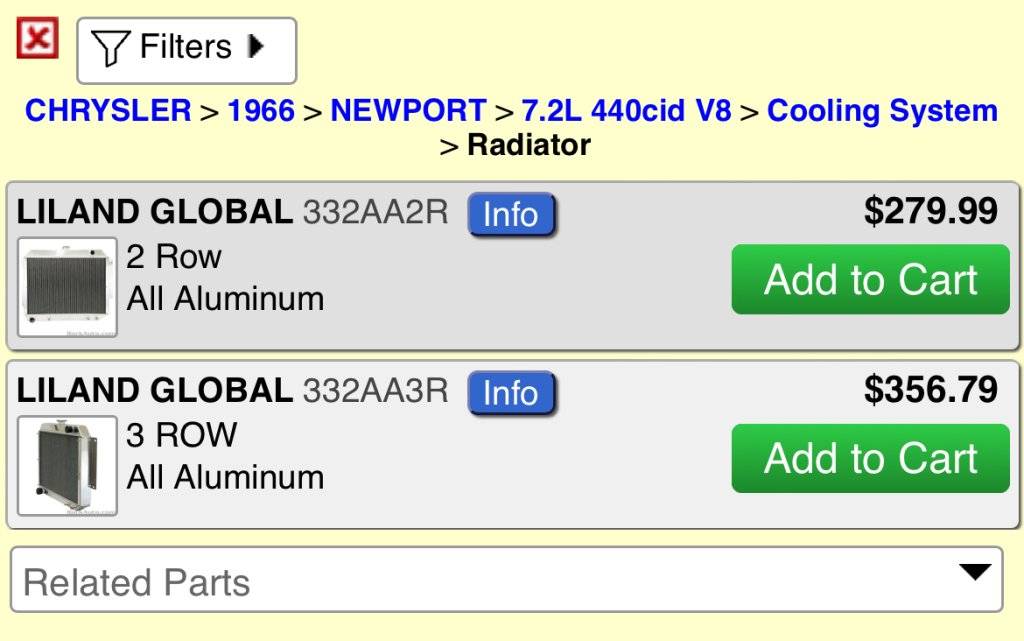

The Liland Global is a local place that does not have a good rep. Basically it was a radiator shop that was bought by a Chinese guy that has ties to factories in China. They built their business on cheap replacements for used cars that only had to last a year or so. The used car dealers love them...

The summit radiator visually appears to have different tanks than the autozone/advance radiators at least going off the photos. I would be curious as to who makes them. Whoever made the one in my car currently doesn’t know how to solder.
