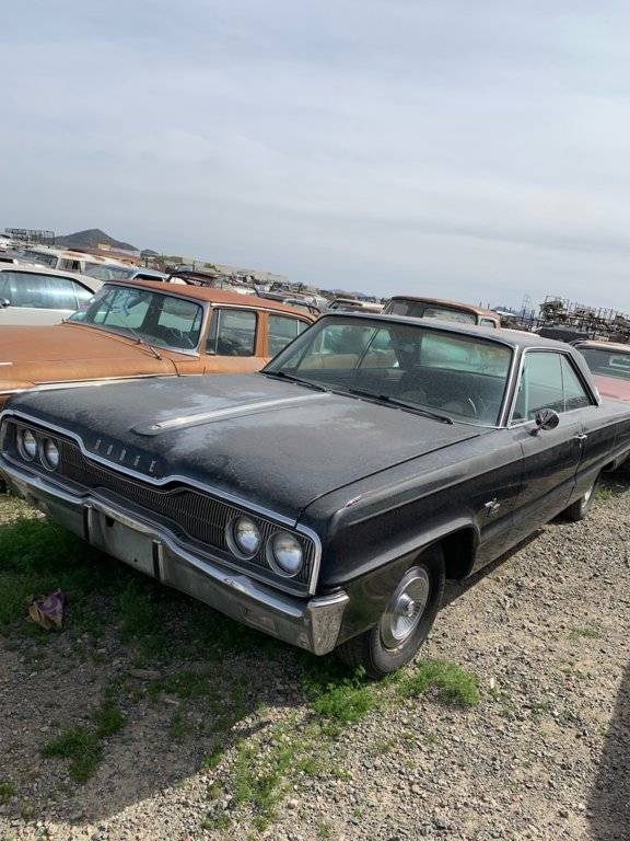

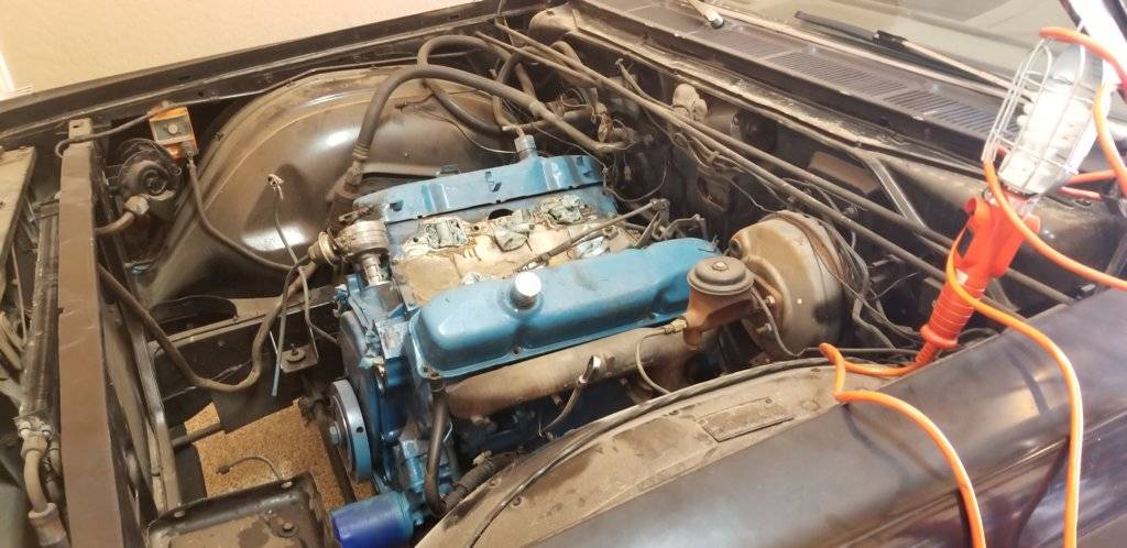

    My 66 Monaco, newly swapped 383, paints rough, interior is too.

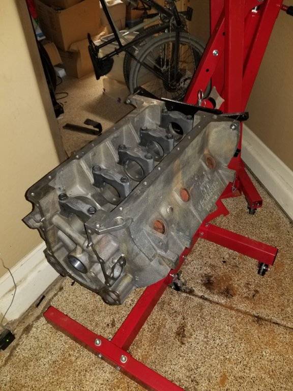

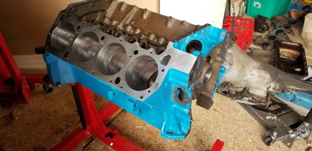

    Dropped the 383 today. Its waiting to be completed on the stand.

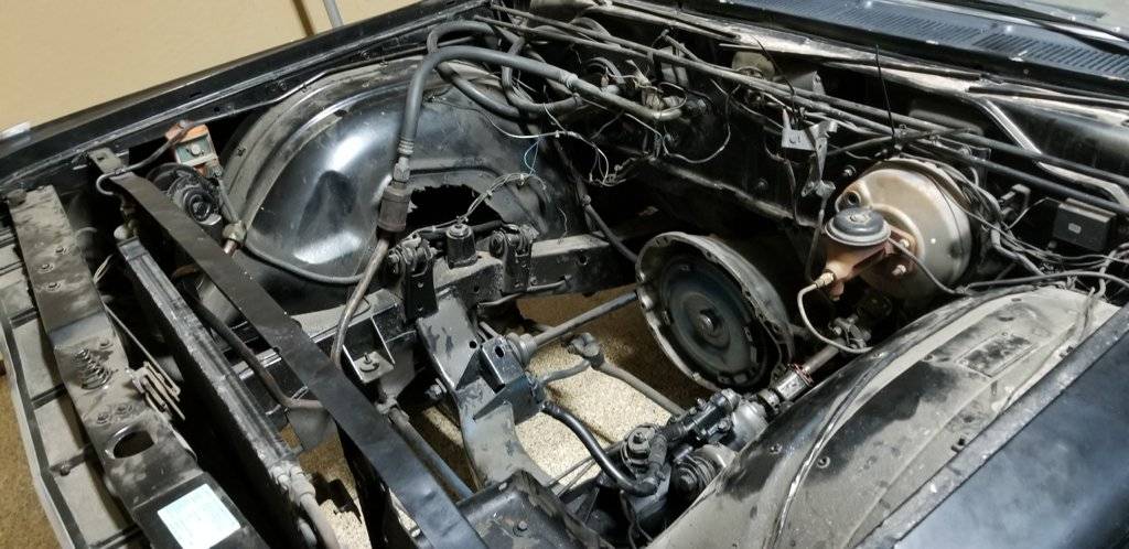

    Did a real quick teardown of the front brakes this morning. Big plans for the coming week, suspension wise

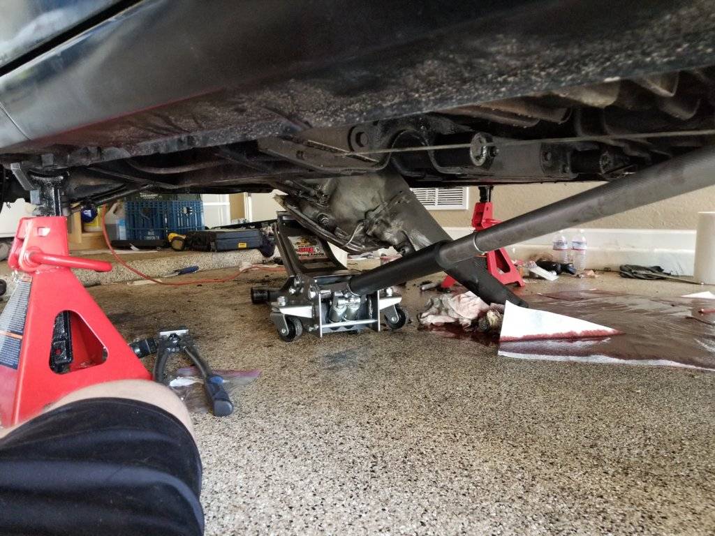

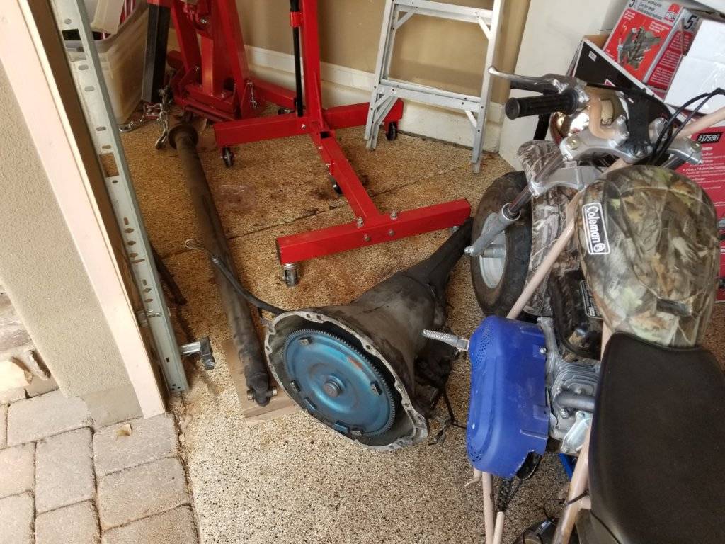

    Arizona

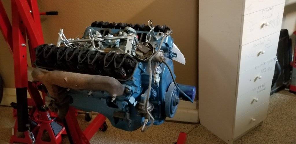

    Update. Front suspension is done done done. No idea if I'll touch the rear sus anytime soon, probably not. As I wait for my 383 to be clearenced and bored and honed etc I'm building the 727 to handle 496ci power. Just dropped the trans 20 minutes ago, not clean but also my first.
    • Like Like x 4

    As long as that's transmission fluid and not blood, you're doing fine.

    That torque converter has cast crank weights on it do not reuse it with them on there.

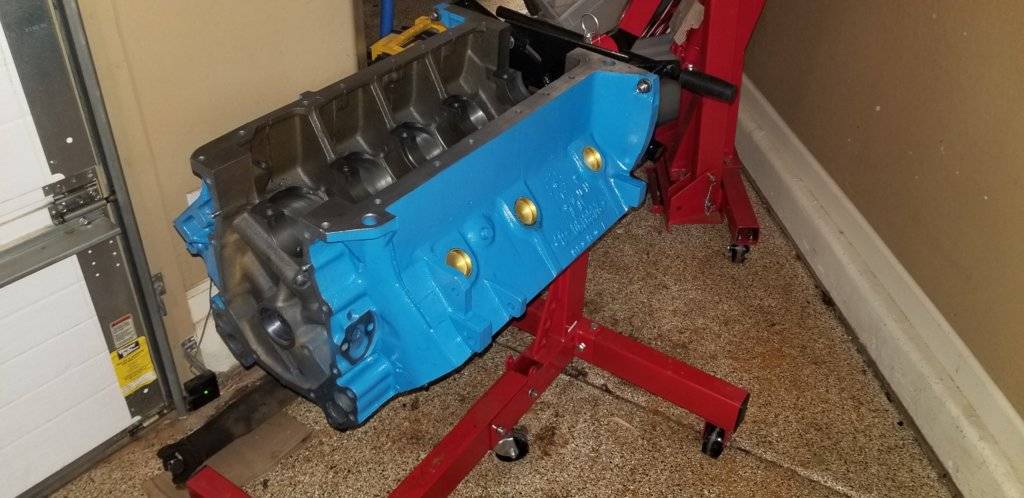

    Sprayed the 383 after having it clearanced. I didnt know a block needs machining for the use of main studs, and may be sending it back to my machinist once more. Grrrr

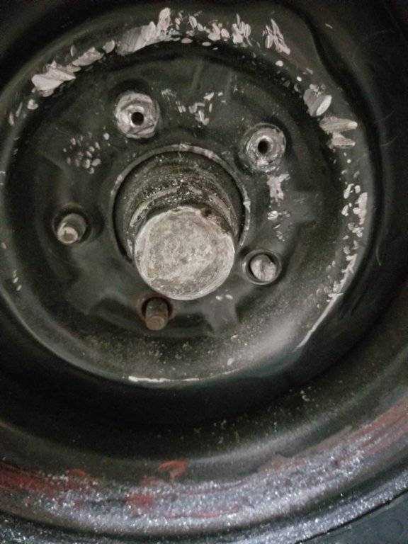

    Is this on the drivers or passengers side...…….?
    I guess you know the passengers side does have left-thread studs…????!.
    ( sorry , right thread ).

    That's the driver side. The issue has been resolved. It's the drivers side that has left handed threads on the studs, and that's what caused the problem, my ignorance

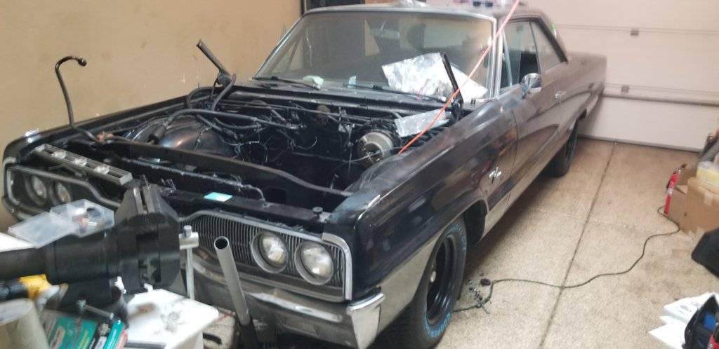

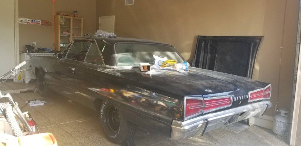

    I like seeing the dodges 52 years apart. hood is on very temporarily to hopefully disguise from the neighbors that it ain't runnin
