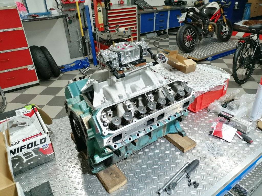

Hi,
starting on march 2022, our Polara will go to the paint shop.
A lot of work, but the base is realy good and I collected parts over 3 years.
Next week the block will go to the machine shop and after that I will order the stroker Kit from 440source.
Will use a CC XE284, modified Sidewinder heads, 440 roller rocker, Edelbrock RPM, mod 727, Hughes converter, etc....
The problem I have in the moment is to find suitable headers.
I wanted to have the Schumacher Hi-Flow Tri-Y Under Chassis B/RB Headers, but no way.... I contacted them and there is no chance to get them any more.
The second option is TTI - https://www.ttiexhaust.com/TTiC6573-383178.htm
I must keep the power steering (lol C-Body), but I can't live with stock headers (makes no sense with the calculated engine power).
Can and will someone recommend a different brand/type, that will fit in the car?
I had the same problem with the headers for our 73 duster (warm 360)... painfull installation and just a hair clearance for the steering column and the engine needs to be hard mounted.
I hope you can help me
PS... I'm from germany, so please don't judge any mistakes in the lines above too hard ;-)
AND.... if someone has a set of Hi-Flow Tri-Y Under Chassis B/RB Headers for sale, let me know :thumbsup:
And some pictures..... My Mopars....

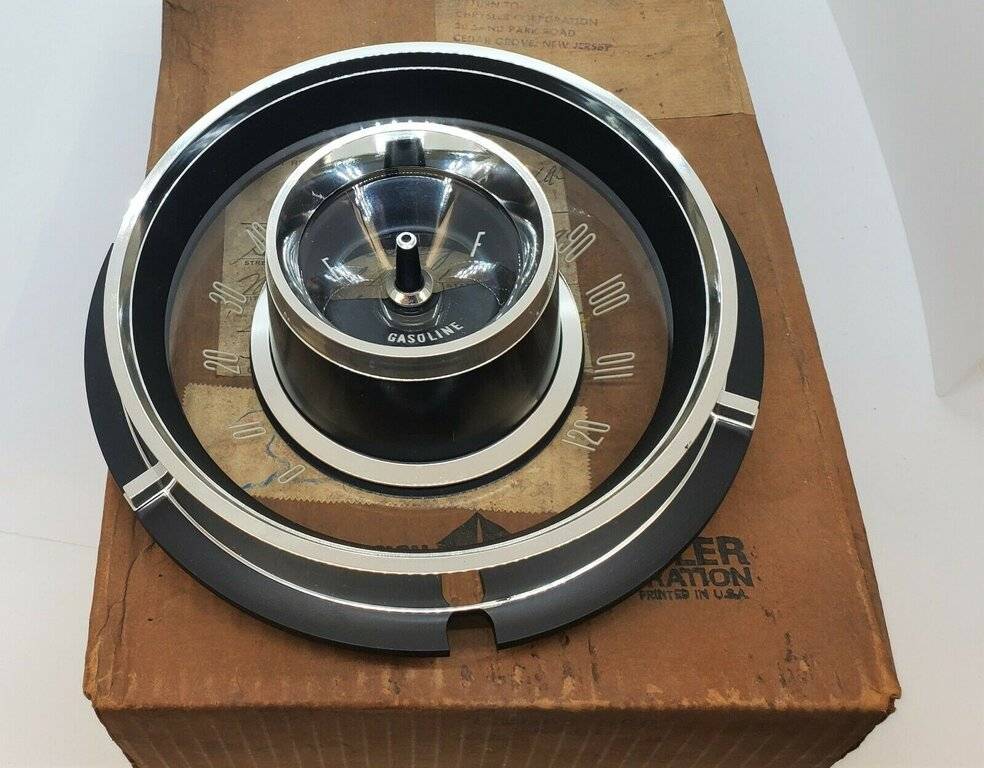

BTW, Santa showed up just before Halloween?!?!
He had a real nice gift in his a sack for me - searched for it since 1,5 years :D
Hope to find the bezel for the other instrument, too.

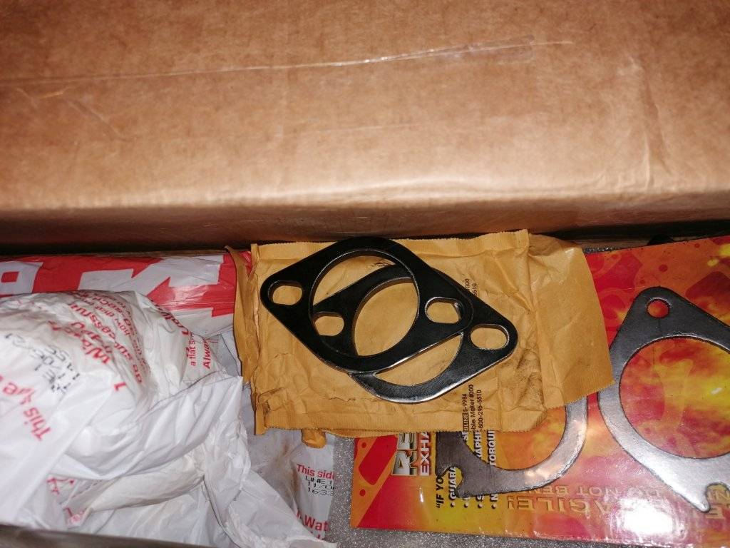

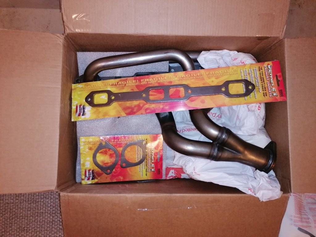

Hi,
a happy day in Germany..... yesterday I ordered a lot of parts from 440-Source, including the 489 Stroker-Kit (Kit + 34 other parts) -ALL AVAILABLE!
And today I received the package with the Tri-Y headers.
Hope the whole project can start in April - a lot of work, including paint job, brakes, seats, etc.
I just put the parts together to check some mechanical things and once, the pistons have arrived, the block is going to the machine shop.
A good start for the weekend :)
