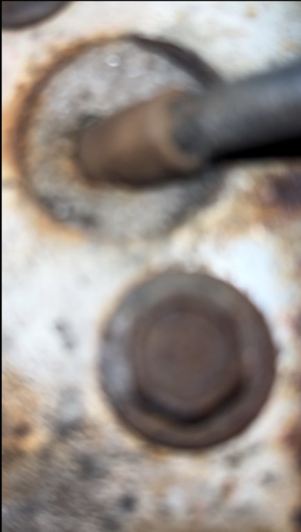

I think this is the problem. It’s a tight spot but this was the best picture I could get. Should there be a rubber grommet into the firewall there?
There should be and it may be there behind the foam.
The cable housing at that point should have little to no movement. The grommet may be worn out or the clip missing.
Alan
Alan
Thank you, I really appreciate it. I’ll check up in there for it. If not, is the grommet reproduced or is it the same as the speedo or park brake one?

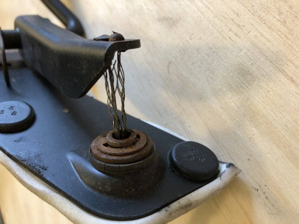

This is a picture of my Barracuda, yours is basically the same, you can see the grommet just under the rusty washer and clip that holds it all together.
Alan
Honestly I'd start looking elsewhere, you may have a rust hole or a crack in the sealant.
