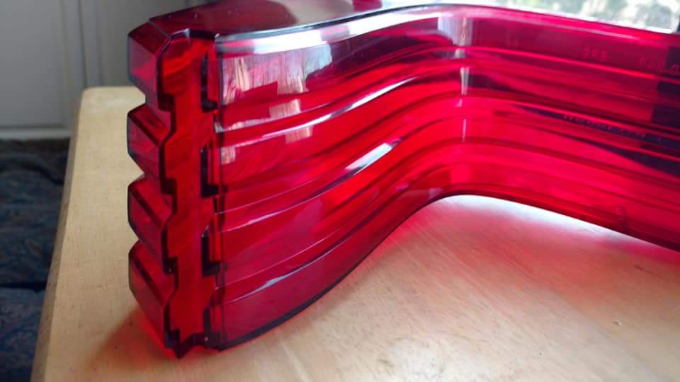

1966 Monaco Tail Lens Casting

The Smooth on products have a Crystal Clear product that has UV protection. It will have tiny bubbles if you don't put it in a pressure pot. Crystal Clear™ 200 Product Information

I may very well do that. I've already got the molds so I might as well use them. What do you use for your pressure pot? I've only got the vacuum pot.

They are a Urethane resin I am very happy with the durability and color retention so far. I have left a lens inside my car all summer just to see if I can see any change. None found.
The pressure pot are expensive. There are crappie ones on Amazon, California air, that can't take the pressure. The only good ones are Binks. I was lucky to find a 15 gallon on Ebay. You need at least 10 gallon to be able to make anything .
Interesting, I always thought urethane didn't do well in UV applications.
That's what I was afraid of. I knew they'd be crazy expensive, which is why I was hoping to avoid it through the use of my vacuum chamber. If I didn't have as much invested in these guys as I do, I'd probably just buy a set from Layson's.
This is why I made the investment, I looked for for 5 years finally found NOS, this is the lens I made from it.
Well folks, as stubborn as I am, and as much as I hate to admit defeat, I think I'll be ordering a set of lenses from Layson's. For anyone who may be attempting what I did, I'd still say go for it, but verify your tolerances/sizes before you get too deep... Effectively what happened with my lenses was that I used my molds too many times, and with each iteration of making a part (because the previous one had flaws) my molds were shrinking. I finally got what I considered an acceptable part, right as I ran out of resin. I went to fit everything up and I had MASSIVE gaps between my trim and cast pieces. I'm a little disappointed, but I'm glad I ventured out to try it. Now I'm looking into making some cool parts elsewhere on the car. I'll start a new thread once I dream up something else.
