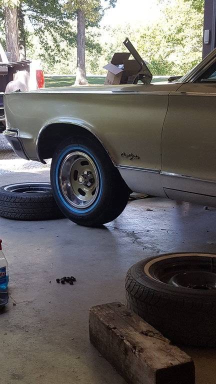

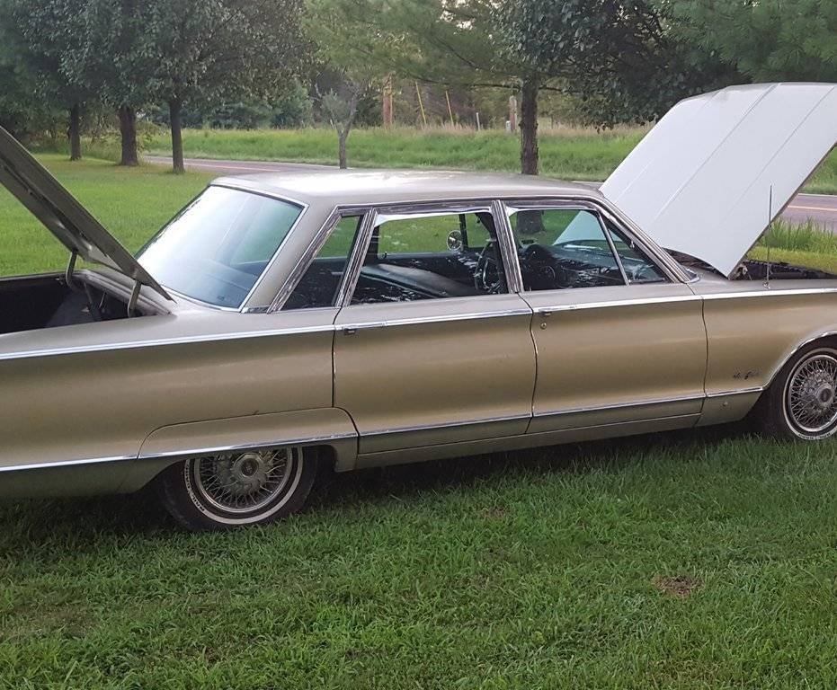

So i decided a formal build thread would be good. Wont be completed until spring time is my best guess. But here it is. Starting with a 66 new yorker with clean interior clean exterior ran pretty rough. Motor is half apart and getting ready to head to the builder. Transmission is almost done. Updating to front disc brakes and redoing all the lines and rear drums. Got some swap meet wheels powdercoated to match the car and some new cheap rubber. Enterior is original and in excellent shape and will remain untouched aside from a floor nounted cable shifter. A lot of parts stacking up with much more to go. Ill post later to update the plans on the engine, and specs on transmission
Welcome to the site. Nice car. You will find a vast amount of knowledge here. I have done the same things to my 1966 300. I know what mistakes not to make again.
Agreed - nice car, rare too being a 6 window sedan. Wheels are VERY nice!

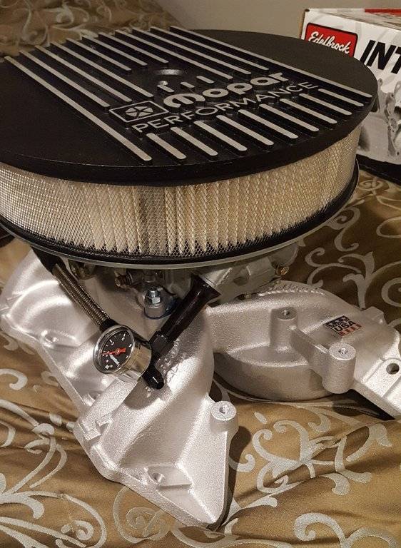

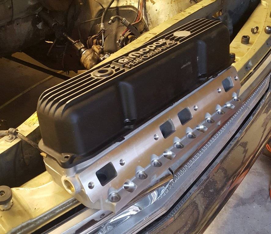

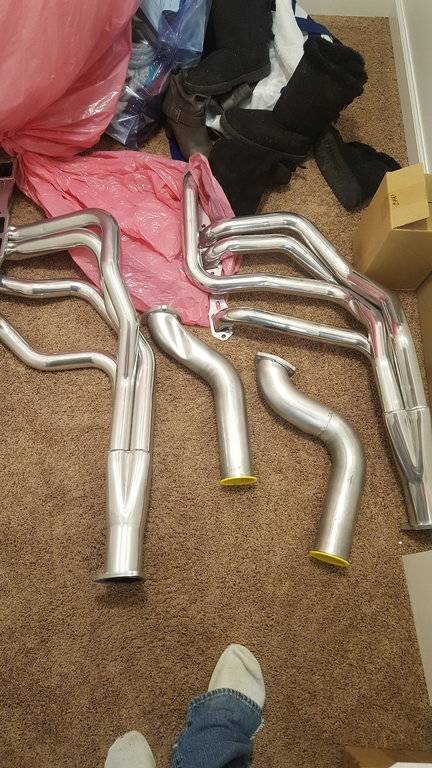

The centerpiece of the car will be under the hood.(i hope, we will worry about fitment later) so i already have stealth heads, performer rpm, 850 holley, roller rockers, tti headers, aluminum water pump and housing, all the arp hardware, hv oilpump, billet timing chain. Met with the engine builder yesterday and for my goals, and budget we have decided on a 493" stroker around 10:1. Will get more solid numbers one he confirms the 80cc advertised heads. But in thr 10:1 10.5:1 range. The rotaing assembly, cam, and engine assembly and dyno is all in his lap. Hoping to see 550hp on the engine dyno

I didnt the polished ceramic coat hurt enough. Ill go to the local shop for the rest of it. I was happily surprised the included collectors got me past the crossmember. All easy from there
