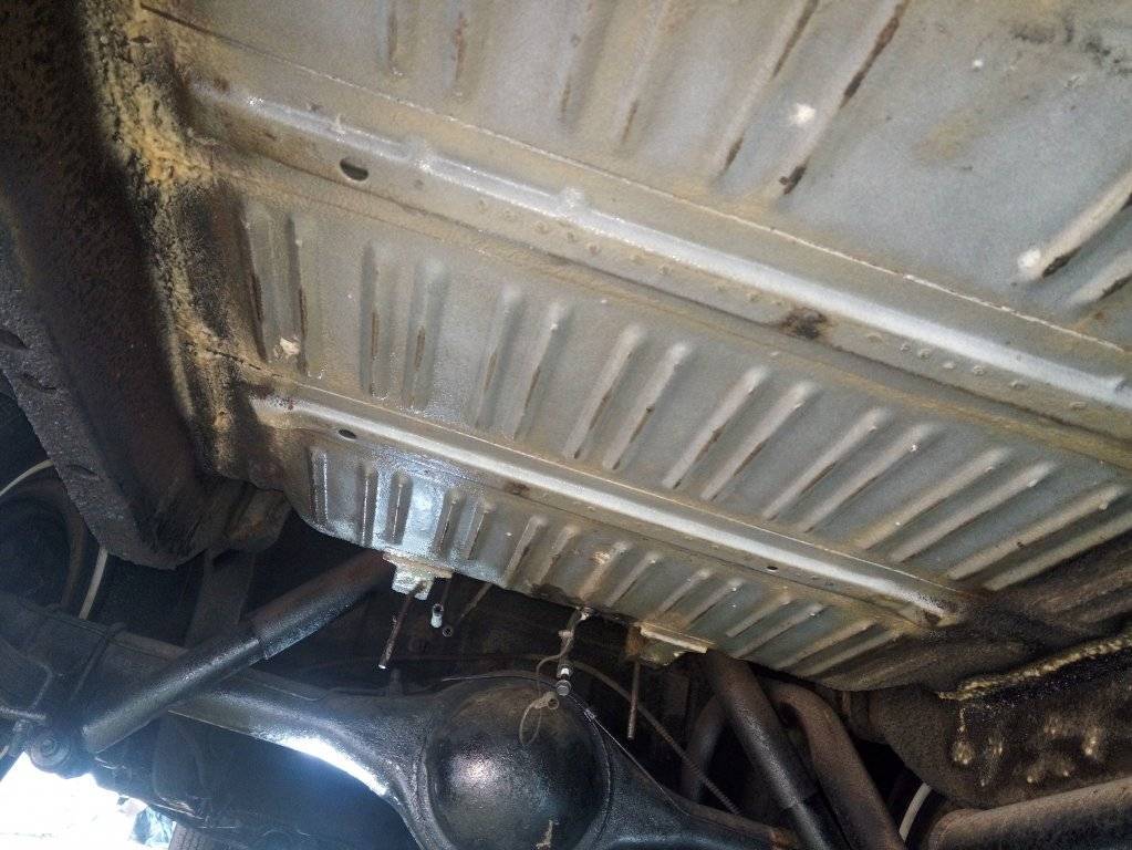

Looks like the rear fill grommet is shot and the bottom of the tank had bedliner sprayed on and may have rust behind that. I'll take it to the local gas tank repair place and see what they think.
Screw it, I ordered the CR20b/sender/grommet and straps. I'll make another thread on the install when it arrives.
It's not worth screwing around with a repair of this tank.
Yesterday i went for a ride and my electric fuel pump got an air bubble in
it and got stuck at a busy intersection, Cop was able to push me into an autozone parking lot and i was able to get it going. As i left
the lot i was on an uphill waiting for the light and when i accelerated my daughter in the car behind said a nice gush of gas leaked out
at the rear grommet area.
I installed the CR20b and it works fine, Only problem is slightly intrudes on shock area. Stock shocks fine but air shocks would be tight
and need some sheet metal bent away first. No rust, only fluid film sprayed on.

Glad you made the SMART decision! I've got the CR20b on my '66 Newport 2 door, with Monroe air shocks and a single exhaust for the 383 and everything fits very nicely. I plan to replace the sending unit IFF a 70 Ohm 12V fuel gauge won't work with it. There are several "universal" sending units which will bolt up to the tank and allow you to pick the impedance and voltage of the fuel gauge. Now iff a working NOS fuel gauge falls from Heaven onto my porch, I'll sing Hosannah and a Gloria in Excelsis, but barring that, I plan to modernize this portion of Mathilda's instrumentation.
