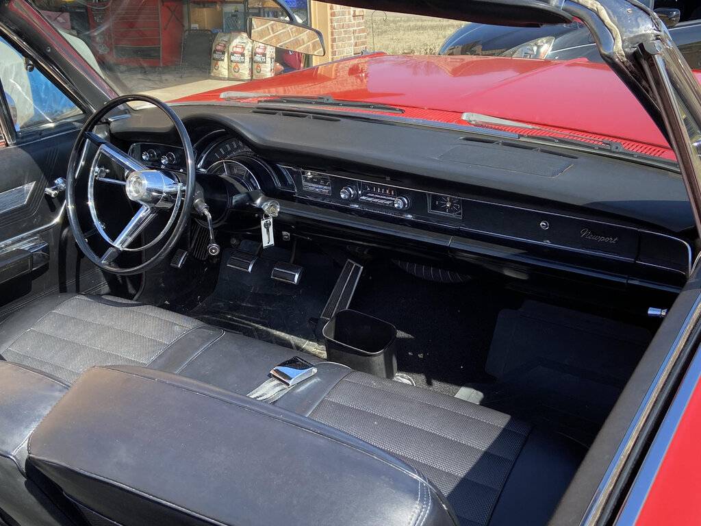

    Hi all! Just wondering how rare is a 1966 Chrysler Newport Convertible with 3 on the tree. I purchased this car from a used car lot in Youngstown, OH in February 2021 and that's the reason I bought it because of the perceived rarity. Very low on options. I have a copy of the original window sticker which shows the few options are power steering, padded sun visors, retractable seat belts, deluxe wheel covers and the Golden Tone AM radio. Standard 383 2-bbl and a 3.23 geared 8-3/4 rear end. It seems all original except for a repaint. Vinyl seats and crank windows. No air. Showed 43,000 on the ODO when I bought it, about to turn 45,000 now. Don't know the history, could be 145,000 but doesn't seem likely. Even though it's an Ohio car, it has no rust. Any production numbers out there?

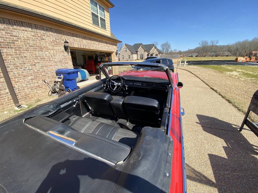

    As requested, more pix!

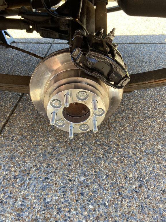

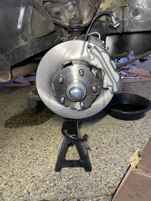

    Beautiful pictures! I bet that black interior is hot after it's been sitting out in the sun for awhile. You have a 66 Newport sedan too?

    You don't mention it, but those disk brakes aren't from the factory. I'll bet it stops well though!

    Yeah, I was driving it back to Memphis from Youngstown, OH and when I would hit the brakes, it would jump into the right lane so the first order of business was 4-wheel disc brakes! It had manual drums. And it does stop nice and easy now! The only problem was the rims were made for drum brakes so I had to add 1 inch spacers. That's what you notice on the rear discs. The front disc picture didn't have those spacers mounted on yet.

    You're the second person who has said that. When I converted my car to disks I was able to get rid of the spacers. Are you running 14s or 15s? I have 15x7 Torque Thrust Ds and no problems. Was running 15x7 Shelby Cal 500s, also no problems.

    Those are aftermarket rims designed for disc brakes. I have the original 14" steelies with hubcaps. Not designed to clear the calipers. I guess since drums turn with the rims they never had to worry about clearance.
