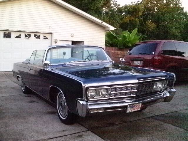

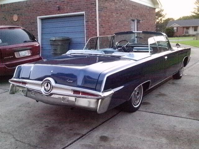

I went through the same issue a few months ago, Same Color "Regal Blue Metallic" I settle for Axalta (Dupont) Nason because Centari is obsolete. Went to a major body shop supply house with my codes and No Dice. The paint man couldn't locate formula. I had several codes He called another location and got the nearest match which was for a 1980 Toyota,(GASP)
I had the car painted and I am Very Happy with the color. Let me know if you want the that code. It was for Nason Acryllic Enamel.

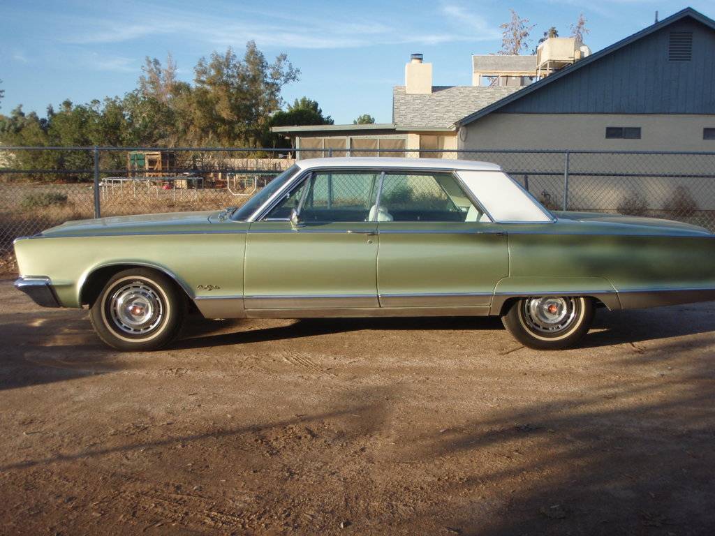

My 66 is F1 Haze green. While I found some formulas for it none of them were a type of paint I wanted to use. I wound up painting it with the 2006 Mustang retro color Lime Gold. Very close to the original color with more vibrance due to the newer metallic being more three dimensional.

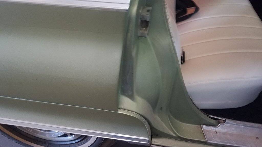

Do you have any comparison shots? That the color of my Monaco, and I'd love to see the difference.

Here is a picture showling the door jamb that wasn't painted. The picture shows the exterior a bit golder but and it's not, just the lighting. I'll try to pull it outside later to get a better shot.
Imperially , Gary. View attachment 203261 View attachment 203262
Sure, i would love to have the code if it isn't much trouble. I didn't realize it was a 2-year only color. Thank you all for the help.
