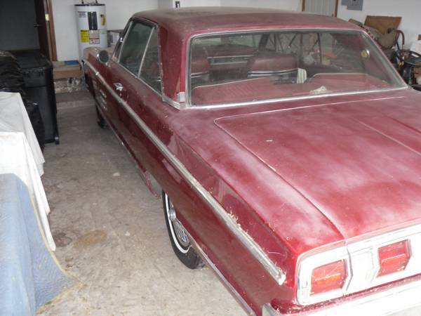

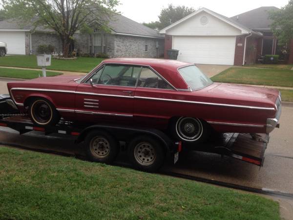

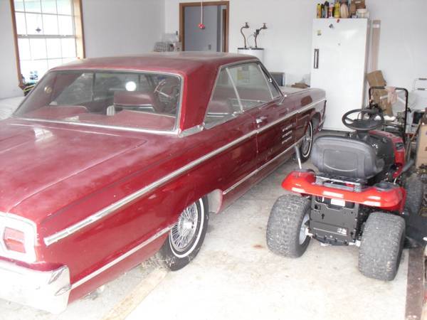

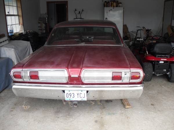

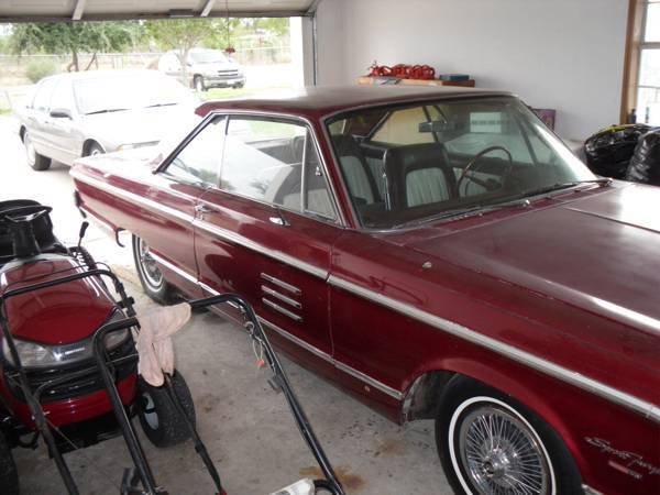

Here is pictures of the car when we went down to her grandfathers house in South Texas to pick up the car.
