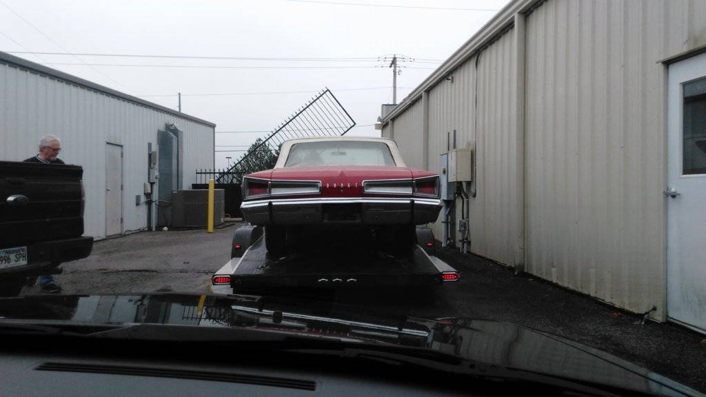

Two weeks ago I looked at the car. It wasn't perfect but it was all there.
The PO really hadn't driven it much over the last couple of years, and probably did even less work to it other than keep it running.

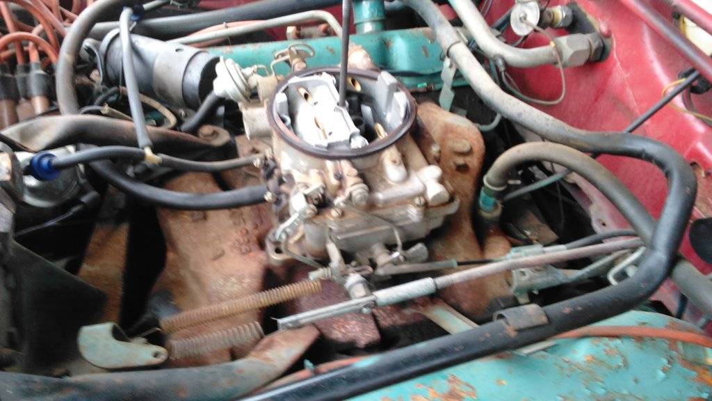

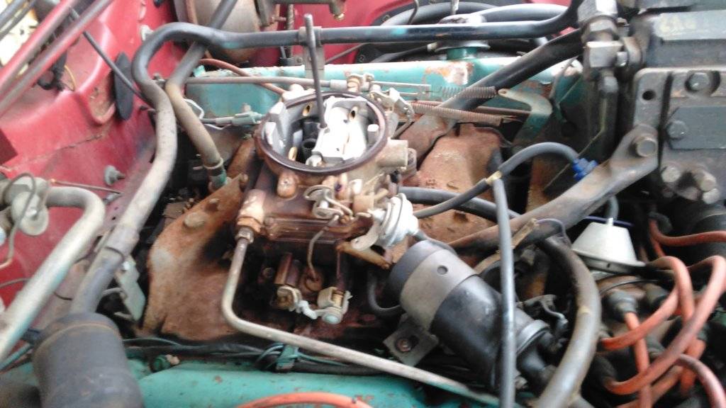

Strangely, it's an RL price code car but has a drivers power seat, AC, Tilt tele wheel and floor console. I posted earlier that the engine was a G code 383 2 bbl, but...Surprise! When we pulled off the air cleaner, it was a Carter AFB on the correct low rise. I've since found evidence that the G code could be either a 2 or 4 barrel carb engine.
It wouldn't start but turned over...however when we got it back to a shop in Tulsa, we were able to get it running but it would not stay running...seems like maybe a collapsed or cracked rubber hose hose somewhere. My Mechanic is a die hard old school Mopar guy, it'll run.
After my mechanic gets it running, aligns it, and thoroughly inspects the brakes, I will post more photos of problem areas.
We will be upgrading to the dual master cylinder soon.
Looks like belts, hoses, and perhaps that funky idler pulley for the water pump , along with a return hose for the power steering
It also appears that the temp sender isn't hooked up.
This looks like a nice solid find. If it wont stay running, put a fresh fuel filter on it and also put one in the input line in case the fuel tank is full of sludge from sitting. Or put on the new filter and hook the input for the pump to a clean fuel source. Carb might be all gunked up from moonshine fuel, but try the above first. Like the car.

It wouldn't start but turned over...however when we got it back to a shop in Tulsa, we were able to get it running but it would not stay running...seems like maybe a collapsed or cracked rubber hose hose somewhere. My Mechanic is a die hard old school Mopar guy, it'll run.View attachment 262936

Somebody has also added a smog style vacuum delay (blue valve) to the line going to the distributor, will probably run better with out it. Far as I know, all 383 engines were G code for '66.

Filter filled with gas, not the prettiest, but it's there. Clear style filter and pre fuel pump. My guy will have it running pretty quick.
Dave
Car was bought in Kansas in the mid 80's by POs brother. It went to San Francisco and was there until the late 90's. Po bought it and had it trucked to Michigan, drove it summers, then moved it to Arkansas. It has a CA smog sticker, so I'm guessing the filter and check valves were a Kalifornia requirement.

If the car was registered in CA, then that's probably where the delay valve in the vac adv line came from. Might be a few other additions, in the mix, too?

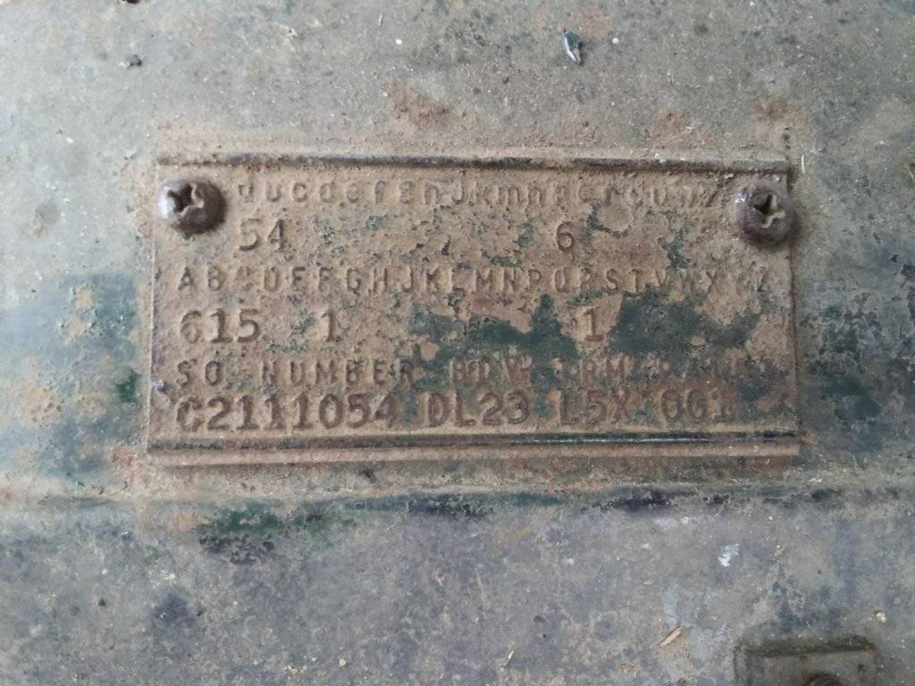

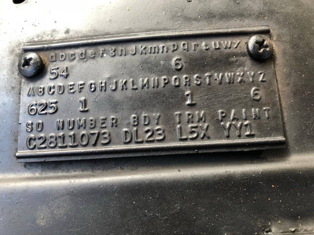

The Polara 500 was a 383 4bbl standard, the 2bbl was an option. Both shared the G engine designation. On the fender tag will be either 615 or 625 under the ABC option codes.
'66 Polara 500 383 2bbl
'66 Polara 500 383 4bbl
