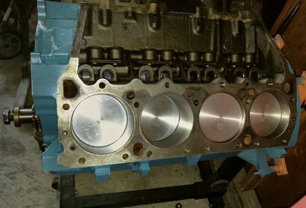

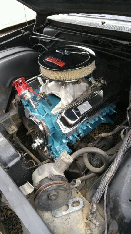

It needs a windshield, as seen above. It has a rebuilt 383 that has yet to be fired. I need to put some exhaust manifolds on so I can order up an exhaust system, leaning towards a 2.5" tti kit, I have the 3" on my other polara and I like it. Some other bits for the engine and I can fire it up and break it in, hopefully in mid to late March.

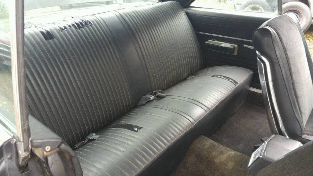

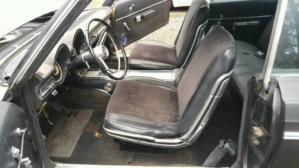

The interior is complete and has the funky carpet insert on the bucket seats. I thought it was a recover from some time back, but found out it came that way. I keep learning more about these cars every day. They hacked up the console for an aftermarket A/C unit. That will be going away and a replacement console body will go in. There is some minor damage to some trim on the driver's seat, a lens is broken on the console, needs the door lock knobs, and I'm sure some other little issues, which I should have parts laying around. (It helps to keep anything that might be useful off those parts cars!) I'll might swap out the door panels with my old ones, I don't think I'll use the radio, but who knows, and I don't like the speakers in the doors, just doesn't look right (thanks FCBO for turning me ever so slightly to the purists side).

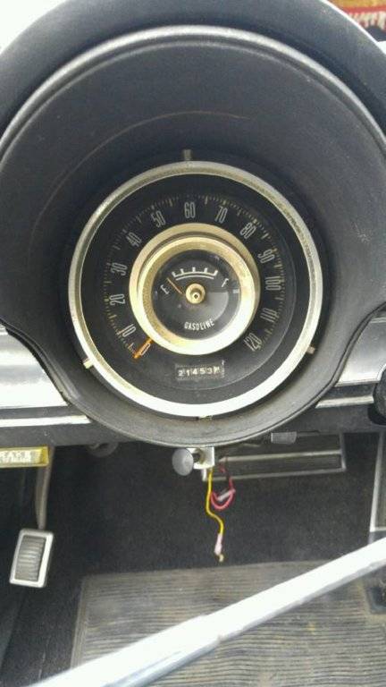

Odometer reads 21,453 and the body looks like that's an accurate number. The rear seat is in need of recovering, and the dash pad is cracked, which I have a spare.

Very impressed with yer Dodge. That trunk floor is just about the cleanest I've seen in a C-Body. And yer right: That knee knocker A/C has gotta go. Do you know anything about the engine? Stock or modified, etc. That original Bronze Poly paint color is an outstanding color too. I bet that car was a real looker.

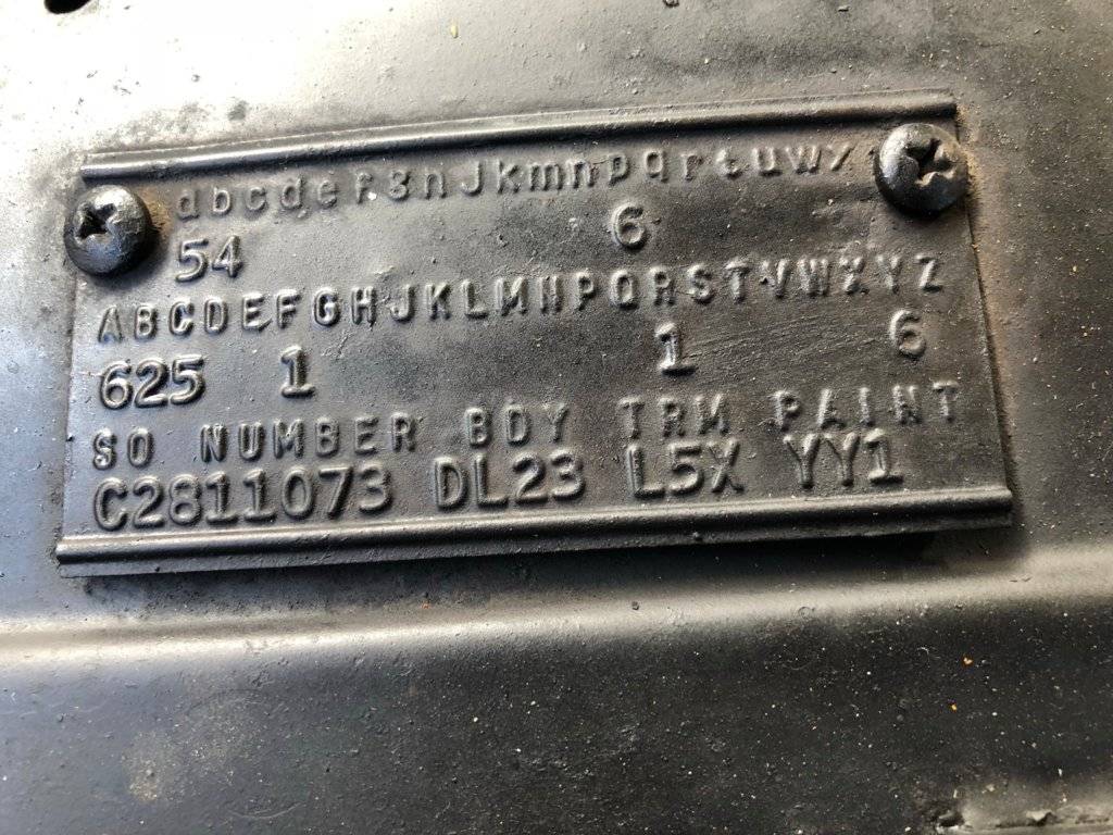

Did a decode of yer fender tag:
Production date December 28, 1965
Shipping order 11073
Car line DODGE Polara/Monaco
Price class Low
Body type 2 door hardtop
Trim Grade Low [32L]
Seat type Bucket vinyl [335]
Trim color Black [34X]
Paint 1 Bronze metallic [27Y]
Paint 2 Bronze metallic [28Y]
Paint scheme Mono tone paint [291]
Upper door frame paint (UNKNOWN)
Engine 383 4bbl HP 8cyl 325hp B [376/382]
Transmission Transmission-Torqueflite automatic [395]
Radio Radio-AM Music Master/economy 2 W [421]
Bucket seat accessories Carpets [485]
Front bucket seats Bucket seats [564]
Mirrors Mirror-outside LH remote [536]
-OR- Moulding-bumper reveal [546]
[Joseph Gabrey, DodgeCharger.org

I had @carrman go look at the car so I had verification of its condition. He just text me "This things solid, buy it!" He sent the fender tag and I plugged it in right away! Love knowing how the car was equipped.
