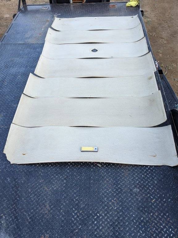

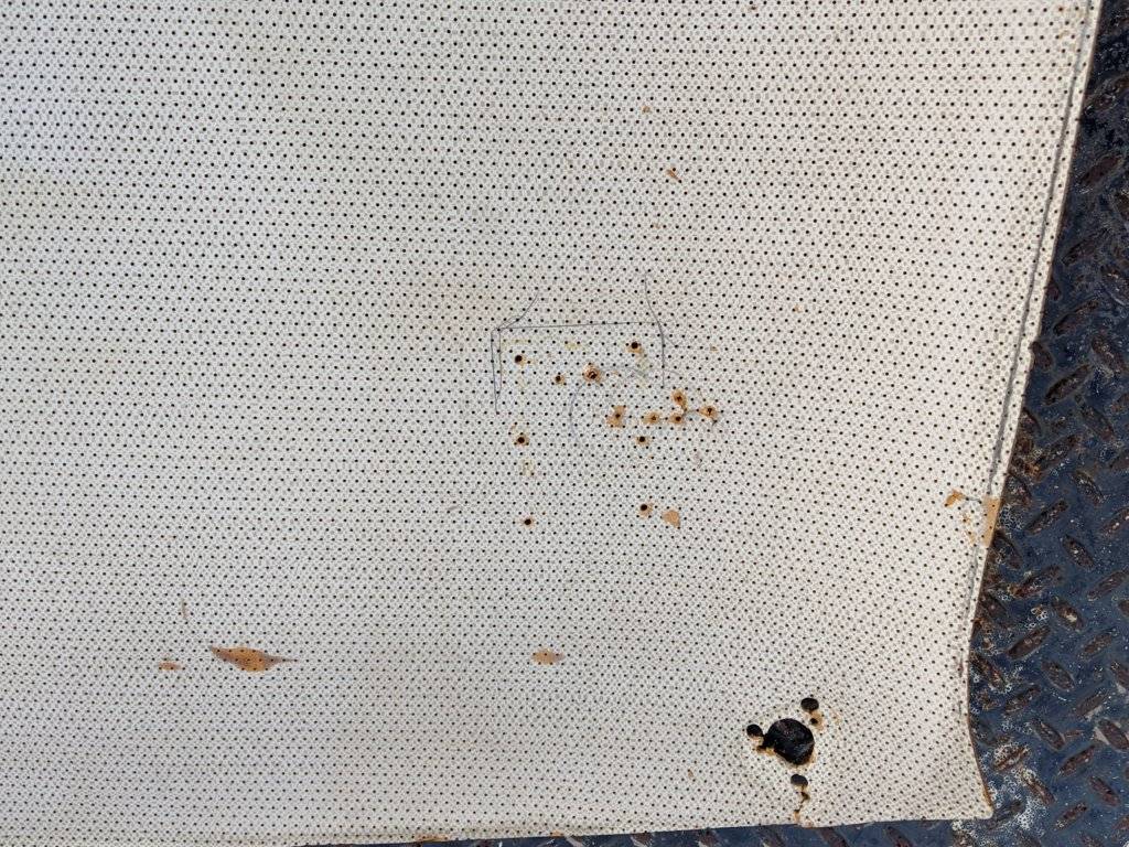

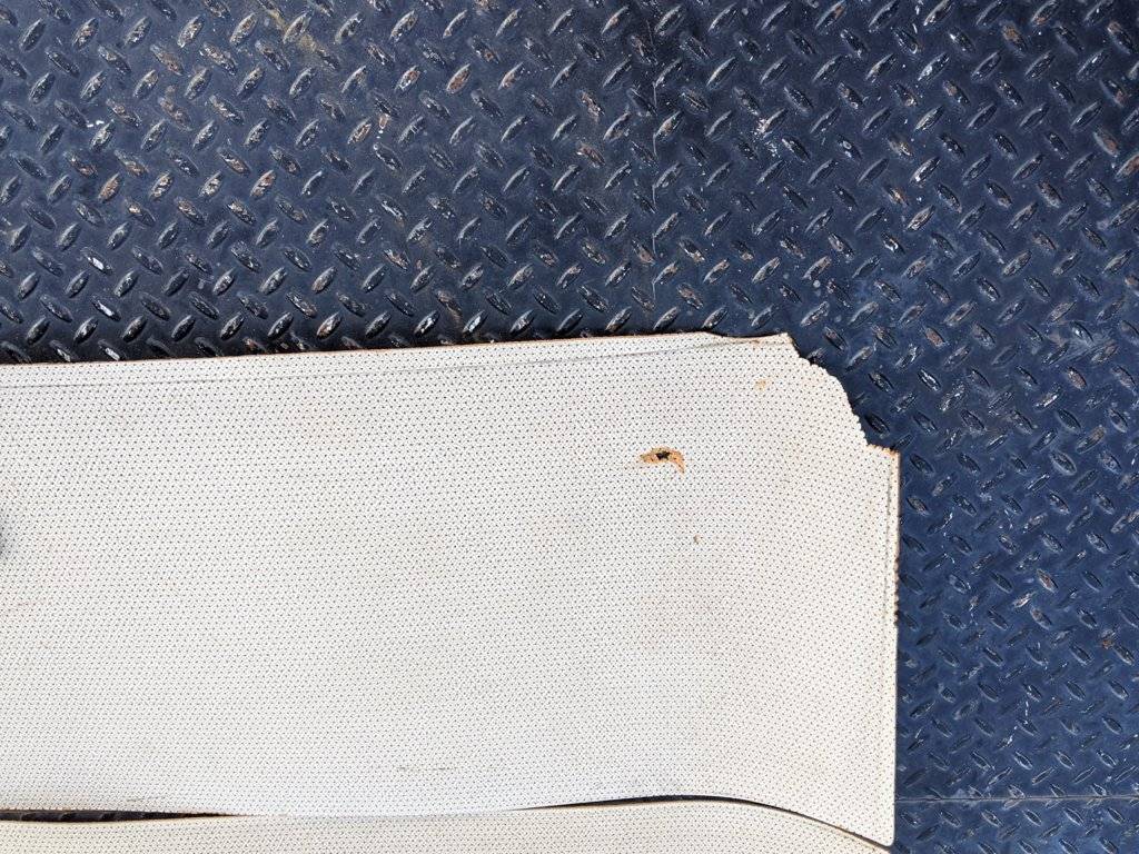

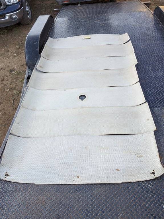

I hate the original perforated pressed cardboard headliners and although I am usually a strict original guy, not so in these two cases since I truly can't stand the original cheap stuff Chrysler used - it just won't last and I don't even like the look.

The only guy that reproduces the perforated hardboard that I know of is Mopar Mel and each section is $200 - so a 5 section roof would be $1000 just to start with the material (assuming your original stuff is junk like mine was). He also reproduces the plastic covers for the headliner supports for $100 each. So the cost difference is also very desirable.
