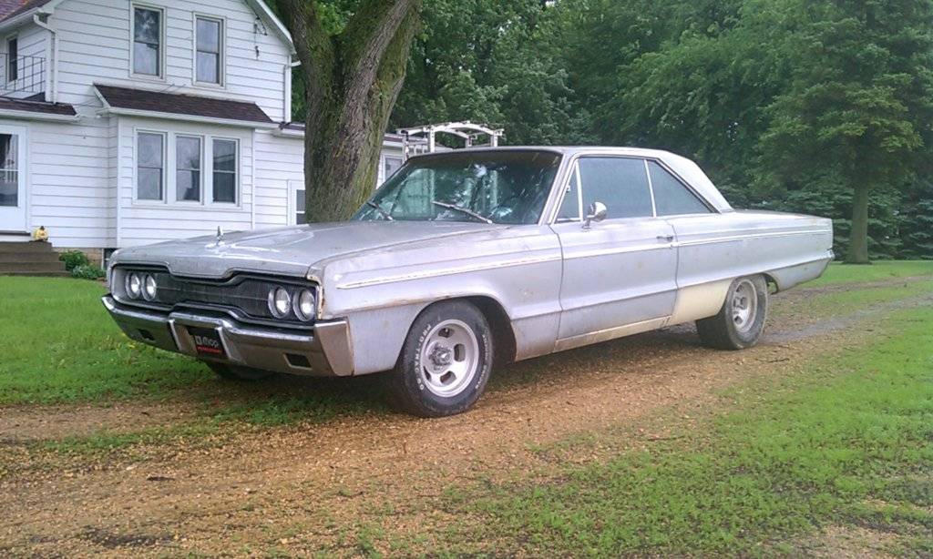

I'll post some pics up in a few minutes, but for those who don't know, here's my Polara:

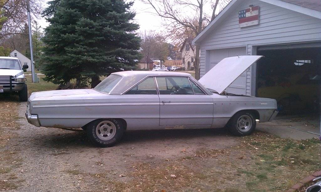

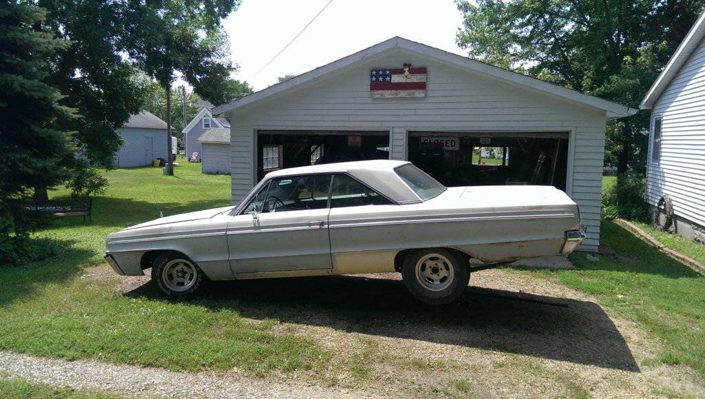

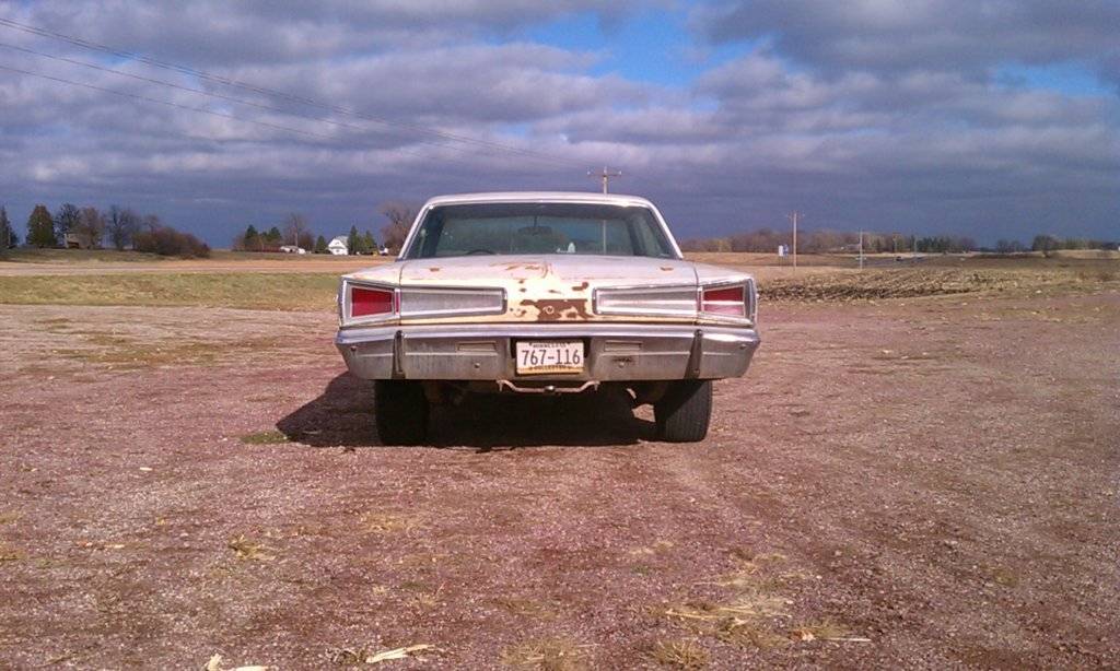

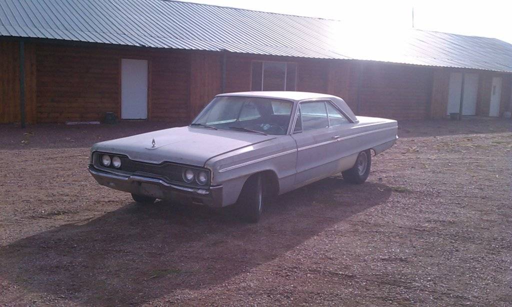

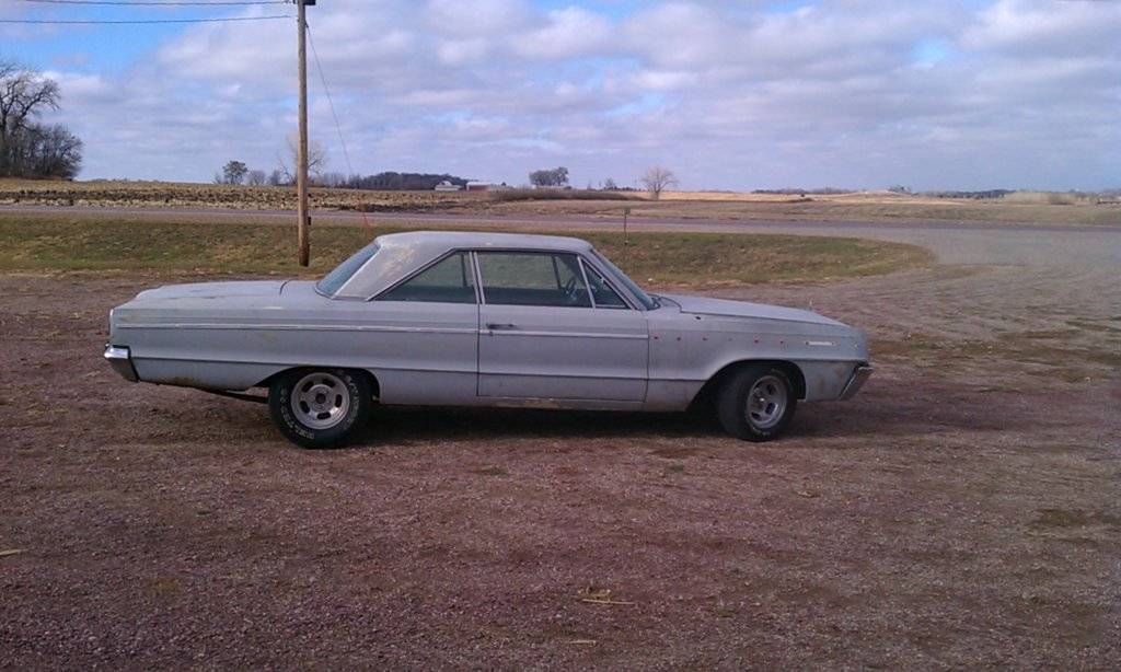

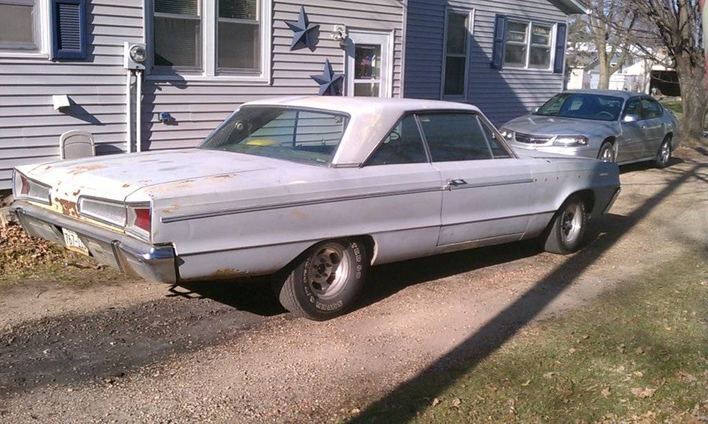

As I bought it, except rear wheels which were added right after I hit the first deer

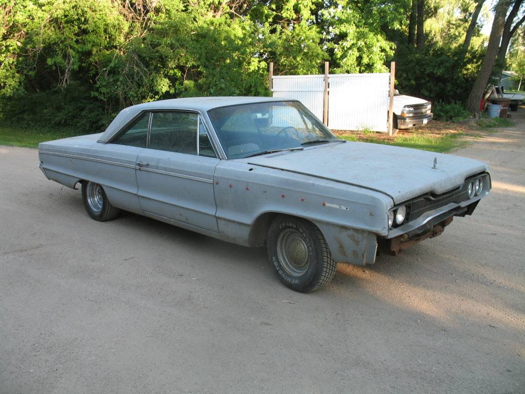

Stored hard the first couple of years, i never liked the feeling of it.

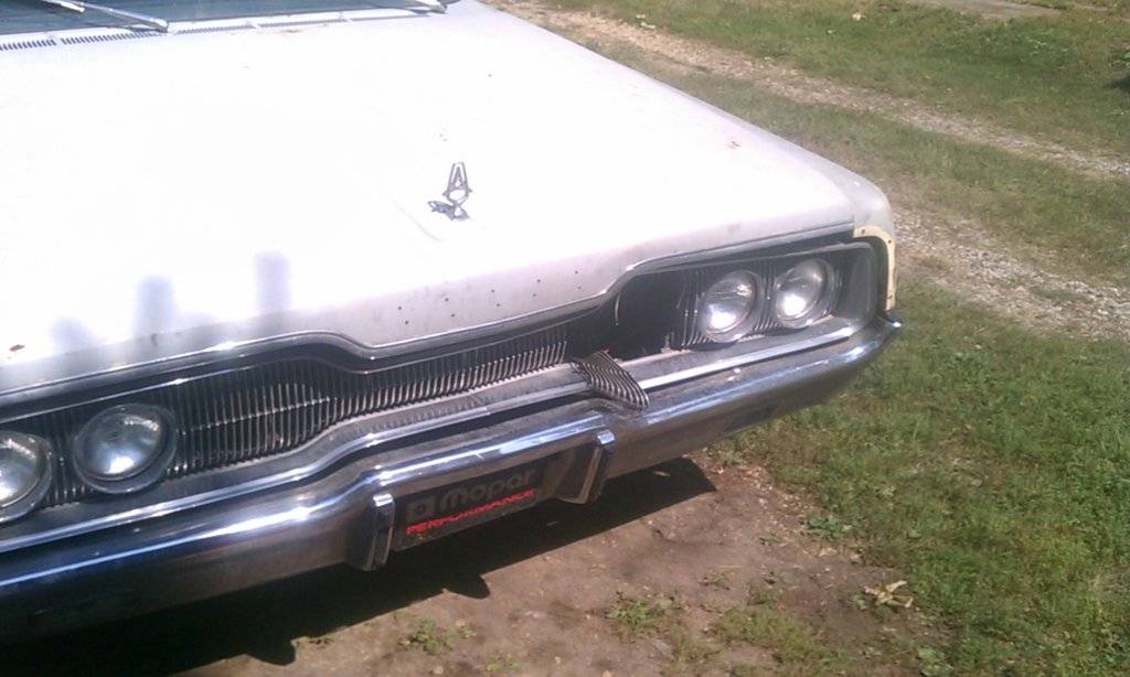

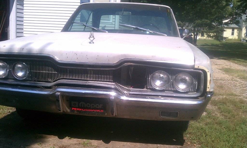

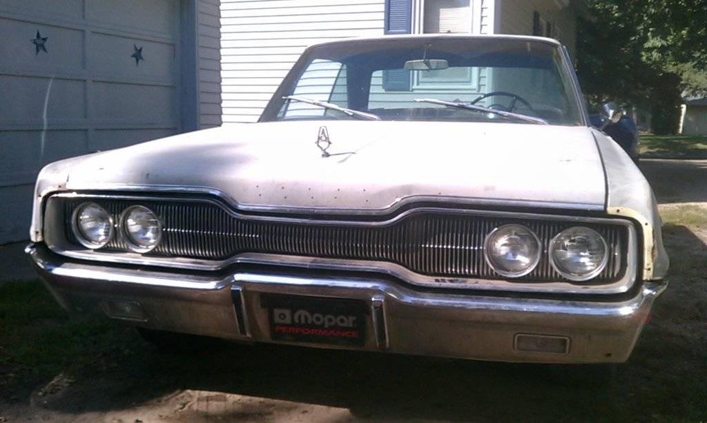

First bumper

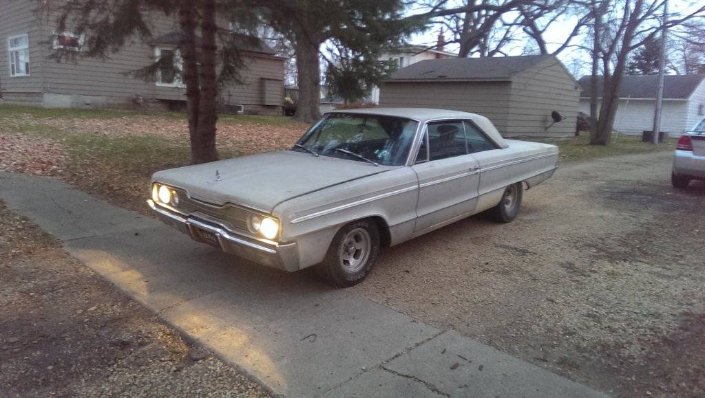

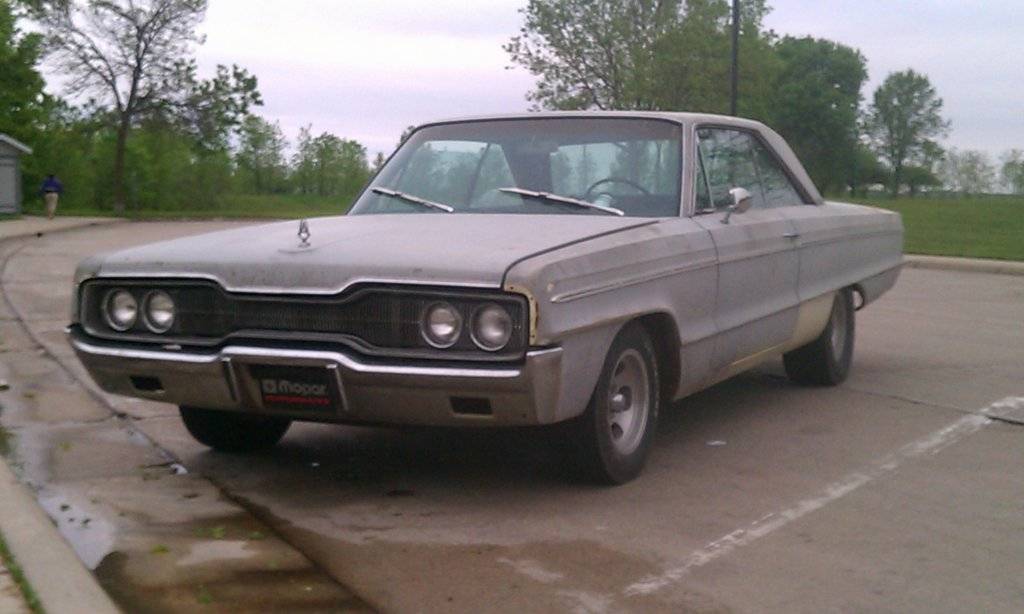

New home with new shoes.

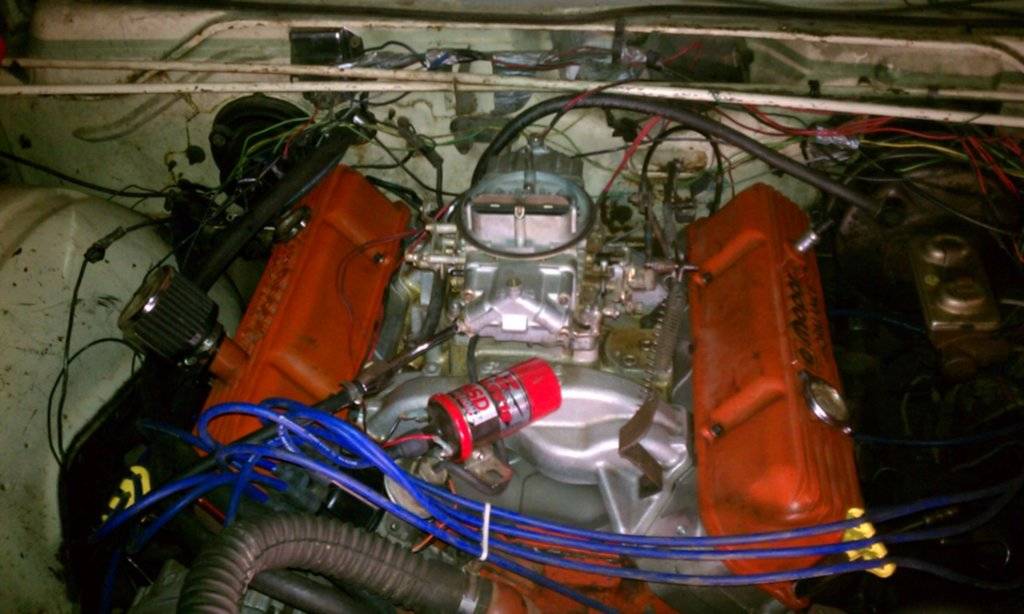

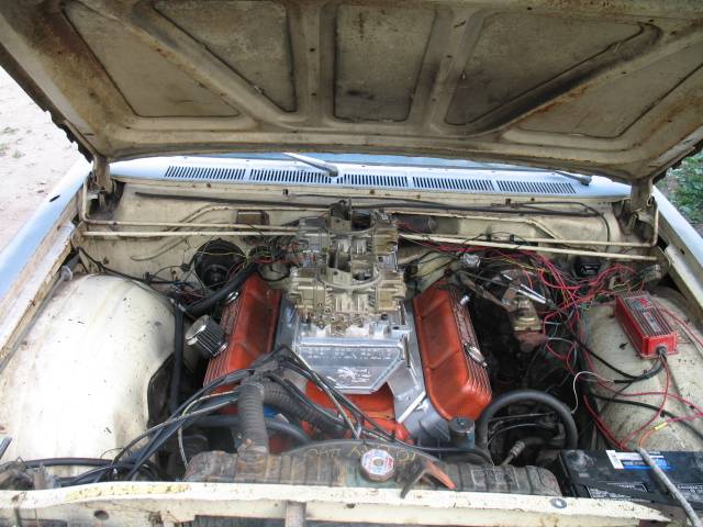

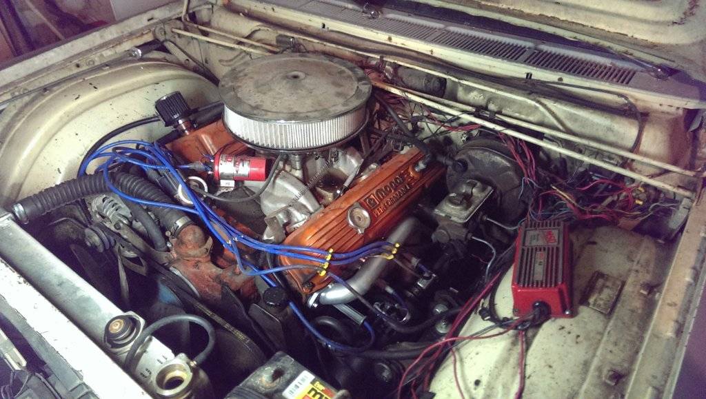

All put back together. Those Stealth heads look stock, right? Still running the Holley as I had no issues and it ran well, even though it's a double pumper.

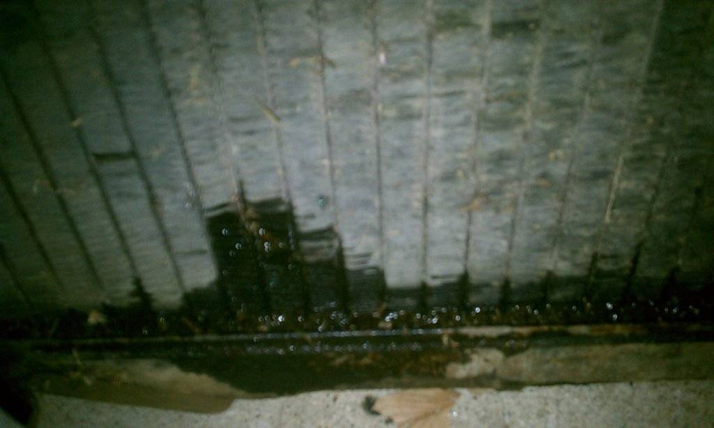

Aw ****, cant drive anywhere with a crappy radiator. Luckily, there was still a radiator shop in town, and after going there, i can see why it's gone, it was scary! But he fixed it for real cheap, and was honest it was only a band aid for a short time. It did get me through the season, just barely.

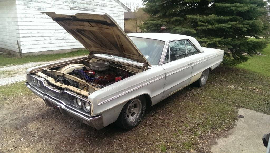

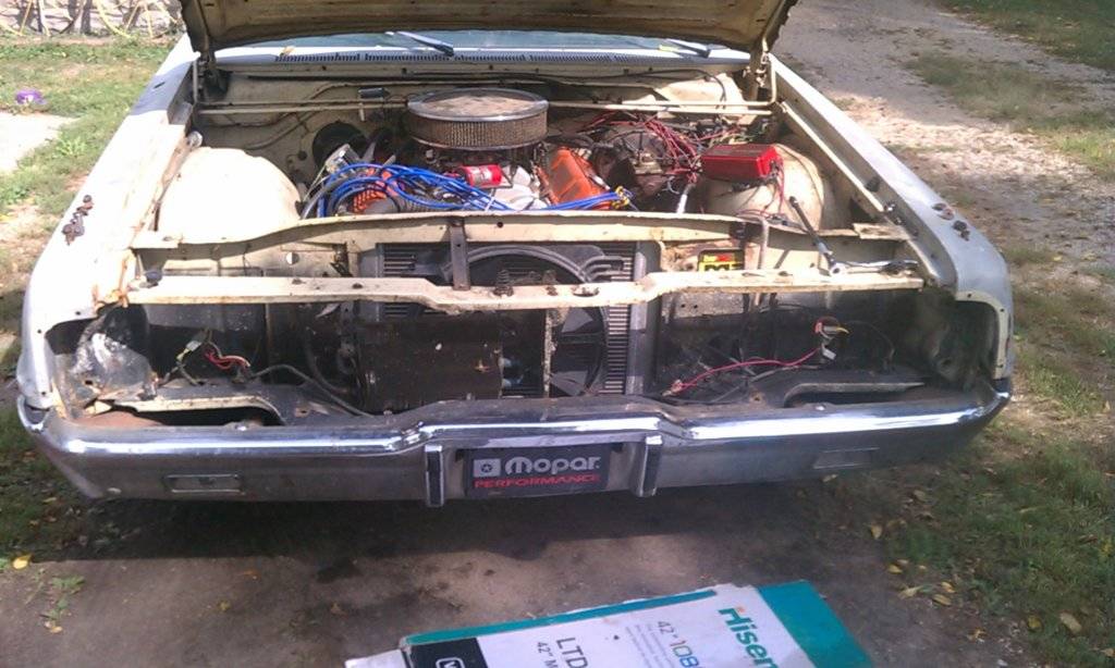

The joys of having a small two car garage. I had 12-18 inches to the front of the bumper to work with. I waited til April to replace the engine as I have no heat in that tinderbox I call a garage.
440 #2 in a month later.

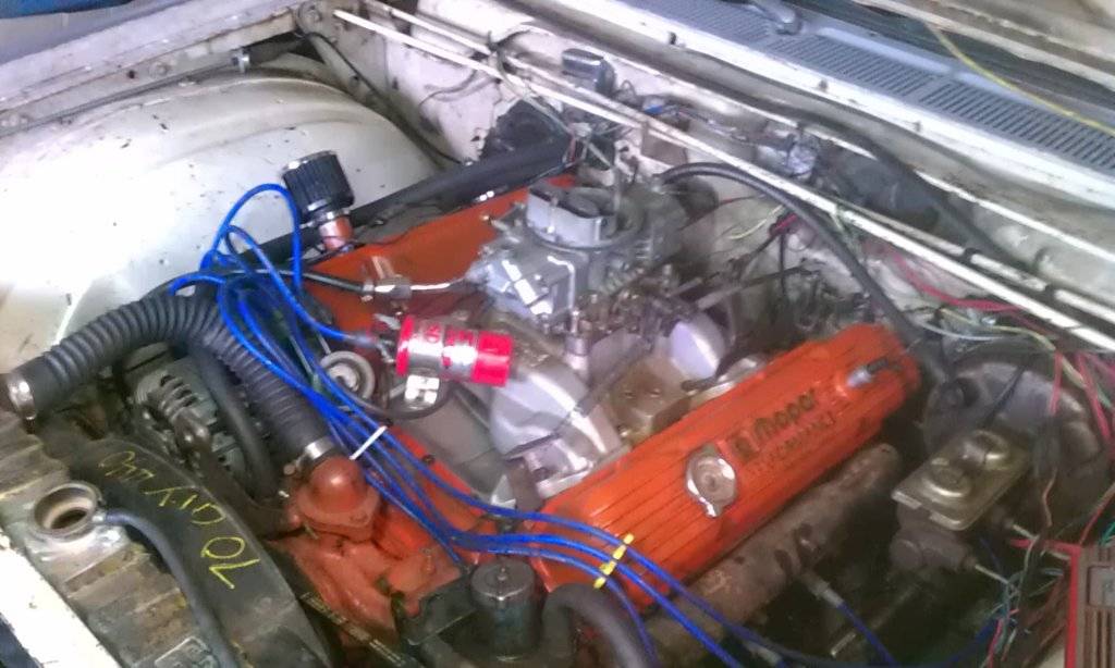

Back on the road again, sort of. I put in the .484 cam and lifters and also swapped in a 2500 stall converter. The car didnt like to run with the Holley, no matter what i did. I'm not the best at tweaking a four corner adjustable carb, so I swapped it out for an Edelbrock 750 AFB and got it pretty close. My mechanic friend who gave me the cam dialed it in the rest of the way.

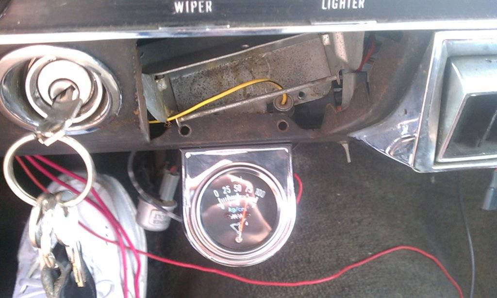

I added an oil pressure gauge, albeit a cheap one, better than nothing.

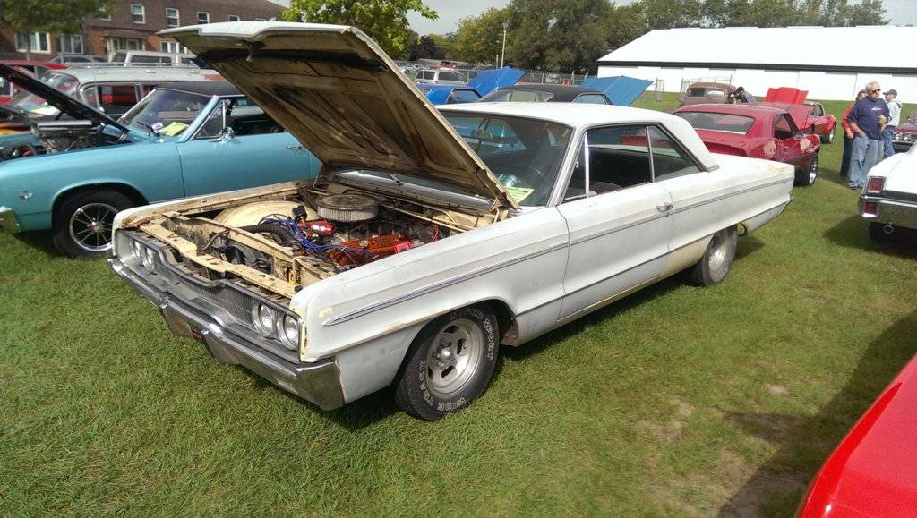

On the way back from the big Mopar show near me, Mopars in the Park. Ran great, even though I was nervous. By this point it had gotten too rough for Laura to ride in, the bench seat from an AMC was terrible and didn't help any.

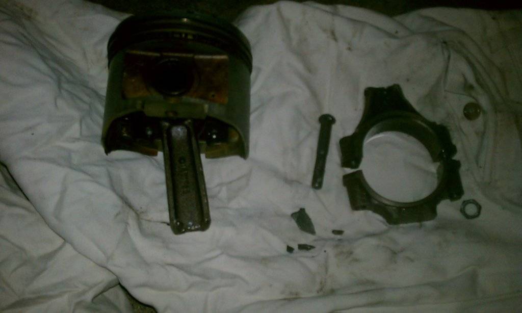

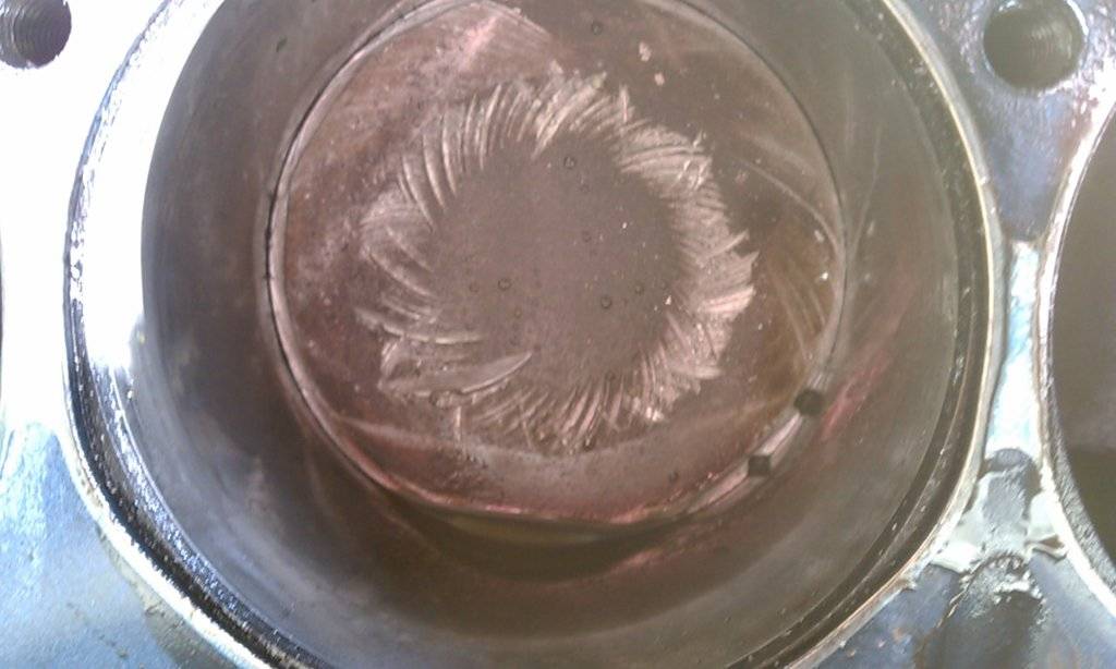

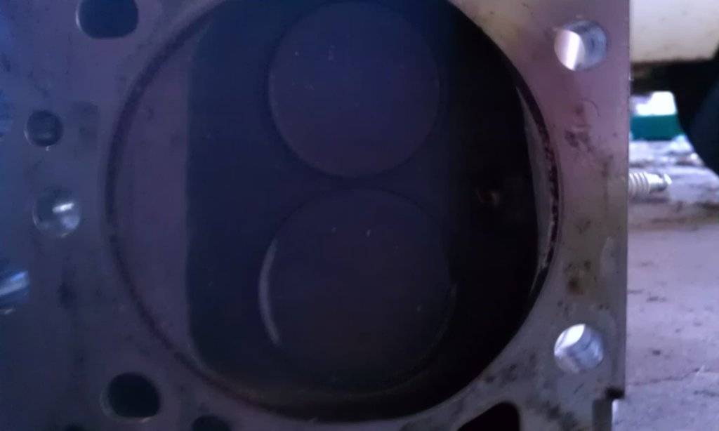

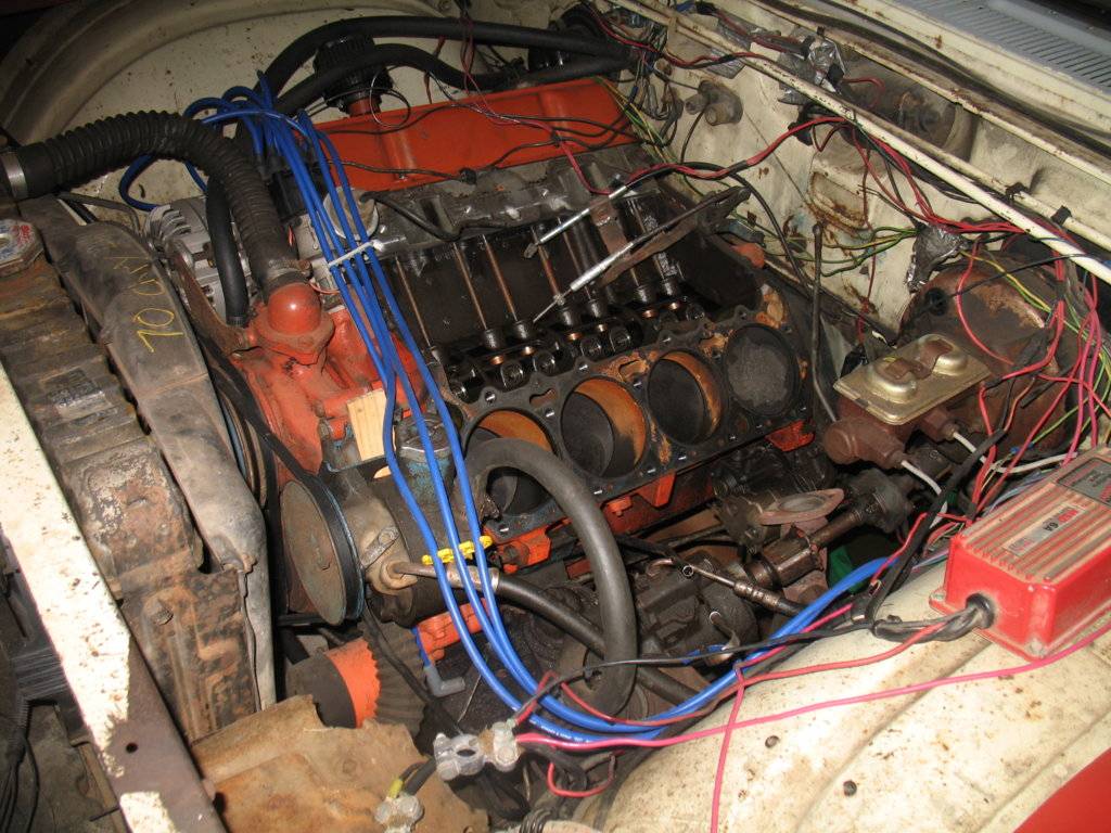

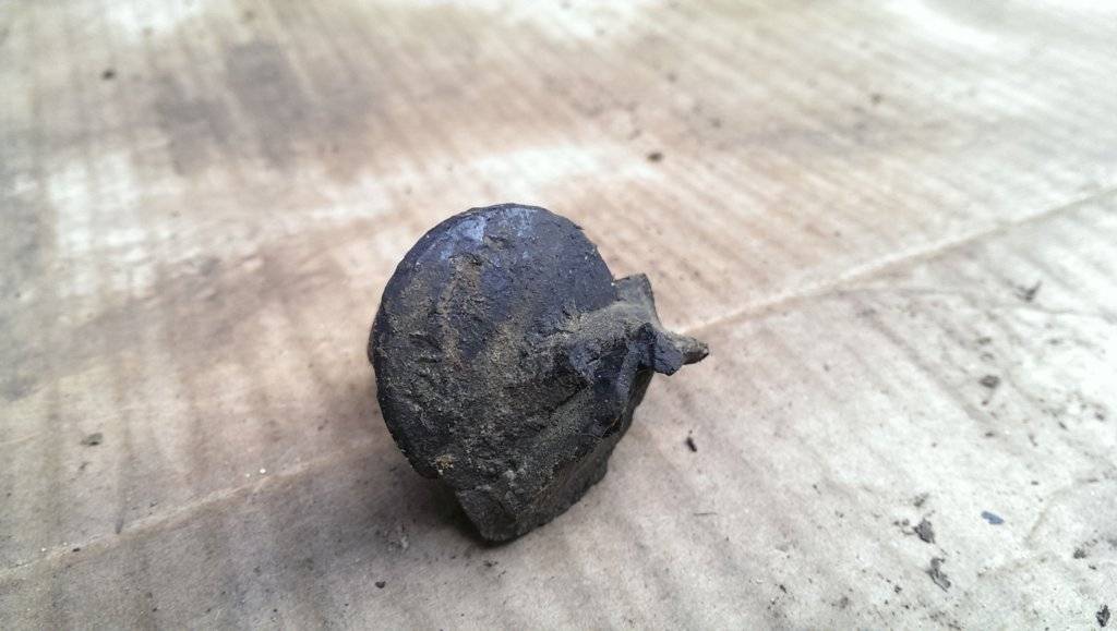

So after getting the car back on the road I checked out the old 440 for clues. This is what i found.
Bent valves in the Stealth heads, no good.

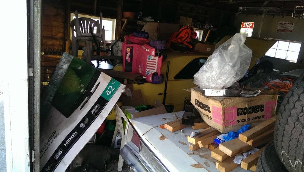

As you can see, thanks to limited space and outdoor stuff, and the kids stuff outside, the garage gets very cramped and the Dart and Polara become shelving. It sucks, it feels like admitting defeat. That money I'm funneling away will also help go towards building permanent storage for the whole fleet, and leave the garage for simple parking during the warmer months. Until we can replace the garage with something nicer, as Laura and I have come to the conclusion that we aren't moving anywhere, anytime soon. She likes her house (I do to) and we've put a lot into it the last couple of years.

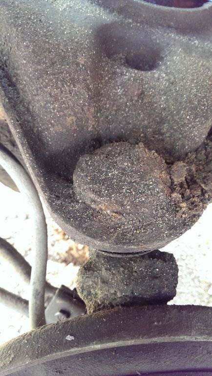

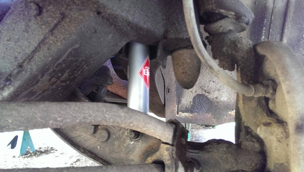

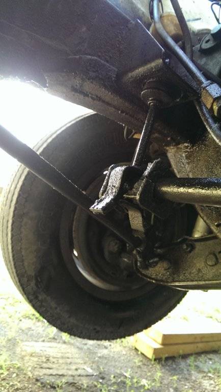

So I then went on to redoing the front suspension.
The neighbors gotta love the view, my car in a constant state of repair!

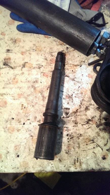

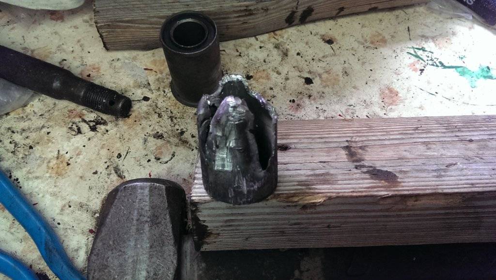

I had to make my own tool to size, using my buddy's A/B/E body tool as a guide, to get my pivot shafts out of the control arm. Thought I'd make it bigger so I had room to spare, I maybe had 1/2" extra, but it worked flawlessly.
The first pivot shaft came out with the bushing on it, grinder did the rest. The other shaft not so much, but I got it out very carefully destroying it!

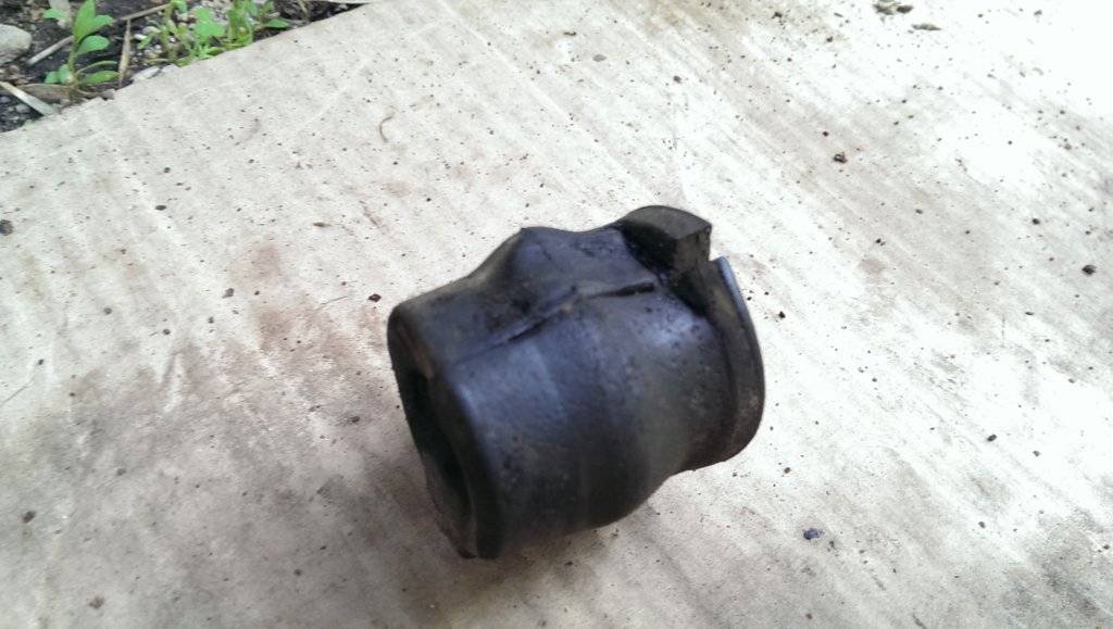

Old sway bar link bushings, one side was floating outside of the link.
All fixed up and ready to go!

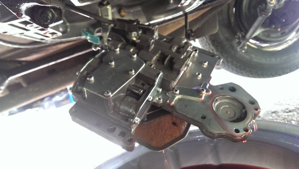

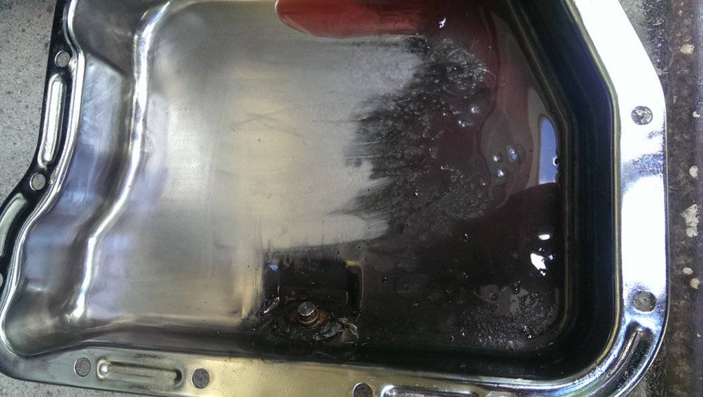

Decided to swap in the forward pattern manual valve body I had laying around for the Dart. Found some crap in the pan when I dropped it.
Forgot to remove the spring, I reinstalled it. Damn did it shift HARD! went home, read the instructions in my B&M kit, "oh yeah, that makes sense". Took it out and slapped it back together. Shifts firm but not as obscenely as before, it was violent!

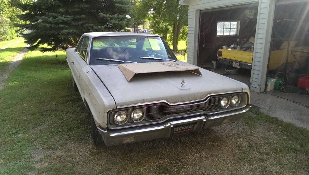

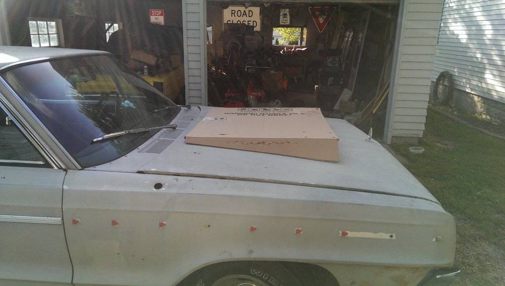

Crudely mocking up what a tall 66 RO/WO scoop would look like, if I ever need it for some tall intake.

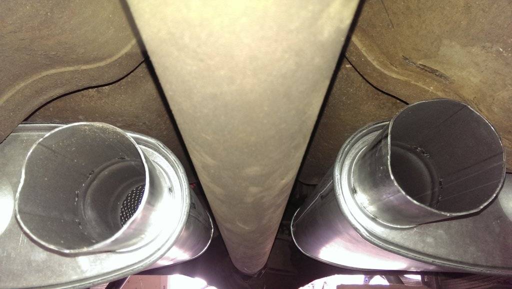

The following spring in 2015, I had had enough of my POS cobbled together exhaust system and ordered a full 3' tti exhaust kit with their ceramic coated C Body headers. I intentionally cut my old system so I knew nobody would ever suffer that misery.
Had to cut the old trailer hitch off, bummer.
I like the kit, but wish they could have shipped it better. It came in one box and the majority of the pipes had a dent at the slip connector.
Almost there.

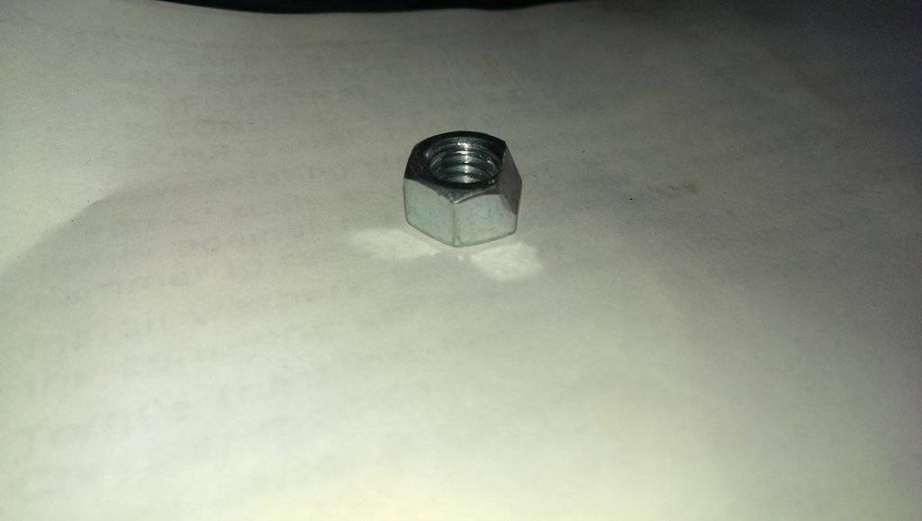

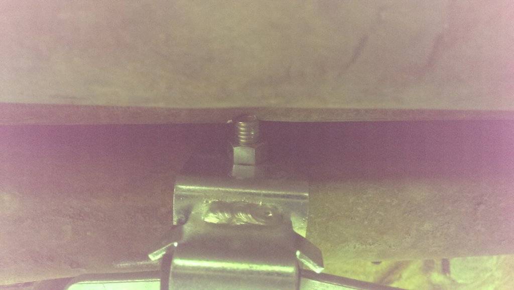

Had to shave some material off a nut to get it to fit. I tried to make it work, but it didn't. Also had to drill trough my rear frame rails to mount the bracket. Whatever they sent me was not up to the task. Even had to notch the gas tank flange so the bolt would fit. Minor pitfalls for a universal kit.
Everything looks good up here.

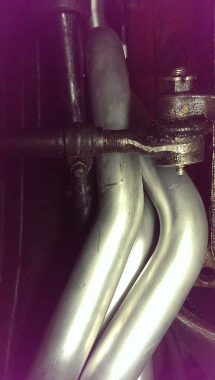

But alas, the idler arm and center section are rubbing. Ugh. Got some shims from Schumacher Creative Services and solved the problem. Sucks to scrape a new set of headers before they've even been used once, but I got over it quickly.
After that I slapped the tail pipe on and went driving! I love it, no more exhaust flowing through the car, the sound is out the back of the car, and I can hear someone next to me.

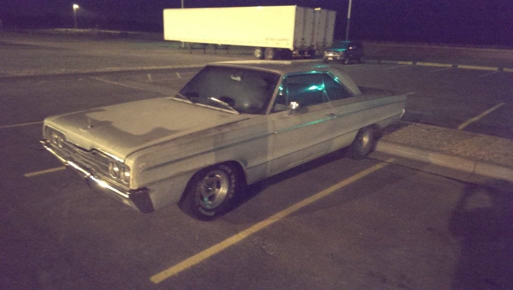

Showing off at a mixed make car show.

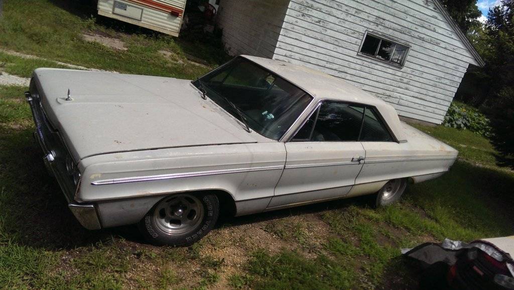

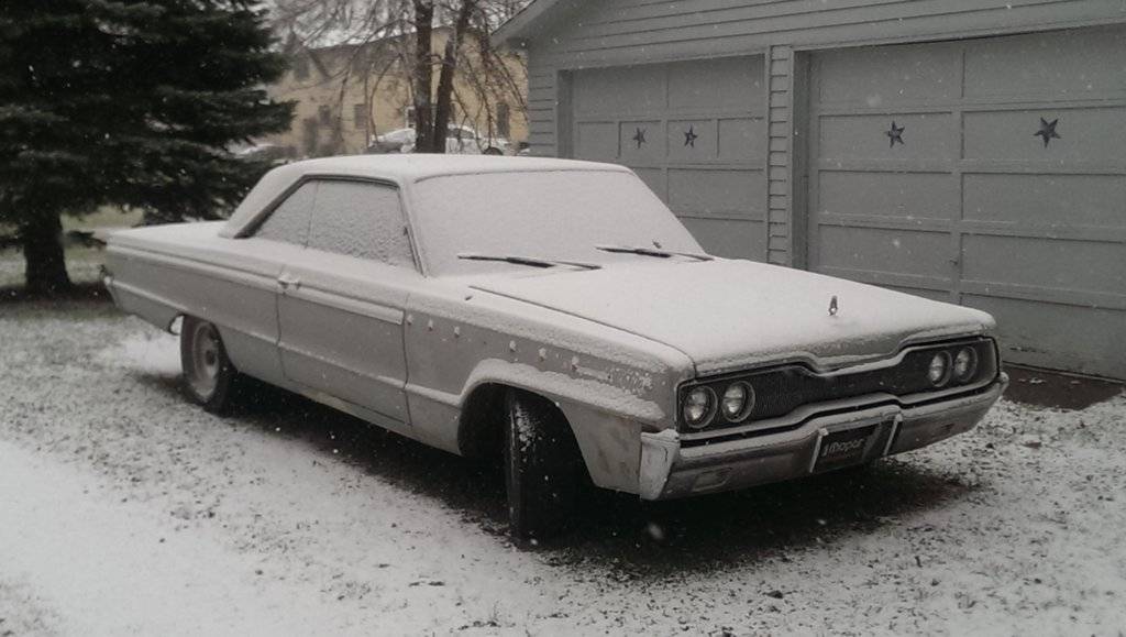

I got back from hunting one year to a dusting on the car, time to go inside.
Out the next spring getting ready for the season.

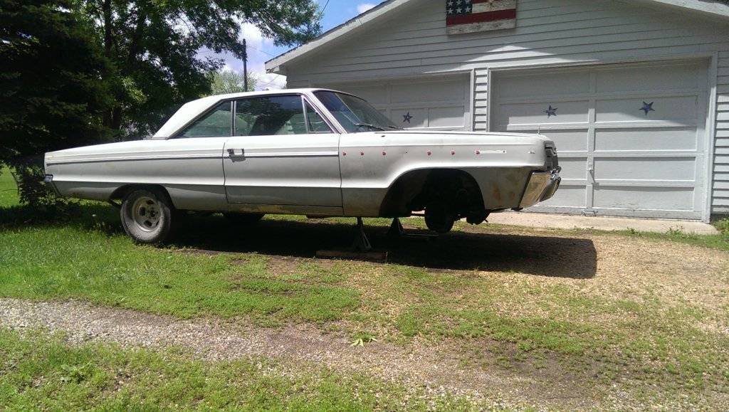

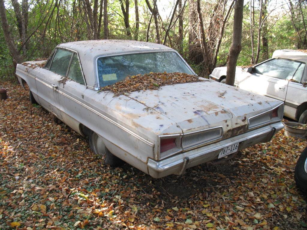

Then I got my parts car from Omaha.
Project Sidetrack 2

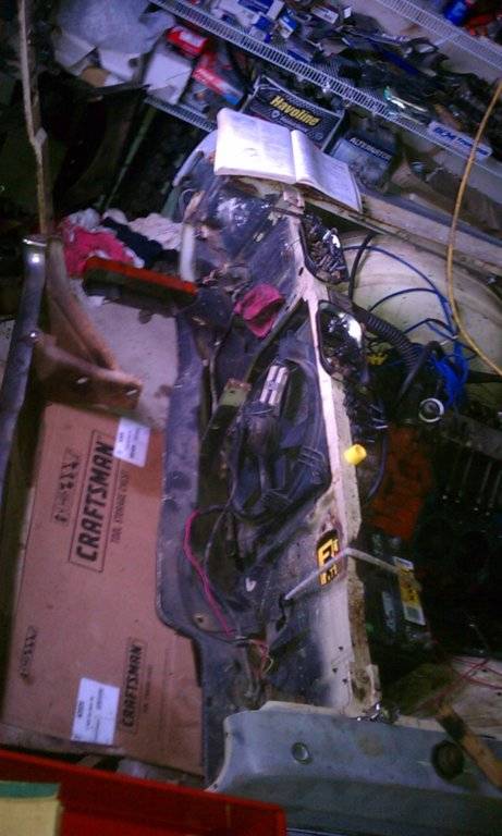

Summary, I was going to use the front stub frame, fenders, hood and whatever better parts it had, along with the correct front bench for the car, finally. Then I looked inside and saw the whole interior was pretty nice, so out it came and I have everything but the dash and headliner installed, even the seat belts. Aside from a small patch on one fender, everything I took looks good. I even sold and gave away some parts to members here, yeah, I'm a recycler.

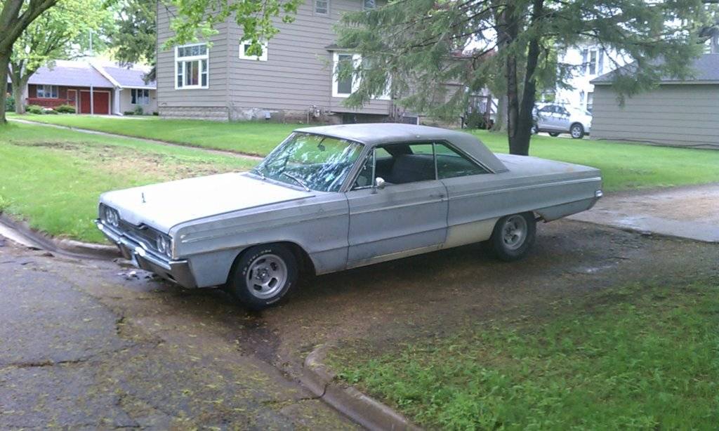

The car was off the road for about a month, back together the day of an informal car get together, fittingly. A month later back to the all makes show, that was a very nice day and I took an extended cruise home.
