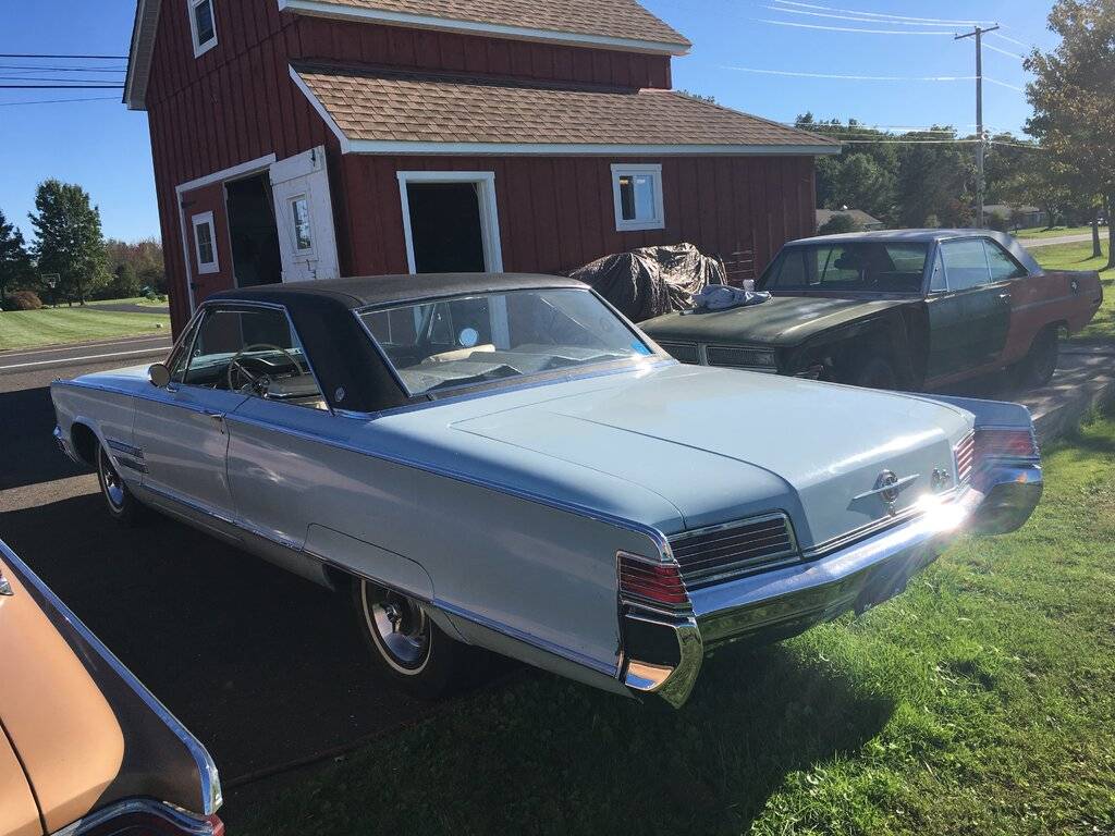

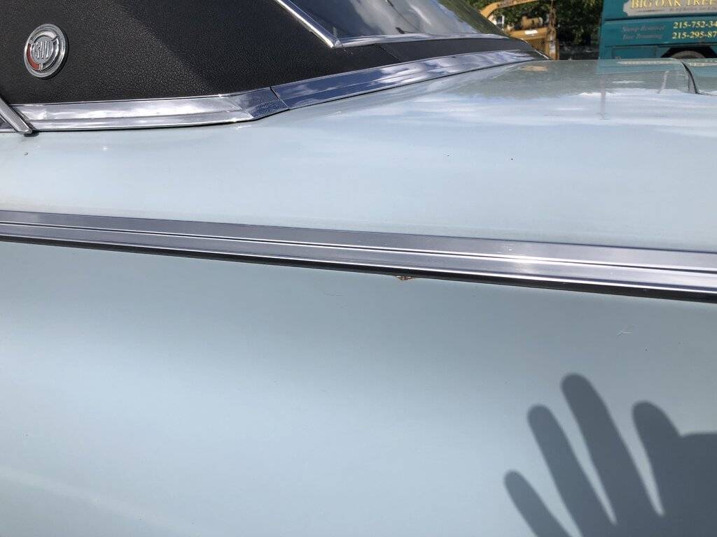

Hello.
So, I’m finally making the choice to restore my mostly original car. I love the car, and while I could hunt down an example in better shape, I doubt I’ll find an ordered hardtop in more desirable colors (for me at least.)
But, while I’ve priced out a new top, interior, suspension upgrades, motor freshen up, AND I just bought a parts car with all of the needed parts to replace what needs (back light box for the center console, front right fender and trim work, AND an A/C dash to add in Vintage Air during the resto...) I could speculate all across the board what it will take to get the metal work done right, and a decent application of correct single stage CC-1 PPG Powder Blue and clear on the car.
I am NOT going for a 1000 point car.
Done right to factory spec is fine with me.
I drive my cars, I’m fine with middle of the road decent.
I guess my questions are, what you guys think about the metal needs/ cost to do it.
And ballparks on paint.
Would you attack paint yourself? If you have, what do you think about what I have here?
I did look through a couple pages of this particular forum, and I’m sure somewhere there is relative threads, PLEASE link me to them.
I appreciate you all in a way I can’t tell you.
I'm no child anymore, but around here I shut up and let the adults talk.
Thanks for your time.

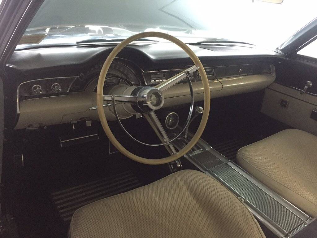

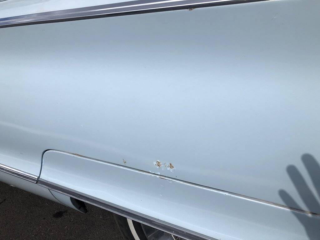

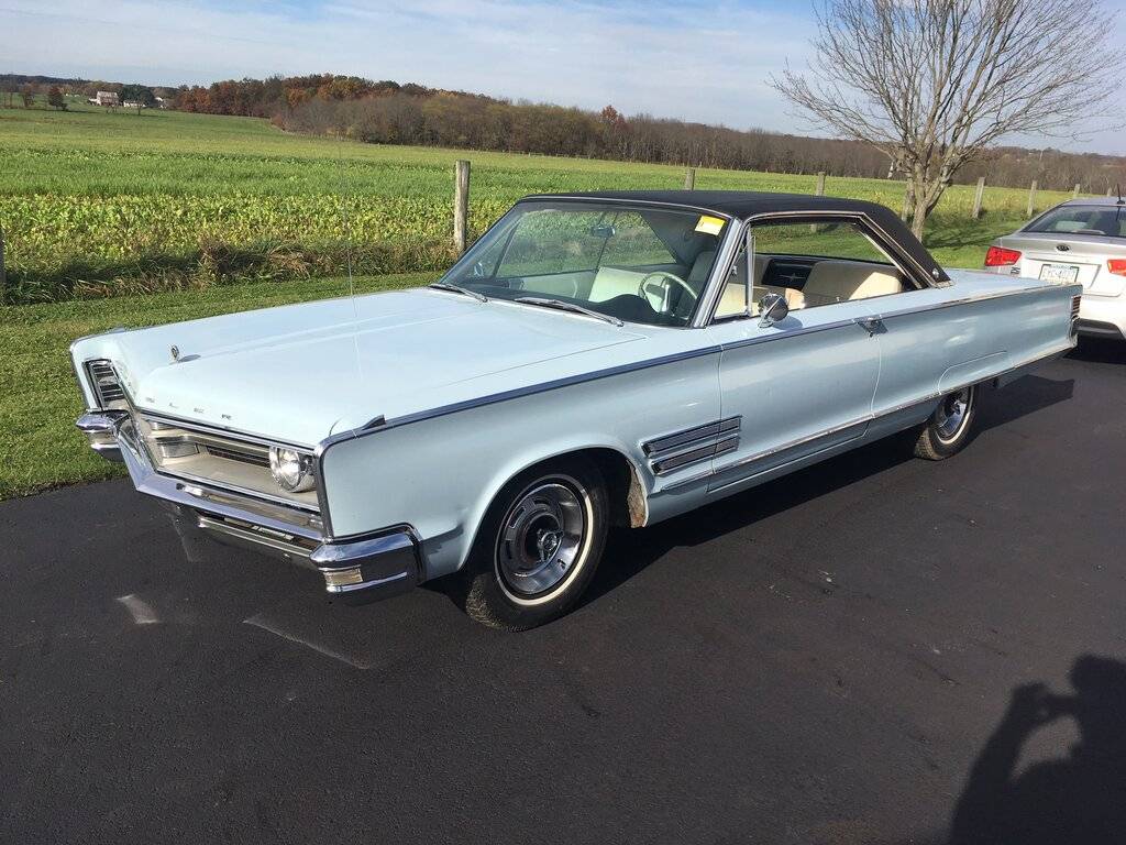

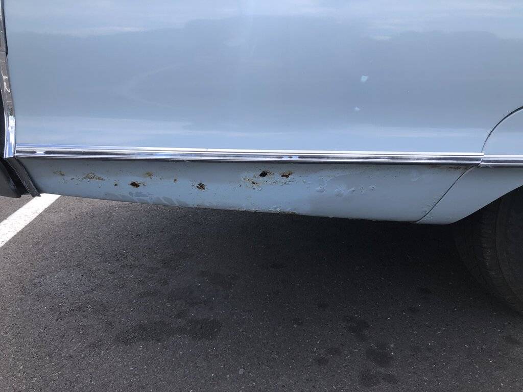

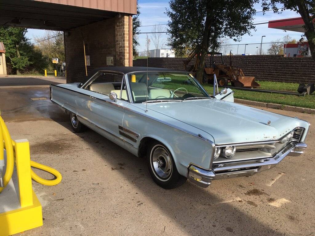

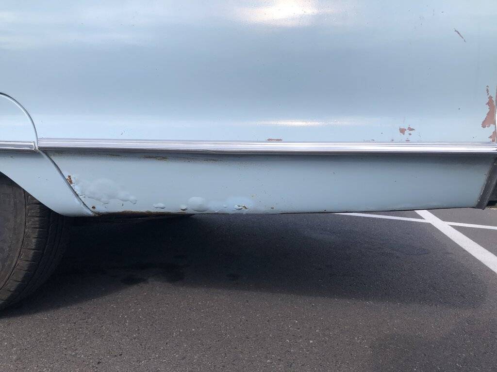

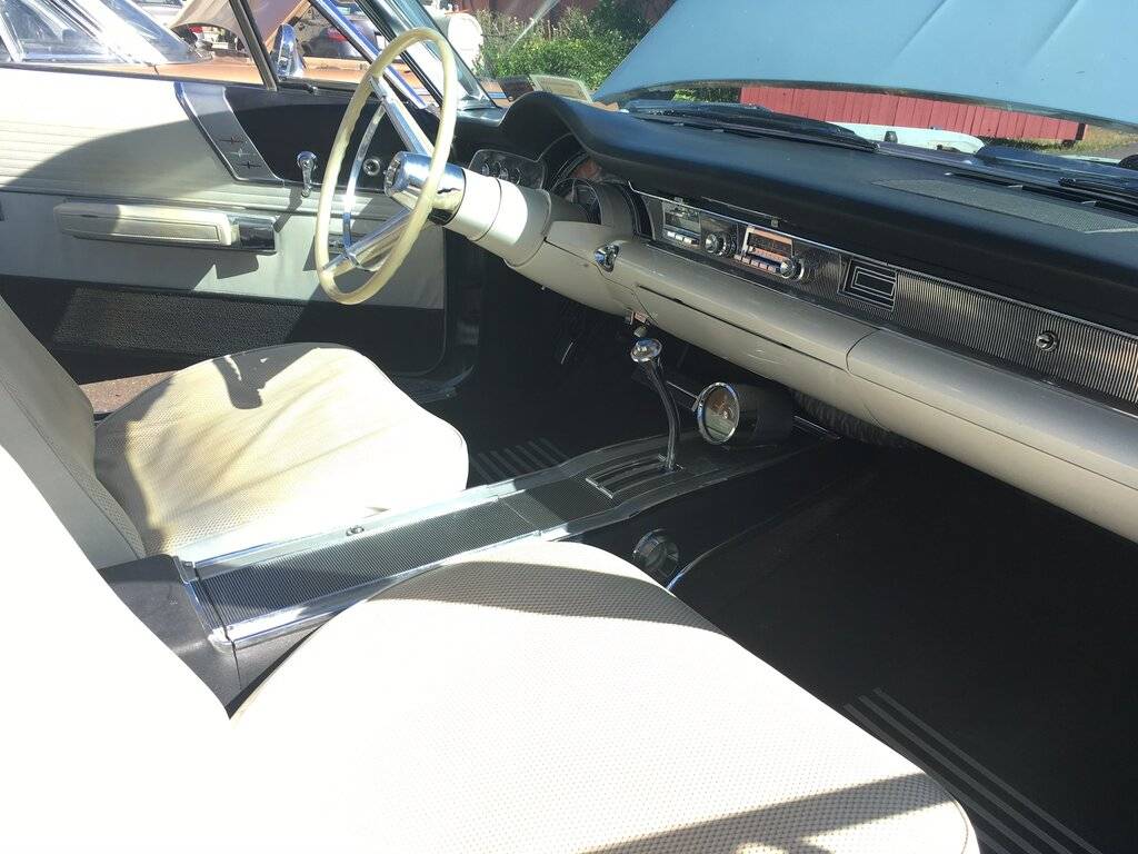

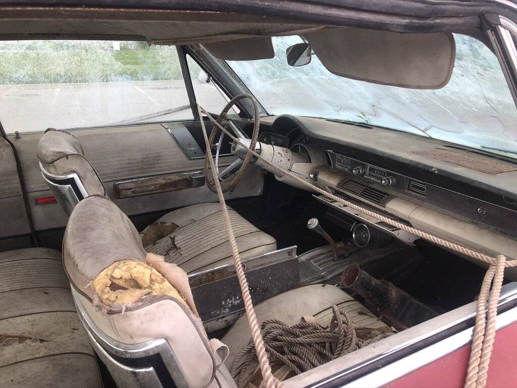

What a beauty! I also have a 66 300 ...have a love for them. That color is da-bomb! Thanks for all the photos, rust doesn’t look bad at all. Do you have any good pics of the interior and dash you could show us?

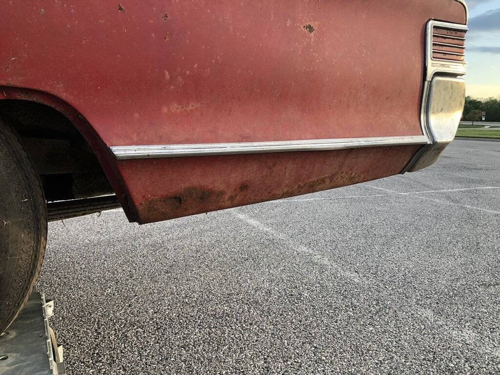

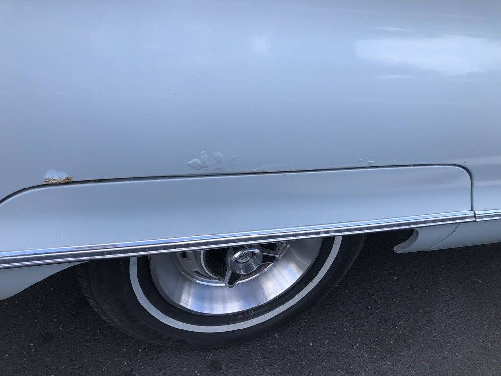

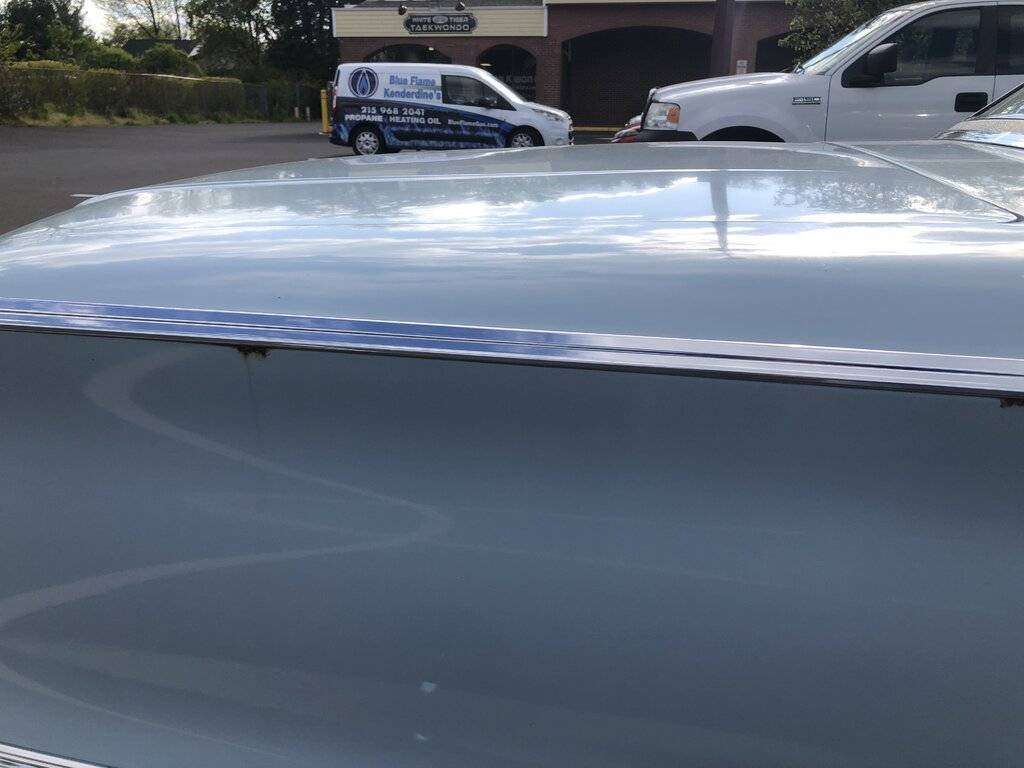

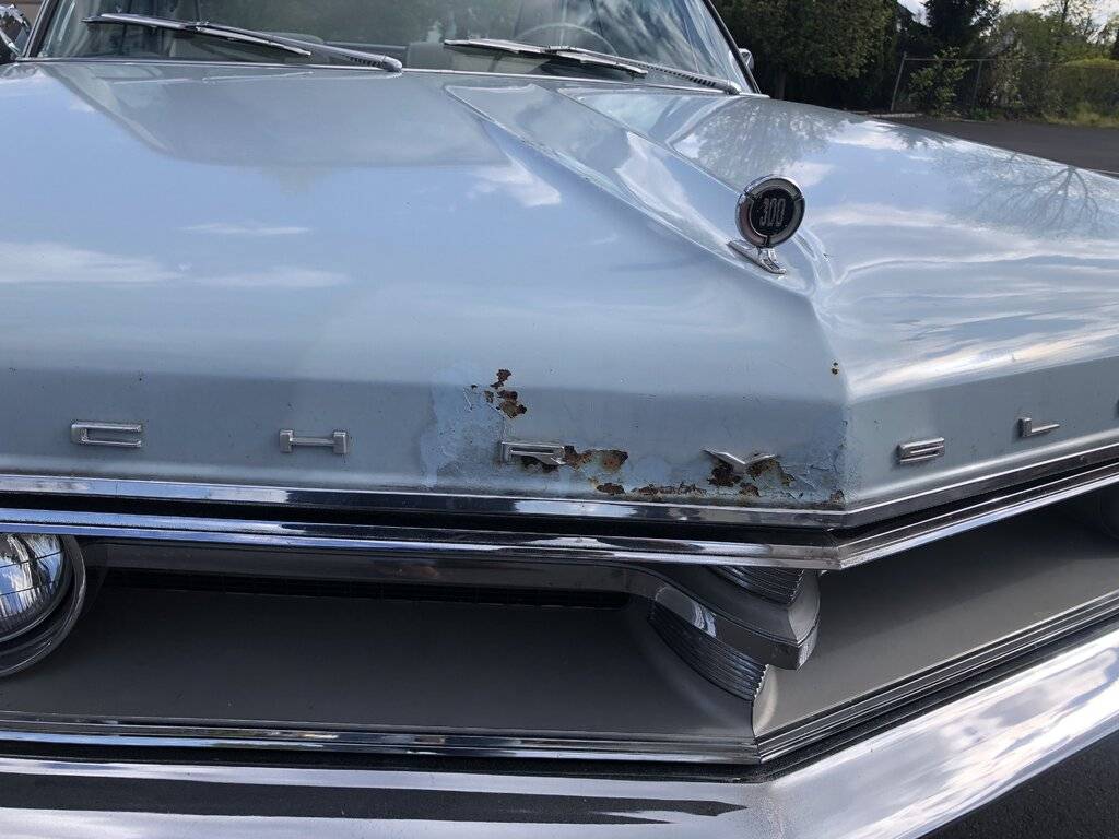

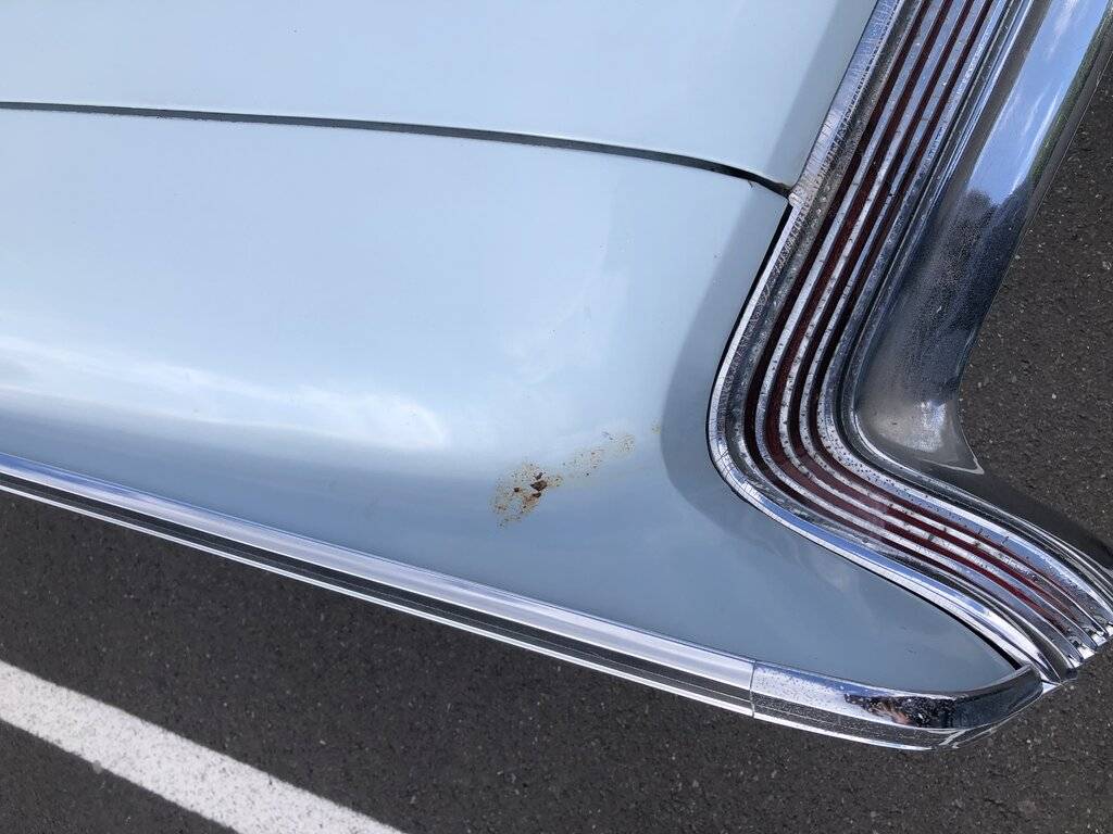

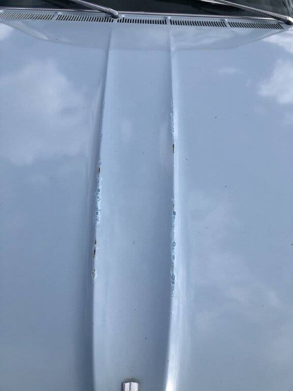

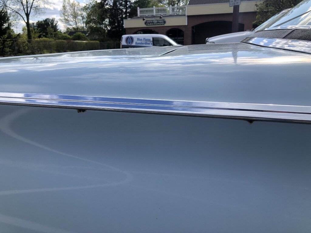

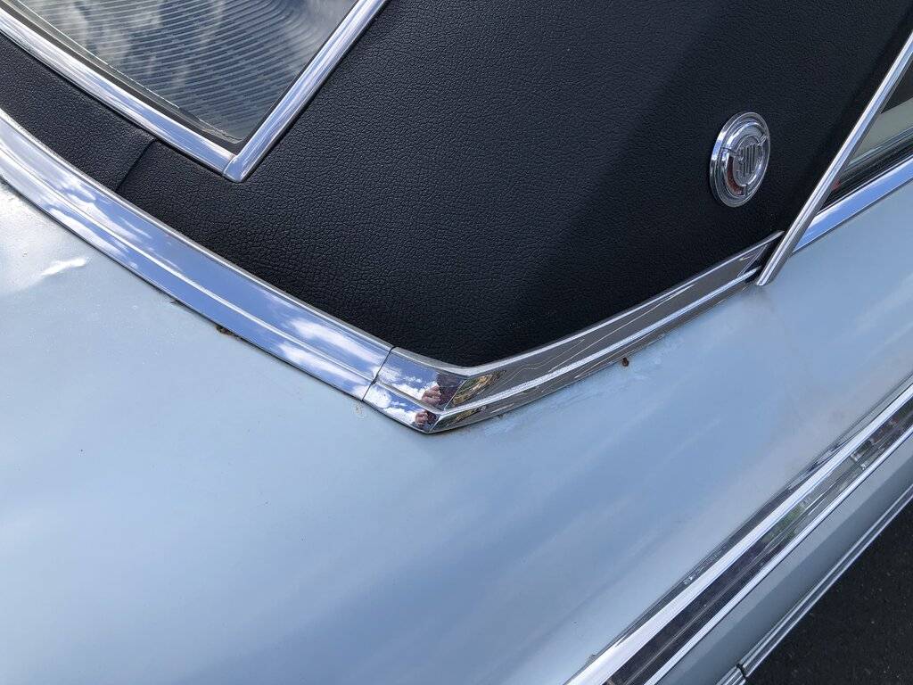

I love this color combination. I am not trashing your car here, but this would be my honest evaluation. The lower part of of both rear quarters below the trim line will need to be cut out and spliced with fresh rust free metal from a donor car. They appear to have been previously patched with bondo. The rust on the upper trim line appears to be superficial and can probably be cleaned up and resealed after the trim is removed. The trim on the back window may or may not have rust perforation hiding under there. Front fender rust and hood rust is superficial. Passenger rear wheel well also appears to have rust creeping out of bondo, the arch will need to be cut out and replaced with clean metal. What sort of shape is your trunk floor in? A lot of cars with lower quarter rust also have rusty trunk floors. It would also be a good idea to inspect the stub frame and rear frame rails before committing to a lot of body work. You will be into some significant expense to do the rust cut out and splicing at a body shop, probably something approaching $3k, possibly more. If you are good with shop tools and a wire feed welder, these are repairs you can do yourself for a lot less money. A quality repaint once the body has been cleaned up will run another $4-$5k. I do not think trying to paint the car yourself is a good idea. Paint components are highly toxic and you can kill yourself from inhaling paint fumes. The isocyanates in paint products are known carcinogens as are some of the metallic pigments. You need a full body paint suit and a fresh air respirator to do automotive paint work.
Dave
Dave
THANK YOU this is the type of answer I'm looking for!

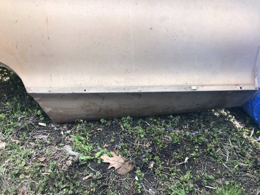

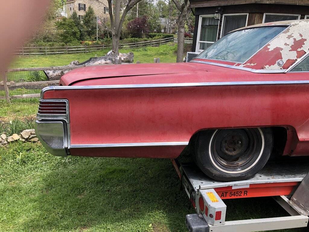

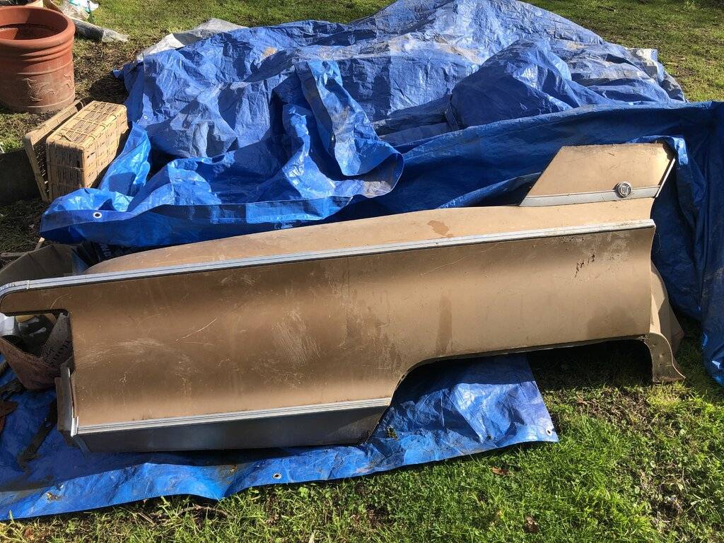

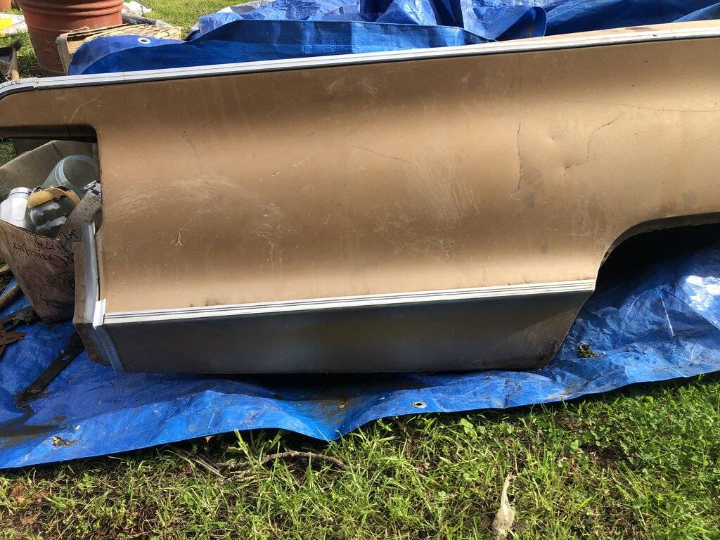

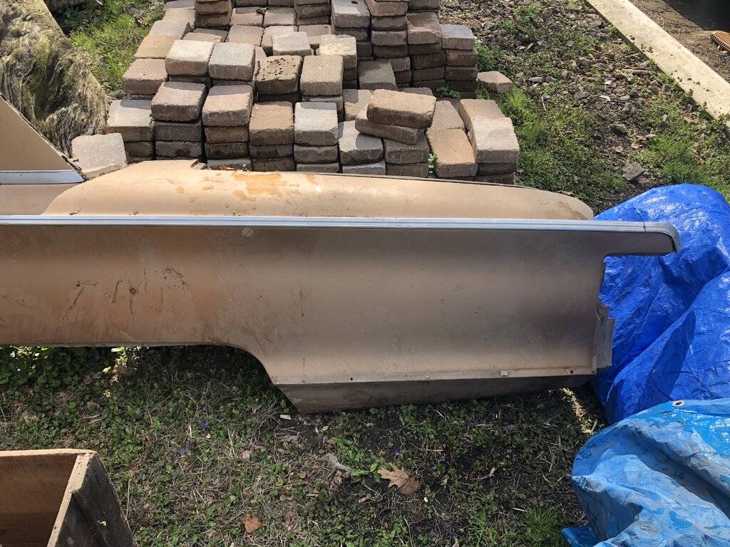

So, i posted a couple extra pictures above, I have several donor quarters available, (I've been hording a bit), I kept these because I hoped that having the pieces available would bring the fabrication cost way down?
I can't weld. I have zero experience with metal work.
But $4-5k for paint is music to my ears. (I've been sweating hearing about $10k paint jobs that simply sound like I'm asking for concourse level work for a car I drive.)

You can spend $10k for paint at a first line restoration shop, that will be for a factory perfect paint job. For a daily driver, a good exterior repaint will usually suffice and you can get that done for a lot less money. The important thing will be to remove all the accumulated rust. Having patch panels will bring the cost of the splicing down some, but body shops are a time driven enterprise, and their time is money, usually $100-$150 per hour. The bulk of the cost is always labor.

It's good that you have a set of good replacement rear quarters but they're off a 4-door so they are about a foot short of the door on your 2-door. That's not a big deal if you're just replacing the lower quarter behind the wheel. I was in the same situation and one of my rear quarters was a mess. One shop I talked to wanted me to source a rear quarter from a 2-door, but the shop I wound-up at was able to graft the 4-door rear quarter in and it came out perfect.

That is a beautiful car as it sits. I'm sure my opinion will be in the minority but I would not restore that car, keep it original. Assuming you have no structural rust problems, I would just repair the obvious rust bubbles and do very selective painting of a few areas, matching the existing color. You can easily have a very nice looking car that remains driveable and you will not spend the fortune that restoration will cost.
