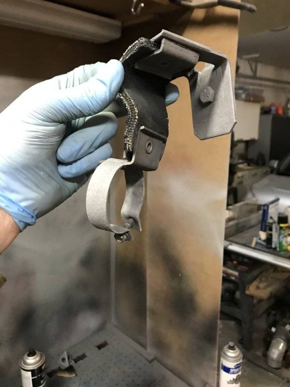

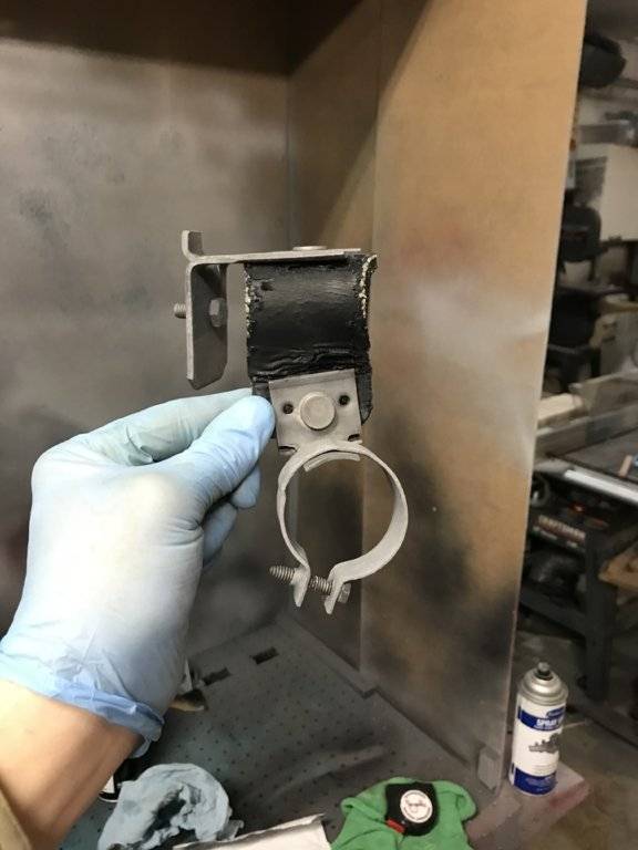

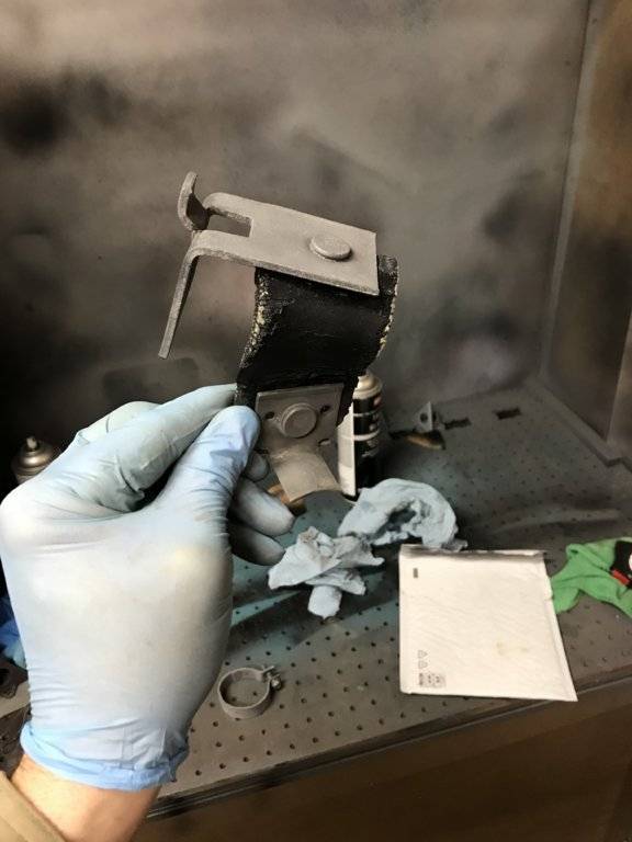

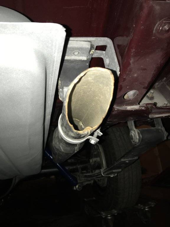

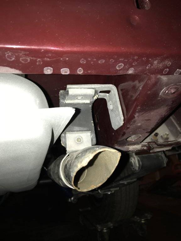

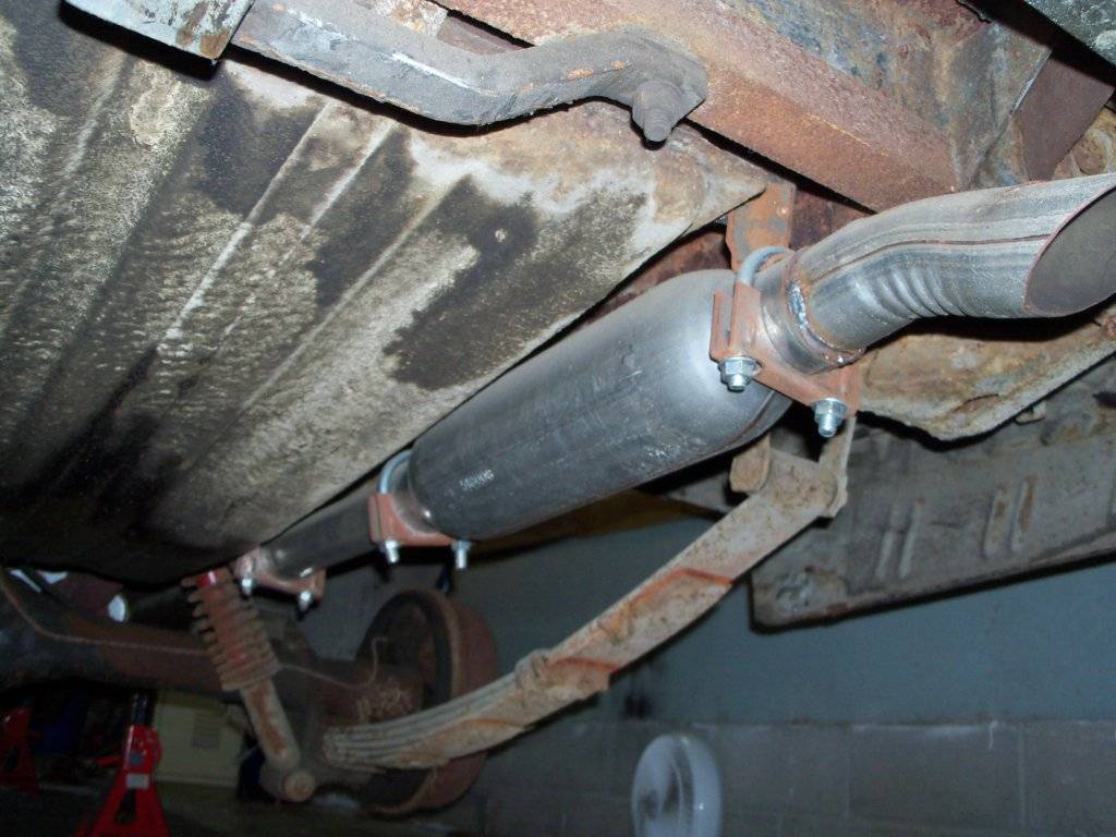

Alright here are my after pictures. Thanks Jason.

The 66 300 seedan with 383-4bbl had a resonator on it.
Seems like our '66 Newport had the rear resonator from the factory. So "upscale", I thought at the time. When it got rusty, it got the resonator eliminator pipe. Sounded better to me, plus nothing to rust out. Plus a bit less expensive.
