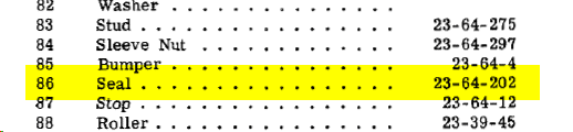

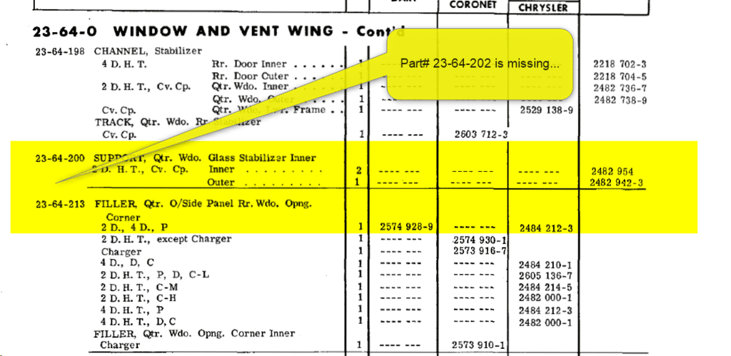

I finally found the part #'s for the rear 1/4 window seals for the slab convertibles on pg 1019/120 on the downloaded parts guide.
The basic part# is 23-64-202 & when I go to the details on pg# 1207 it is missing from the parts break down for left & right sides
Does anyone have a good usable set or know where I can buy repop's?

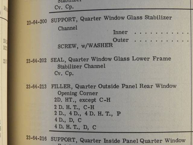

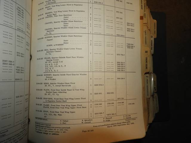

2573777 not in part book
23-64-202 ditto
my book dated March 1967
1965 part book has that code and 2573776-7 as the R/L parts for the C body converts
so the lamebrains forgot to put this section in the part book!!!!!!!

I had a look at mine as well and saw the same thing. It's like they never intended to offer this as a replacement part.
I was wondering if it was integrated with the rear window channel guide but no evidence of this either.
