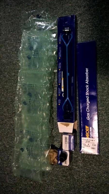

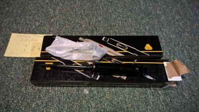

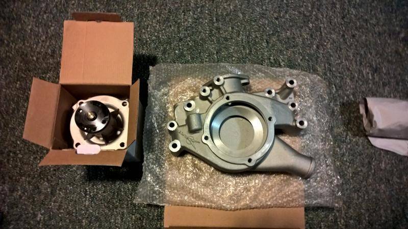

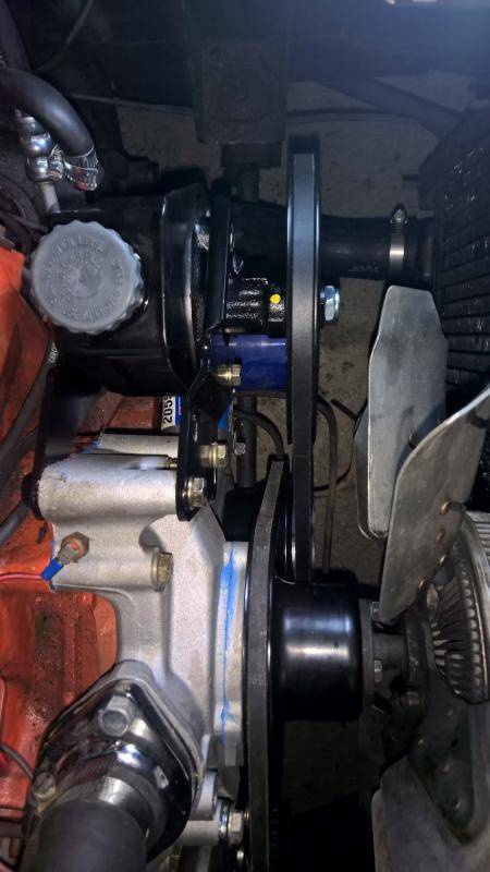

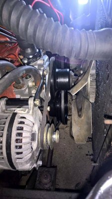

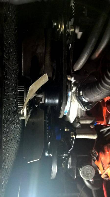

Figured you guys would like to see some progress as it has been a while since I last posted. Last night, took her for the shakedown drive after finishing the front end and redoing the front end of the engine. Pics are a bit blurry due t taking them last night but it drove beautifully, albeit I need to bleed the brakes again as the brake pedal is a bit spongy. Not picture is the new PS pump, brackets, or pulley.

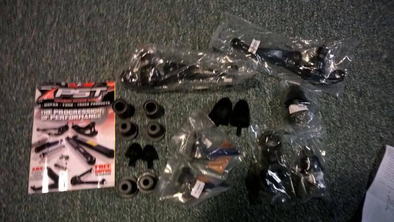

Hello, I just picked up a 67 Sport Fury and am in need of a front end rebuild kit. I saw one on layson's for $629. I saw the pic of your kit for your 66. Could you tell me where you got it and how much you paid?
PST they are like 230$ for a kit but it don't come with idler and pitman arm.

brake stall it and see how close it gets. the brakes will be a little spongy till the brake shoes seat in. will take a couple of stops and letting it set till they cool off. this is why i don't put a clutch fan on mine. it's a little to close for my liking.

The reward for being right in this case would be a messy and costly one. Just find a shorter spacer and be done.

There isnt a spacer on his car. It just has the fan hub bolted to the water pump.

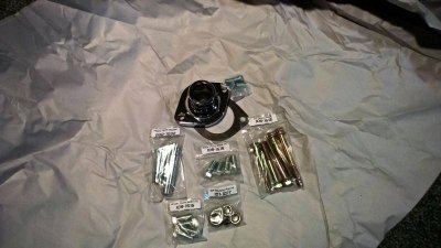

Did you get the billet thermostat housing that 440source sells? I want to pick one up. My cast chrome one is started to leak.
Do you have a fan shroud?
I got the chrome housing and i need to replace the rubber gasket it came with with a paper one. Cant get it to seal correctly when running her a bit. I have no shroud.
