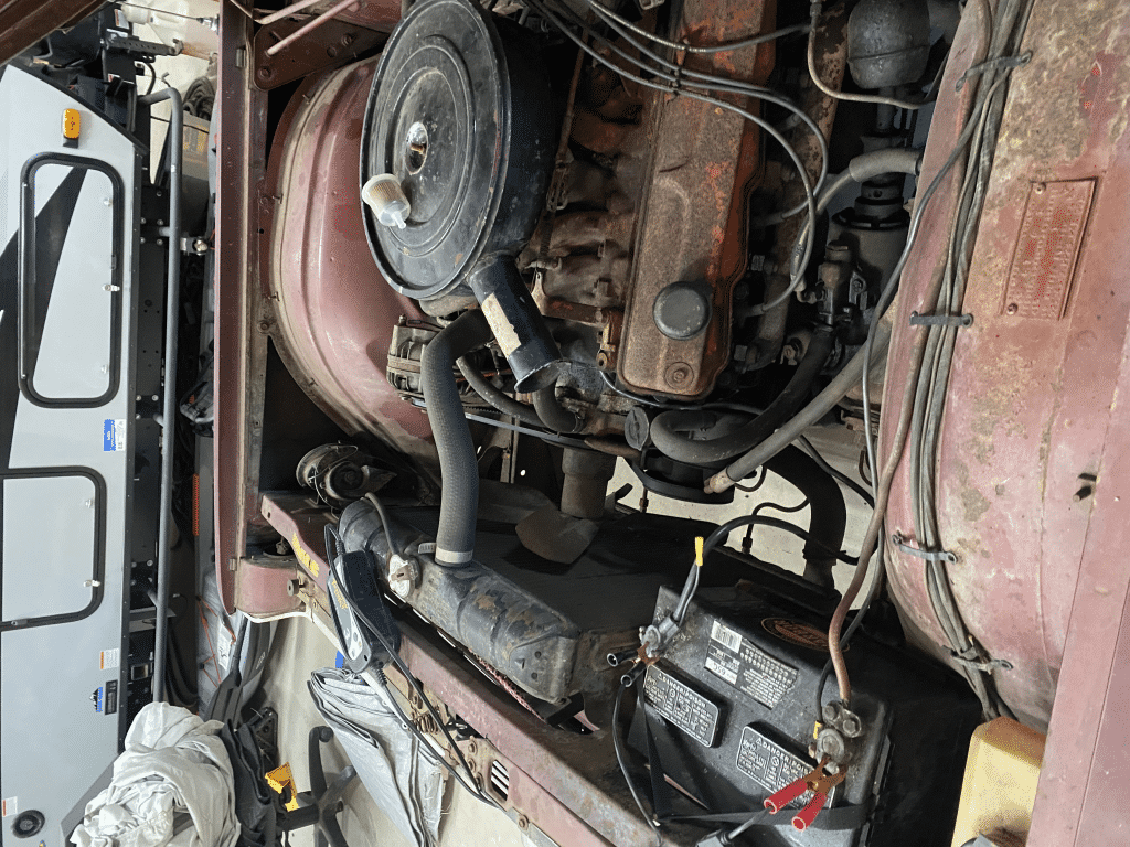

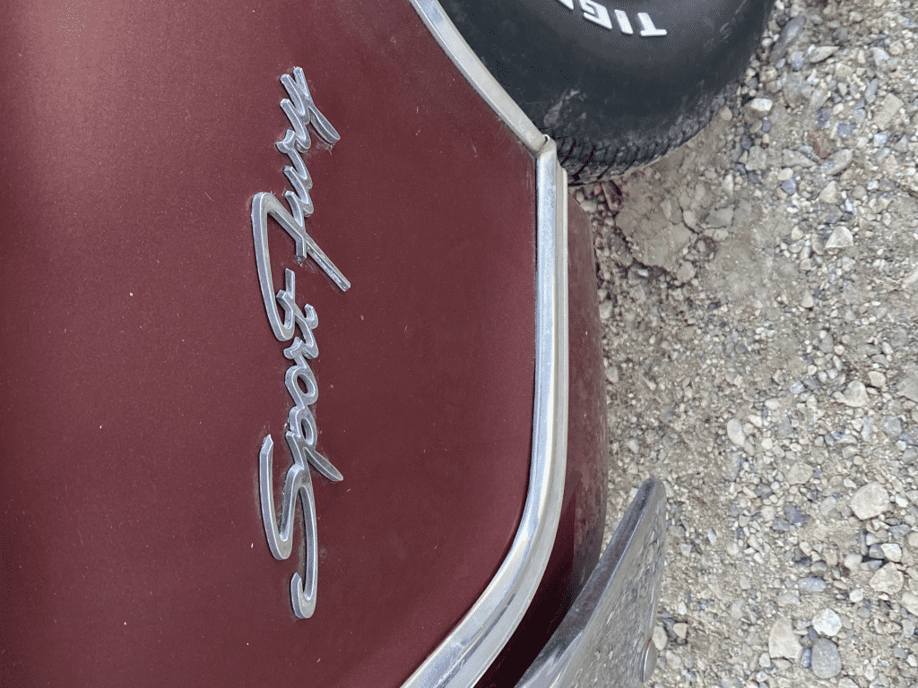

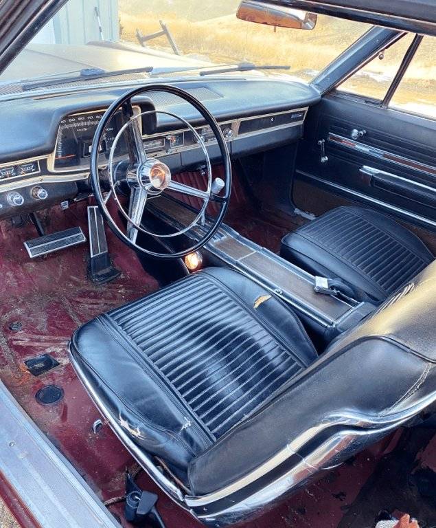

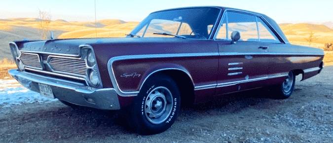

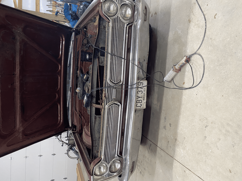

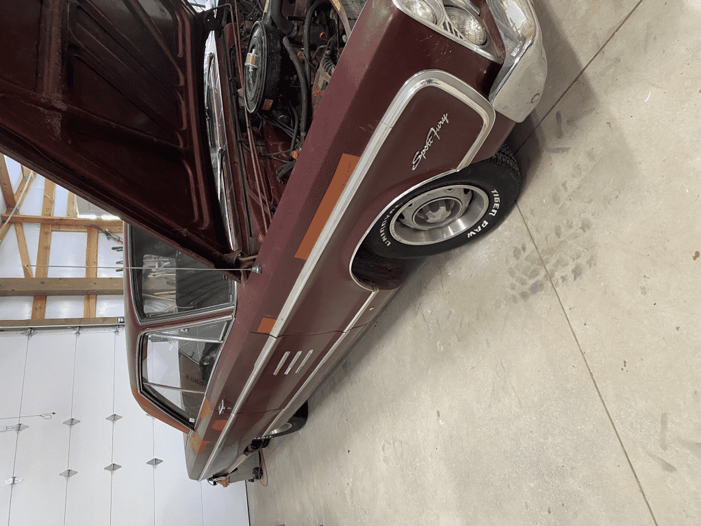

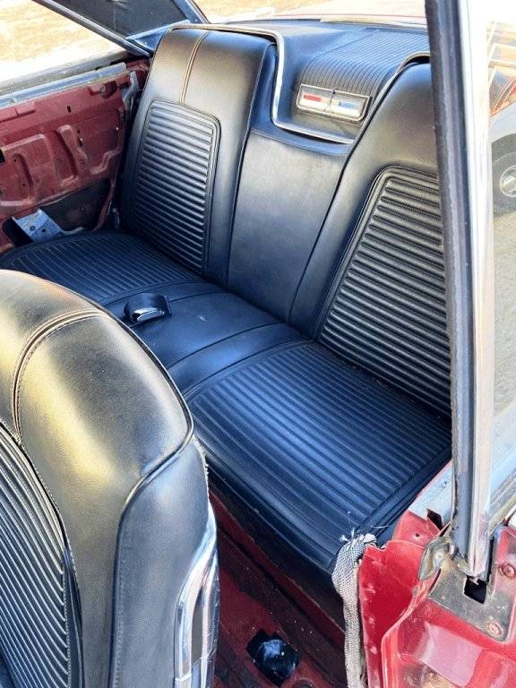

Hello my name is Ian. I am new to this forum. I purchased a 66 Sport Fury about 2 months ago and I am looking to join the club here and ask for feedback as I start my journey into restoring this car. I have included some pics to give you a general feel for the car. Under the hood is a 318 that runs ok? Power steering and automatic transmission. It runs and drives, and stops sort of. Not really too much cancer at least from my initial inspections. I am totally new to car restoration. I am not new to working on cars however not to this degree. My plans for the car are to work on the suspension and brakes. I found some disc brakes from a C body that I purchased to convert my fronts over to. Then I would like to pull the interior and clean up the body for paint and lastly build an engine. I am thinking 408 stroker. I will need a great deal of advice from all on this site and yes I expect to get balls broken for asking stupid questions. I live in Emmett Idaho and it looks like there are no Mopar Clubs in Boise so you guys will be my resource.
One big question I have is building a 360 stroker to a 408. I can find engines and I understand working with a machine shop however I have never rebuilt a motor. I do have mechanical aptitude and I can follow a process but not sure if its just better to have someone else with years of experience do it or have the satisfaction of doing it myself.
Looking forward to the feedback.

If you are not keeping the original 318 then I would go with a big block. Those cars came with them so it would be an easy swap.
I'd be in this school of thought, also. Hard to beat a 383 for all-around "balance". Appears you don't have A/C which keeps it a bit simpler. On the other hand, you'd need a different transmission and driveshaft - possibly a radiator too.

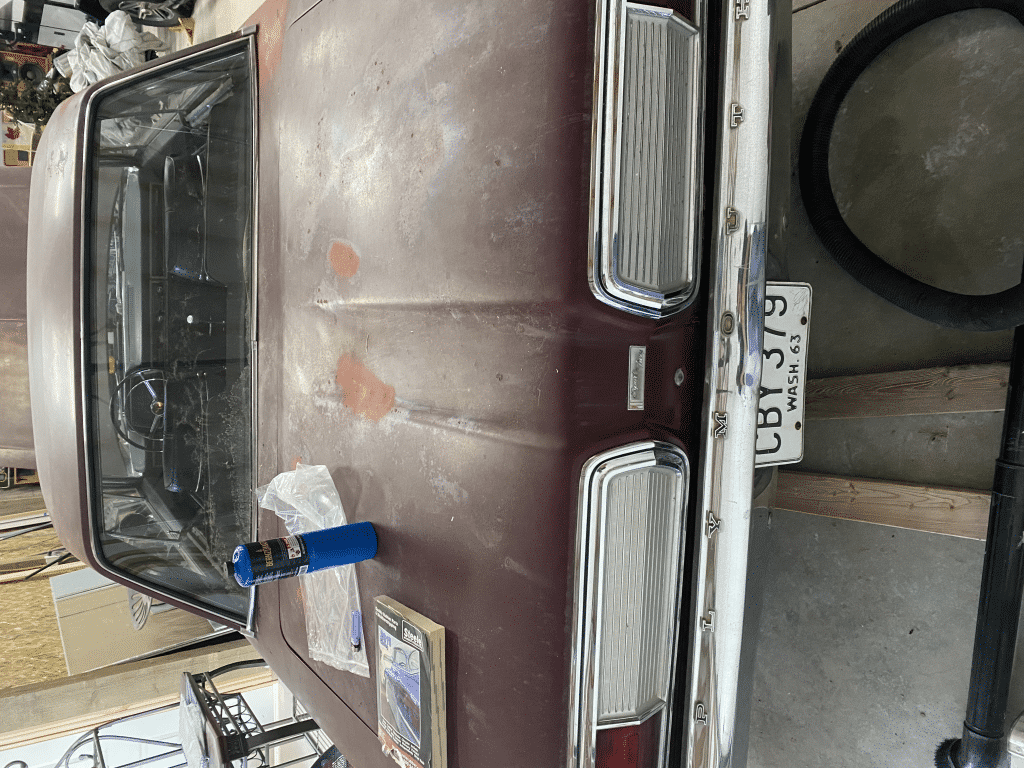

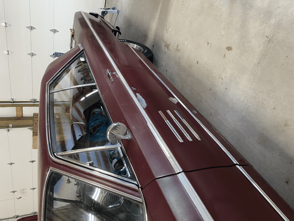

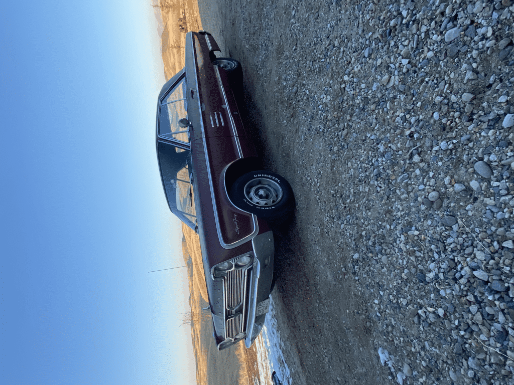

I turned your pics and tweaked on them a little. Your car looks outwardly solid:)

Thanks for the feedback and for adjusting the pics. I have thought about a 440 as well but your point of a different trans, drive shaft, radiator are all factors. A new rad will be a good idea no matter what, my trans will have to be rebuilt anyway so it may be a better route. Not sure of what is involved short of motor mounts, trans and driveshaft? From a cost perspective I don’t see a big difference considering everything on the motor is tired and I would not reuse. More pics soon. Thanks for the info

Welcome! Nice car!
Your car looks solid from what the pictures show. I have a 65 and love it.

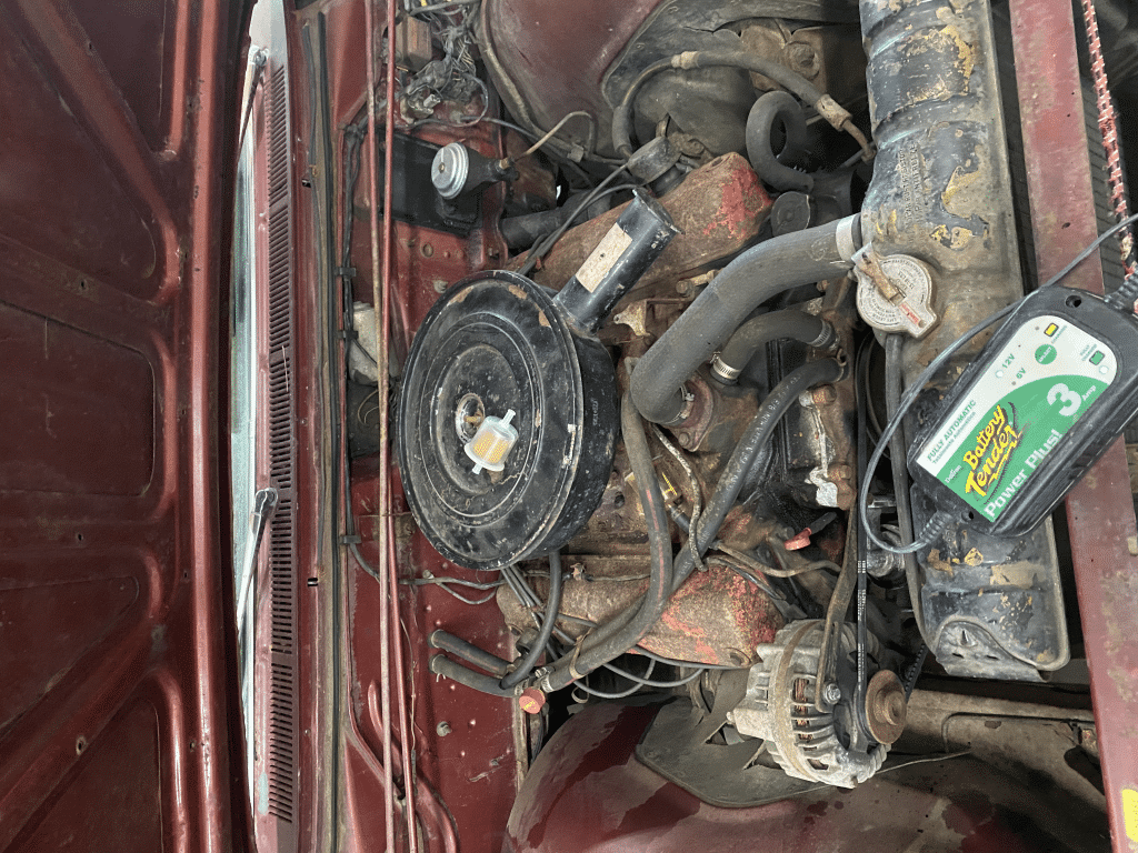

I was just thinking, this thing has a poly 318 correct? You say it runs ok. If it has good oil pressure and it’s not burning oil, I’d lash the valves, rebuild the stock carb, replace the plugs,wires,cap/rotor, and points. Give it a good tune and see how you like it. Those polys run really smooth and have good power when they’re tuned right. Also, an open air filter and a straight thru muffler make a big difference on a single exhaust 2 barrel engine.

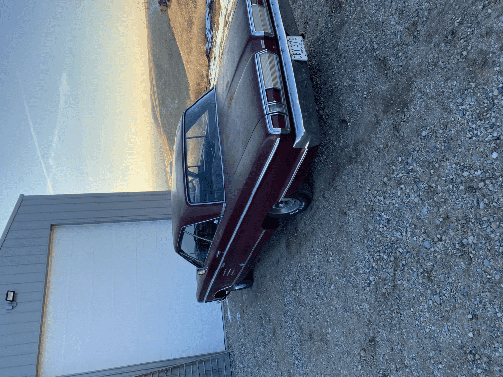

Wow what a great response from all of you. I have added a few more images of the car. Sorry I am having some trouble rotating the images. Great feedback from all of you. I think I am set on the 360 Stroker motor for a few reasons. As mentioned I dont need to change as many things to make it work. For me I want something that will perform, will be somewhat unique to an already unique car and with a rumble that will make the car special. No I dont plan on being at the strip every weekend, and no this will not be a daily driver however I want to have something that reflects what I want the car to be when I am done. It wont be a show car. I dont want to make it a 100% original car however I do plan on changing the color to a light blue. I know this involves more work however the current color is just not my cup of tea. I bought the car with an idea of what I wanted it to be and maybe that will change over time and once I start to dig into it however at the moment that is my vision. I want to add larger wheels and tires and make it perform. These cars are under appreciated and that I why I chose this car for a resto mod. We have all seen a million Camaro's and Mustangs but I wanted something unique. I was at a car show not that long ago taking to a guy about his car and mentioned what I was going to do and he had never even heard of a Sport Fury. I punched him in the nose and kicked him in the teeth but he was a chevy guy so I was not expecting much anyway. Ha. I have recently retired and looking for an excuse to be in the shop, versus telling my wife I am working in the shop however just drinking beer. Now I have a legitimate reason to be out there, and drink beer. I plan to do as much of the work as I can myself only lookin to maybe have the motor and trans done and the final paint. Other than that its on me. I don't have an unlimited budget however this car will not be a trailer queen and I plan on driving it and feeding it the onions on occasion. I will be leaning on your guys for all of your knowledge and experience and I will do my best to share my progress along the way. I am almost finished with building a craft room for my wife inside my shop so once that is done I will start to work on the suspension and brakes making sure all my systems are solid before removing interior, engine and then addressing the body issues. With such a great response from all of you already I cant wait to see where this leads me. Hopefully not to depression and alcoholism, ok maybe not depression anyway.
On a side note I need the center console and shifter for my car. I have all of the console parts however my shell is busted in the back area and the shifter is some sort of custom, not well thought out piece that is not original to the car and does not work great. If someone has one for sale or knows where to get one that is not made of gold let me know. That is the one draw back to these cars is that there is not much aftermarket love for them. I knew this getting into it and that is why I looked for the best example I could find.
Thanks guys. Looking forward to your continued support.
