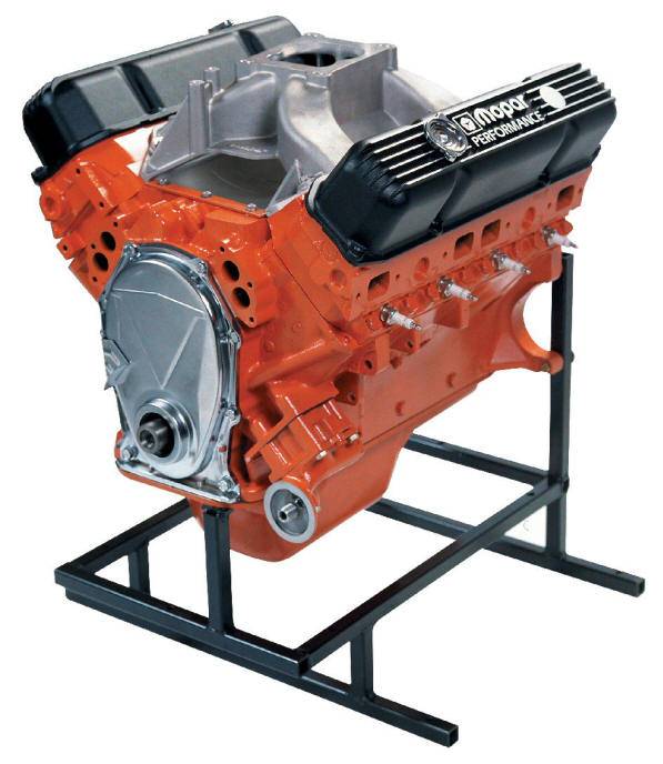

Oh, fer petesakes, go for it:
505 HP 500 Wedge Motor, that's what i am talking about. Isn't she pretty!
Very pretty but I can come up with a dozen reasons why you're better off using a "seasoned" 440 block over an aftermarket block.
