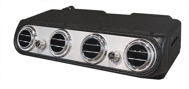

Has anyone used one of these kits? If so is this it or do you need to buy additional parts and how do they perform.
I had one in a car many years ago. That is basically the evaporator. You still need a compressor and a condenser as well as lines and freon.
I'm wondering if I should try to find a compatible factory unit
Putting a factory unit in is going to be a TON of work.
Besides sourcing the parts, you'll need to make changes to the dash and firewall... You ready to pull the dash? Honestly, if I were doing that conversion, I'd look for a parts car... Just sourcing the dash pieces that were missing on my 300 was a PITA. I've got way too much time and $$ in mine... and that was a factory air car that had the A/C removed years ago.
You would be lots of time, frustration, and probably money ahead to get an aftermarket unit. I have no experience with Classic Air so I can't say one way or the other about them. I have read that Vintage Air is really good, again, no personal experience with them.
Sheesh I thought this was a cut and dry upgrade, hell this will be its own project...at the bottom of the to do list. Thanks
